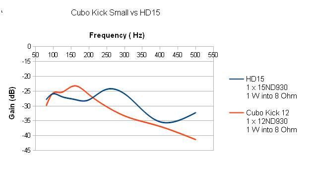

To me "kick" is 80 - 300 Hz, which is also the reason the HD15 is superior below 100 Hz but I didn't measure that.
Back in the design stage I build a HD15 and the low section of a Xtro to compare the Cubo Kicks to. This is the prototype of Cubo Kick 12 prior to the published design (which extends the top end) versus the HD15. Note that the 15ND930 has a very low Qts, whereas the Kappa 15LF (from the original simulation) has a much higher Qts, which is probably responsible for a peak, where you now see a dip in the frequency response.
