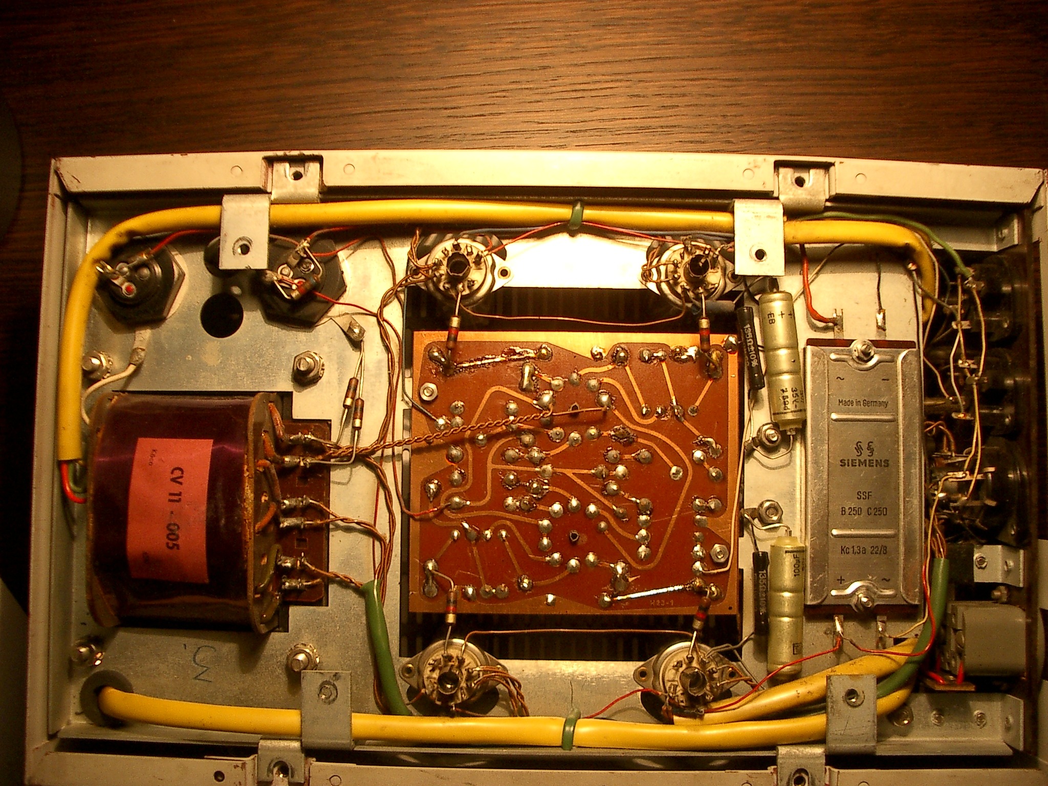

yes, thank you very kindly, dear gorgon53.Frankie, in Germany Reinhöfer Electronic made good transformers with unusual comprehensive documentation (not sure if they are still in buseness but if, better take advantage as long as they still are)
I read of them before. (As of non-existing anymore Welter).
Reinhöfer's current (???, or from 2013): https://www.roehrentechnik.de/html/gegentakt.html
For me the difficulty is: to find the best one, which is but relevantly the best.
It would be nicer, if every company would mention full technical quality data,
which maybe still is partially irrelevant, when only perceived sound quality is of importance.
thank you again. will read a bit.
My model is my mechanically/optically most "sauber" built BRAUN CV11.
(since I never did much testing with diverse loudspeakers, so no experience,
it is difficult to speak competently on sound 'quality' for that one.)
A german recording studio engineer from a top quality studio found it a bit 'näselnd'.
With my LE1s I find it nice, though some crackling either from the LE1 or the CV11 tube sockets, or else ?
thank you, bye.
