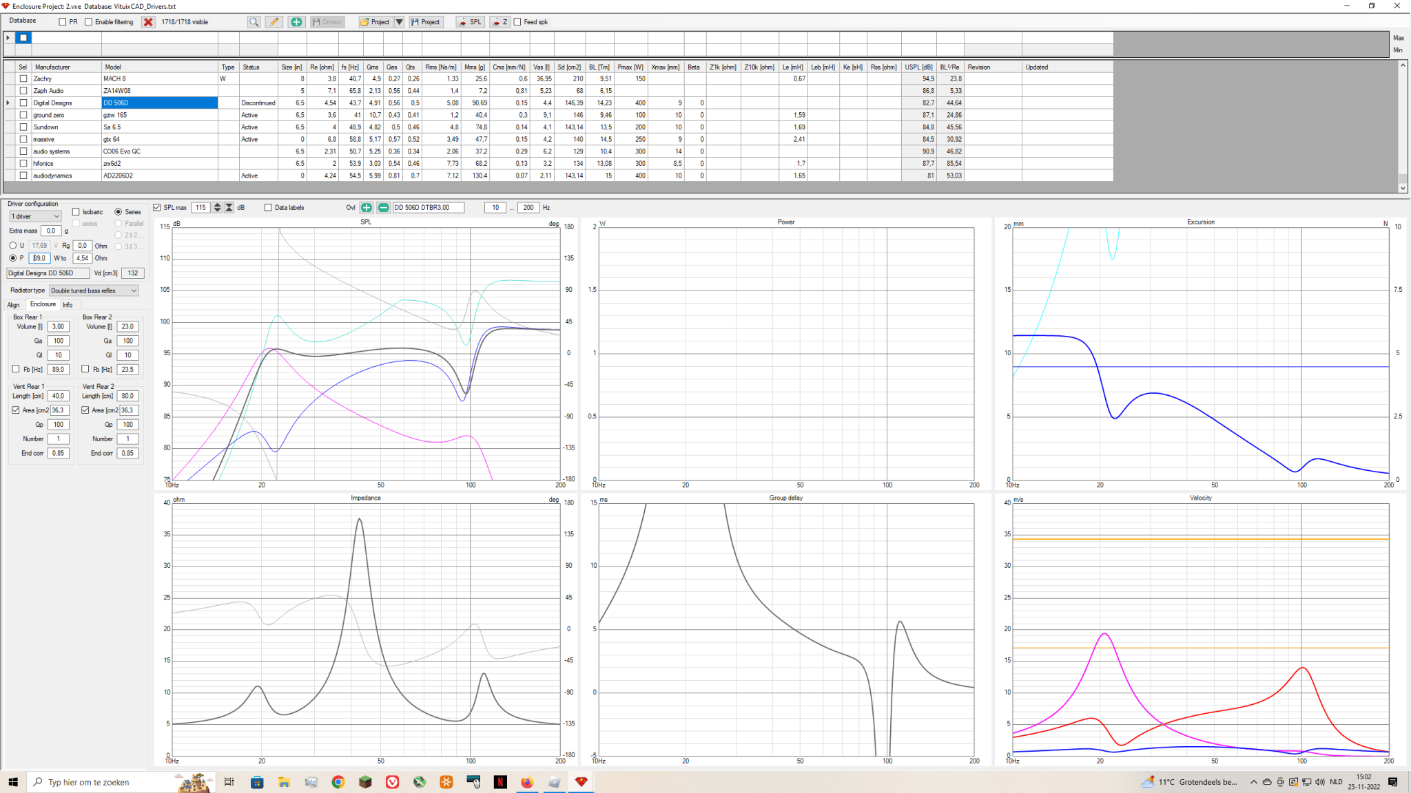

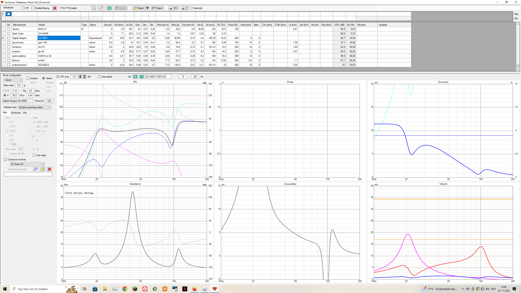

I am planning on building a subwoofer box for my home theater with a digital designs dd506d2
The design will be a double reflex chamber tuned between 20-25hz with one chamber around 5 liters of volume and the other one around 20.
I have a question about what my port diameter should be:
I was thinking about 65mm the port will be 1 meter long this way (which is fine) and the air velocity at 100 watts will hit the 17m/s mark
A the moment i have a 8 inch infinity subwoofer with a port thats 50mm in diameter. This subwoofer has noticeable port noice/chuffing. So I dont know if a 65mm port will be big enough in diameter (the surface area of this 65mm port is almost double of the 50mm port)
Any comments would be highly appreciated

Well, wrote up misc. details with modded Hornresp sim and forgot to factor in the requisite band-pass filters, so will have to redo as time permits since it will make a significant difference re vent design. 🙁
I have read that before. and the program i use (vituixcad) shows 17m/s as turbulence warning and around 30m/s as turbulence limit. But I put the 8cm diameter in the program flare-it it sais that port compression will become a thing under 15m/s17 m/sec is a good upper limit for casual listening.
