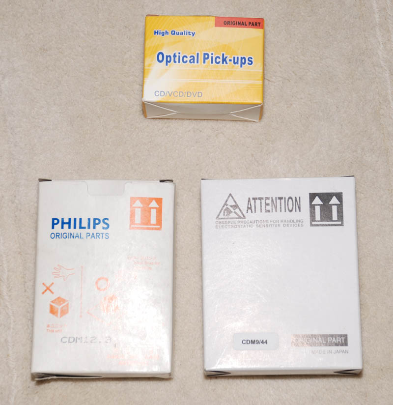

It's probably about distinguishing which offers are original parts and which are cheap not reliable replicas.
Basically this should be the case with all packages of Philips parts - also with the VAM1250 head

P.S.: obviously there are at least two variants of laser hologram diode (Sharp) in use on this laser head - go to the last images. Which of them is most reliable and have long live character ?

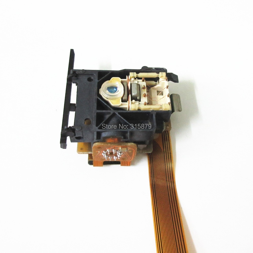

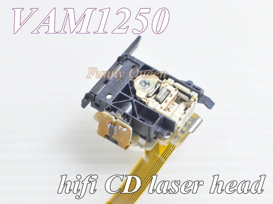

Original-VAM1250-CDM1250-f-r-Philips-CD-Optical-Pickup-Kopf-VAM-1250-VAM-1250.jpg92.4 KB · Views: 168

in post #38 I ask this:
What other features on the laser unit/mechanism (except "Made in") are there that tell you if you have a high quality NOS version or a cheap copy?
https://www.diyaudio.com/community/...4-cdm12-4-compatib.148414/page-2#post-7326109
