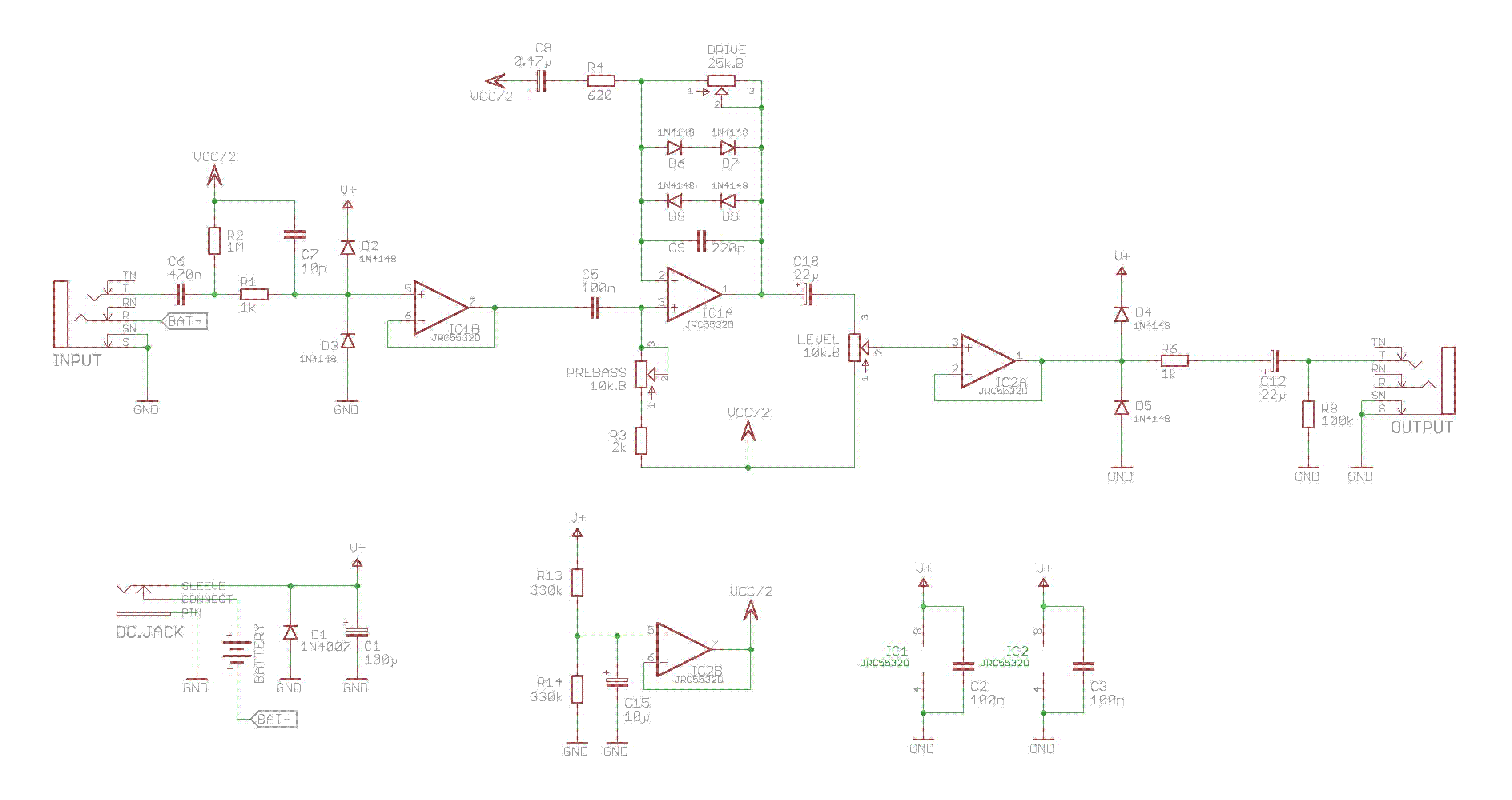

Hi Erik

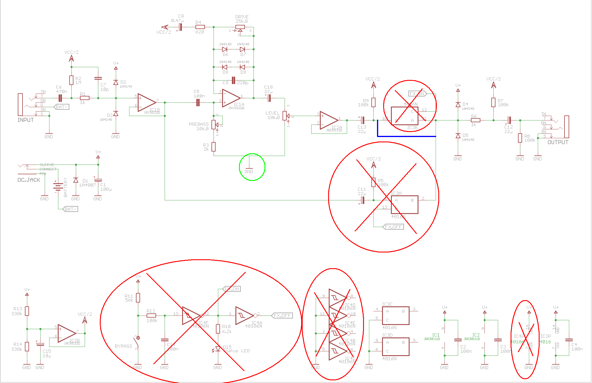

To start with, you can leave out all the stuff circled in red, and add in the connection shown in blue. Then you could probably simplify it a bit more by leaving out C13, R9 and R7.
I think you missed an earth connection. I've added it in, in the green circle.

Thanks a lot!

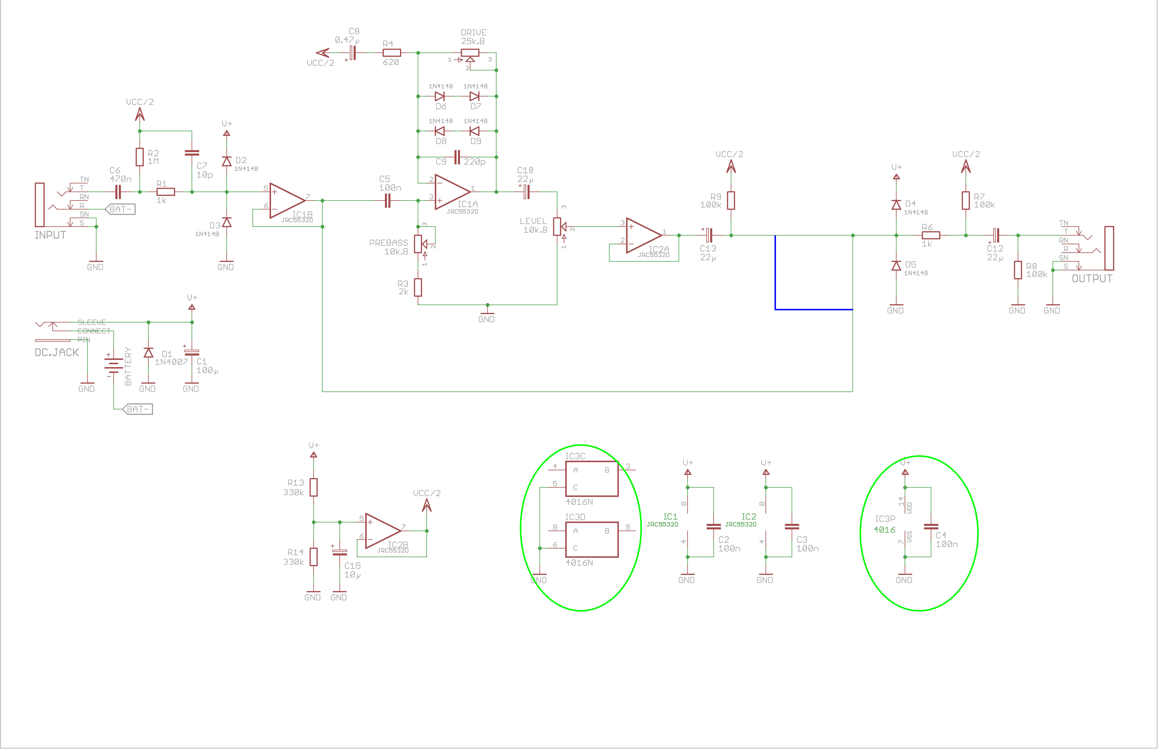

I have removed hen marked selections and added the ground. I got a few questions:
1. Isn't the blue line that you draw obsolete now?
2. I marked two more parts of IC 3 & 4, can't they go as well?

Sorry, I made a mistake. That should connect to VCC/2, not ground.😱I have removed hen marked selections and added the ground.
Yes, and where you deleted part of the circuit below that, it should be left open, not connected from one side to the other.1. Isn't the blue line that you draw obsolete now?
Yes, you don't need IC 3 and 4 at all, they were just to switch between bypass and overdrive.2. I marked two more parts of IC 3 & 4, can't they go as well?
You can leave out C13, R9 and R7 as well.

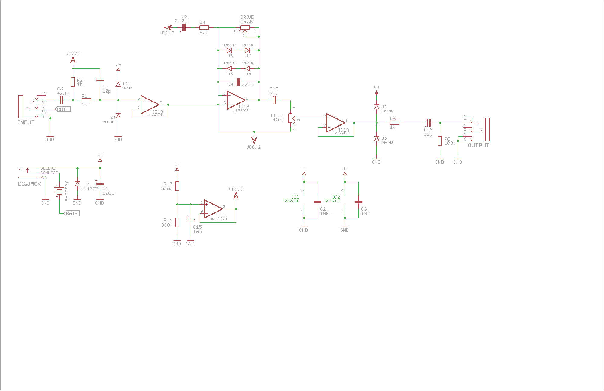

Wow.. thank you very much!

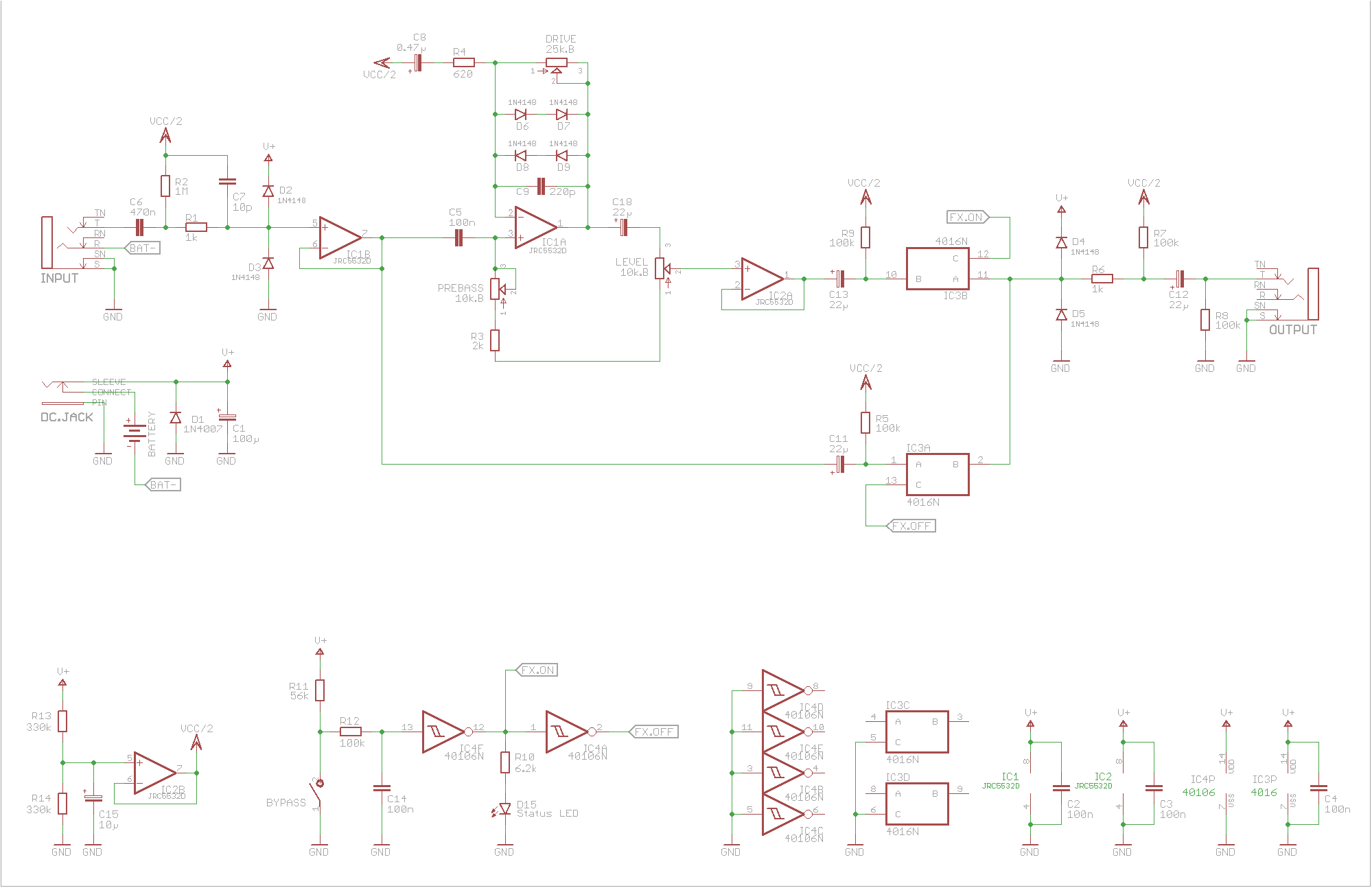

I have another question for you, if you do not mind. In the schematic there is a pre-bass pot. Could you from the schematic see what that does exactly?
The reason Iam asking is the following: the pre bass seems to add some low frequencies before distortion. I would like to be able to mod it so it can boosts higher frequencies as well...

OK, that's a tough one. I can see what it does electrically, but it's hard to imagine what it sounds like.
The Prebass potentiometer, together with R3 and C5 roll off the bass before the signal gets distorted. If you wish you could turn that control further one way or the other, you can get that effect by increasing or decreasing the value of C5.
The other part of the circuit that behaves differently at different frequencies is the combination of R4 and C8 (right at the top of the schematic). As an experiment, you could try changing the value if that capacitor and see what happens to the sound.
In either case, a slight change in value won't do much. I'd try at least doubling and halving them.
