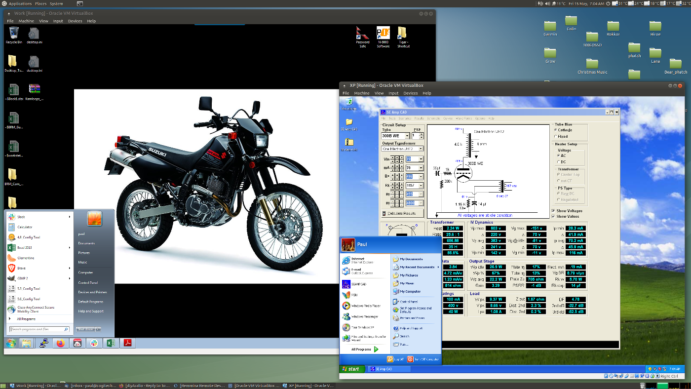

It always shocks me how few people (outside of the IT industry) know about and use virtual machines.
You could very easily download Oracle VirtualBox (100% free), install it on your best/newest workstation running whatever "base" or "main" OS you have, and then create multiple virtual machines and install whatever OS you want on them. You can even easily create shared folders to copy files from VM to VM or VM to host.
In your case, install VirtualBox in Windows 10 and then create a VM and install W2K and the old apps on it.
But like you say, what you have already works. VMs are just such a great option these days.
In the attached screenshot you can see my base OS is Linux, but then I have a clone of my work PC (Windows 7) running in a virtual machine because I am working from home (COVID-19) and also a virtual machine running Windows XP for the sole purpose of using SEAmpCAD.
This all runs perfectly on a modest 6 core PC with 8GB of RAM. I've scaled the screenshot because my desktop is huge.

I always shocks me how few people (outside of the IT industry) know about and use virtual machines.
This all runs quite perfectly on a modest 6 core PC with 8GB of RAM. I've scaled the screenshot because my desktop is huge.
Thanks for the tip. I need to look into that.
