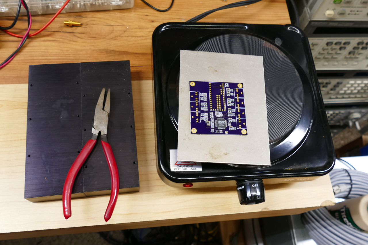

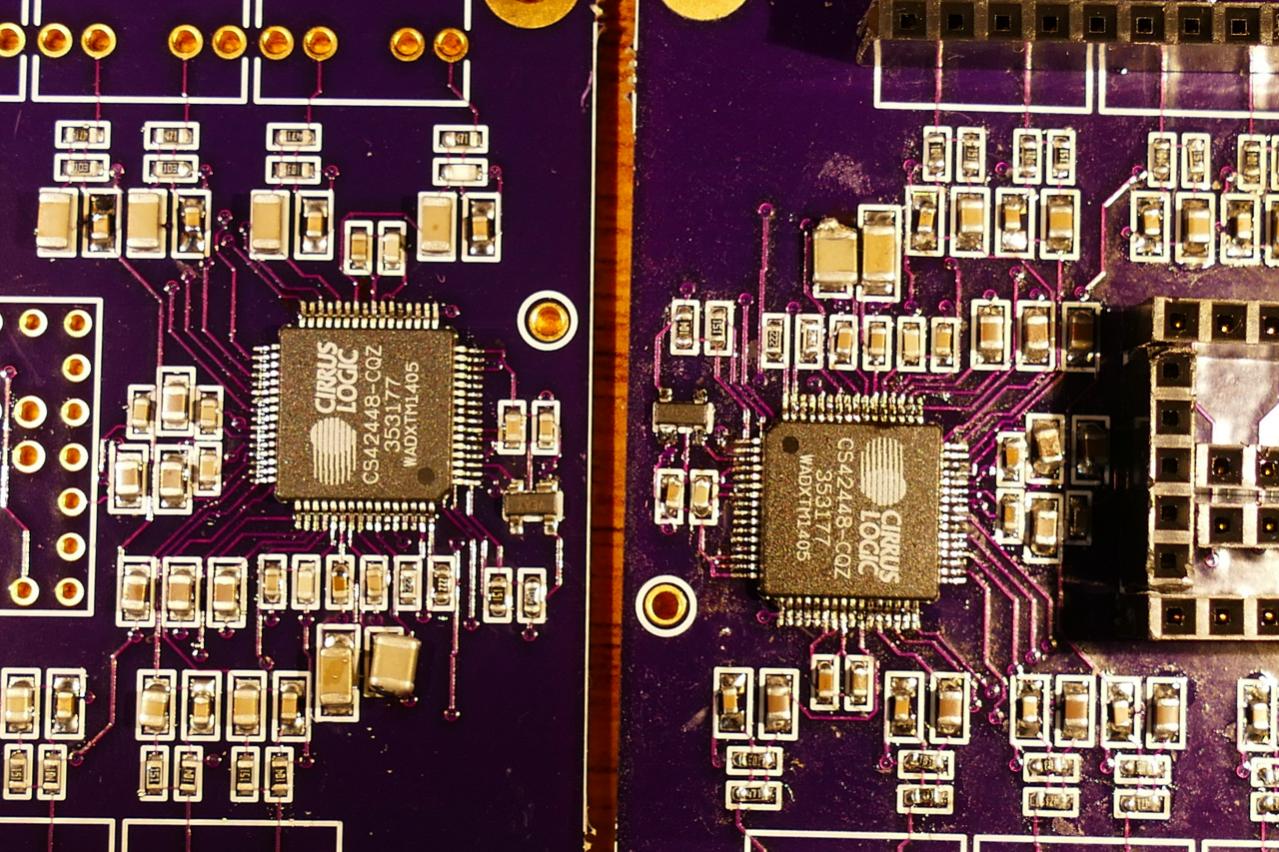

Soldering 0.5mm pitch smd TQFP ic's.
I grumbled and cussed away as I soldered my fingers more than the board when I used this method to populate the SMD parts on the first board I made....
Then I remembered the "frying pan" method that I pioneered at Motorola many years ago. It was named for the fact that I actually used a frying pan to "cook up" some of the first boards. The pan has too much thermal mass, so the process evolved into a hot plate, a small piece of aluminum, a big heat sink with a flat surface, some solder paste in a syringe and some tweezers.
The board on the right was made with a soldering iron, solder, tweezers, and an extreme test of patience. It took three days to complete at two or three hour+ long sessions per day.
The board on the left was made in under 3 hours total time yesterday afternoon.
First, using the syringe put a small dab of solder paste on each SMD pad. Run a thin line down each side of the QFP, shorting out all the pins on a side. Depending on the lead pitch this will be about the width of one to two pads.
If you are building several boards, and it is available from the board vendor for a fair price, buy a solder stencil. This allows the whole board to be solder clad with a jar of paste and a squeegee in a few seconds.
Next sit down at the microscope and place each SMD part on the pads in the solder paste. Perfect alignment is not essential if the board was made correctly. The parts should self align when reflowed, except for the IC's. They need to be pretty close, and square with the pads.
Place the board on the aluminum sheet, and turn the hot plate up full. If you have an infrared thermometer, wait until the hot plate is at least 50C hotter than the melting point of your solder, if not, guess. I guessed. Place the aluminum with the board on it on the hot plate such that the board is near the center. Watch until ALL of the solder has reflowed. It will turn from a dull grey to shiny silver. At this point grab the edge of the aluminum with some pliers and CAREFULLY move it to the heat sink to quickly cool it off.
The total "cook time" should be about 1 minute if the hot plate is hot enough. My board was cool enough to handle in about a minute as well, but I have good heat sinks and all surfaces are flat for good contact.
You may have to use some solder wick to remove excess solder from the IC's, but this will be minimal once you learn how much solder to use. The olny touch up I needed on the discrete parts were where I had used parts that were not the correct size for the pads. Total rework time for this board was about 5 minutes.
The solder paste and the hot plate came from Amazon. The solder paste came in a large syringe with a huge needle, bigger than the pads on the board. I ordered a smaller one, which will be here tomorrow. I will try it on my next board.
