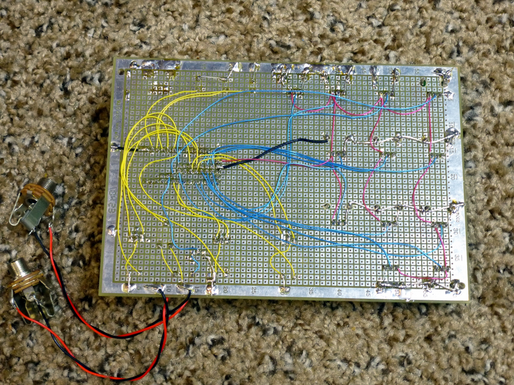

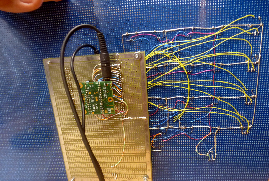

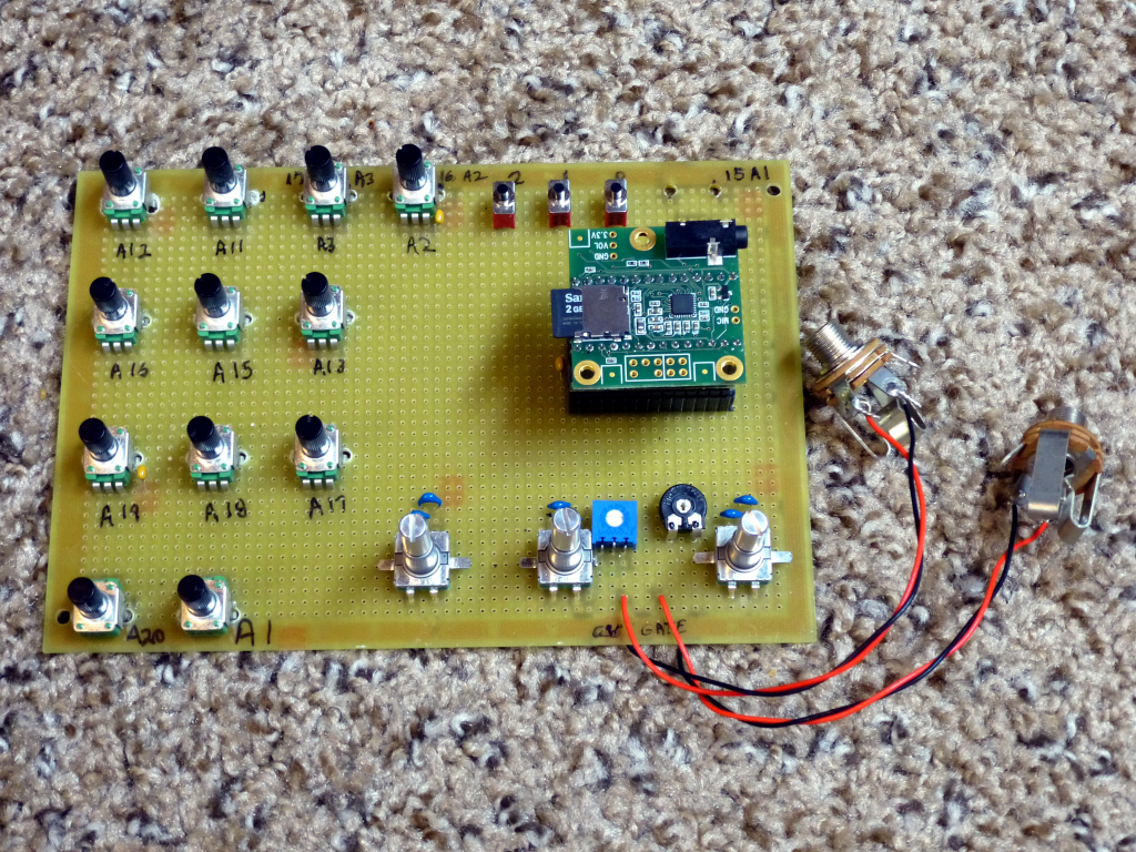

What has driven me nuts for three weeks, and almost led to a complicated undertaking hitting the trash bin......
I have always dreamed of building a big music synthesizer. I started one back in 1972, but never finished it......just bought a broken ARP Osyssey and fixed it.....far easier. I started down the road to building my own several times, but never finished it.
Then you find out a about a cool microprocessor chip that has enough power to make a decent synth, and has an audio library available.....OK, cool. Then you make a little breadboard with a dozen pots and a couple of rotary encoders........write some code segments, test them......repeat. Everything looks good so you decide to make a bigger breadboard, say 50+ pots, 4 encoders, and whatever else I can throw on it.....
You wire up 17 pots, 4 encoders, 1 push button on a 10 X 17 inch piece of perf board, splice together all of your pieces of test code, and put a wrapper on it, about 500 lines total.....and flip the switch, no smoke, no bang, just a bunch of random rude noises. All the test code worked VCO's, VCF's, VCA's all sounded like you would expect, so WTF?????
So you spend three weeks ripping stuff up, backing up to simple test code, and still nothing works......You run a few test programs from the web site, and they all work??????WTF again. My code MUST be broken.
I make a simple program, a single VCO feeding a pair of headphones. Load it into the original small breadboard, and it works.....load it into the new one......rude noises, no voltage control at all?????WTF again. My hardware MUST be broken.
I am about two minutes from grabbing the wire cutters, or setting the power supply on KILL!!!!!!! Then I found it......yes a ROOKIE MISTAKE....
Repeat after me.....then write it a thousand times.....
THOU SHALL NOT LEAVE AN UNUSED INPUT FLOATING!!!!!!
THOU SHALL NOT LEAVE AN UNUSED INPUT FLOATING!!!!!!....
Especially when it goes to a 16 bit multiplexed A/D converter......
The first two pictures are the old test breadboard. The last two are the start of the final breadboard. Lots more code to be written. If it all works, the next step is PC boards.

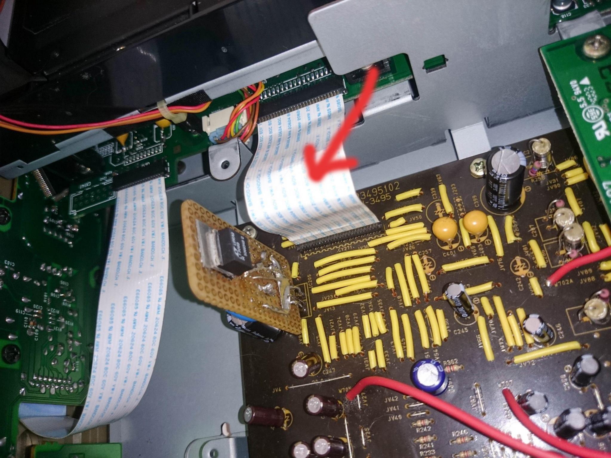

Today I discovered that I hate more than Screws
I started the day a number of improvements to the DAC circuit on the player I was working on.
After I finish
testing
5V
3.3V
9
9+
I turn the screws. Connect to the amplifier BMC.
No Sound
I'm racking my brain what I did wrong.
Check all circuit and everything is normal.
Connector again
And the power supply does not work with combination High frequency Shriek
Straight I turn off the player
Checking all the power supply and everything is normal.
I tell myself it's weird.
After 10 hours I have wasted my life
I find the problem
data Connector between the main unit circuit to the dac
There is a short between pin 1 and 2
When I plug in reverse
Voltage Regulators LT1764
that I built gives voltage
4V
Instead 3.3V
I separated with tweezers pin 1 of 2
And everything works
