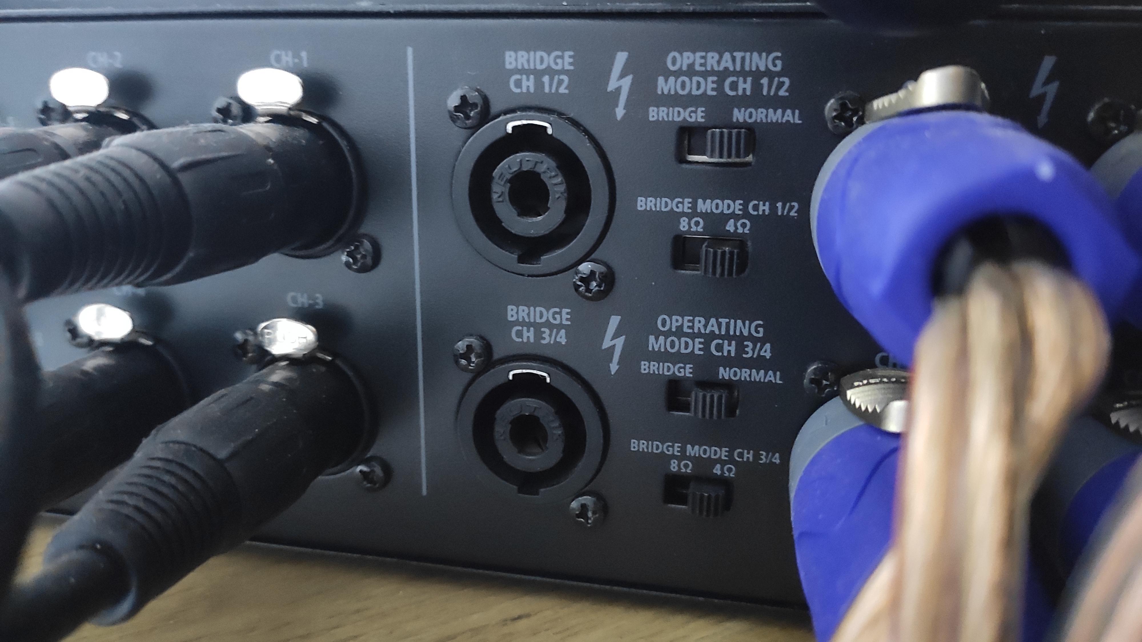

I just run my woofers in parallel for a 4ohm load, if you need more power you can get 2 x 1000w from the STA 2000D instead of 4 * 280w8ohm/500w4ohm. If my memory serves me correct there's a switch on back. I can take a picture when I get home.
But I do not need any more power for my woofers, have not yet managed to the the limiters to light up, even when testing with hearing protection.

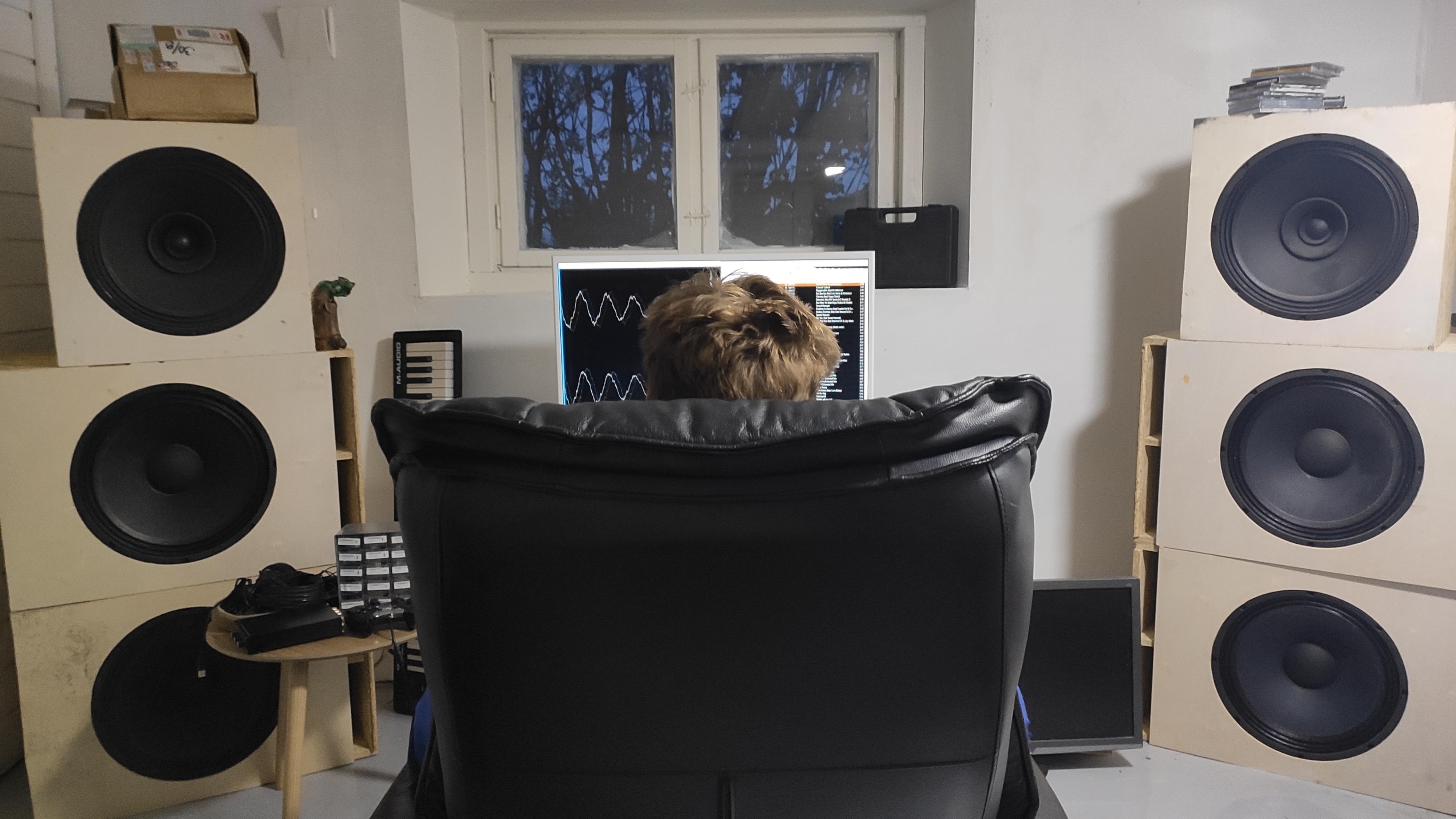

Added a picture of my den.
Edit2:
In my opinion, not much point in pushing more than 120w maybe +3db on peaks, so lets say 240 watts per driver, over that you start getting less value for your oomph, so to speak. Thermal compression, path of diminishing returns etc.

Here's a picture of the extra speakons for bridged connection, as well as the impedance switches.
IMO 2kw is just barely on the sane side of regular wall sockets (and fuses), at least over time. Amplifiers that provide more actual power than this (and not silly marketing watts), require properly dimensioned grid connection.
