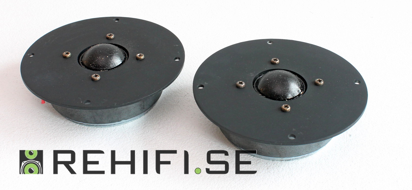

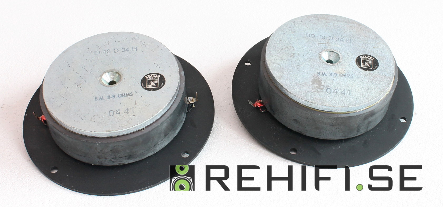

What old Audax tweeter is this?
It´s 135 mm
Mark´t 8-9 ohm at the backside, but no modelnumber.
Regards John

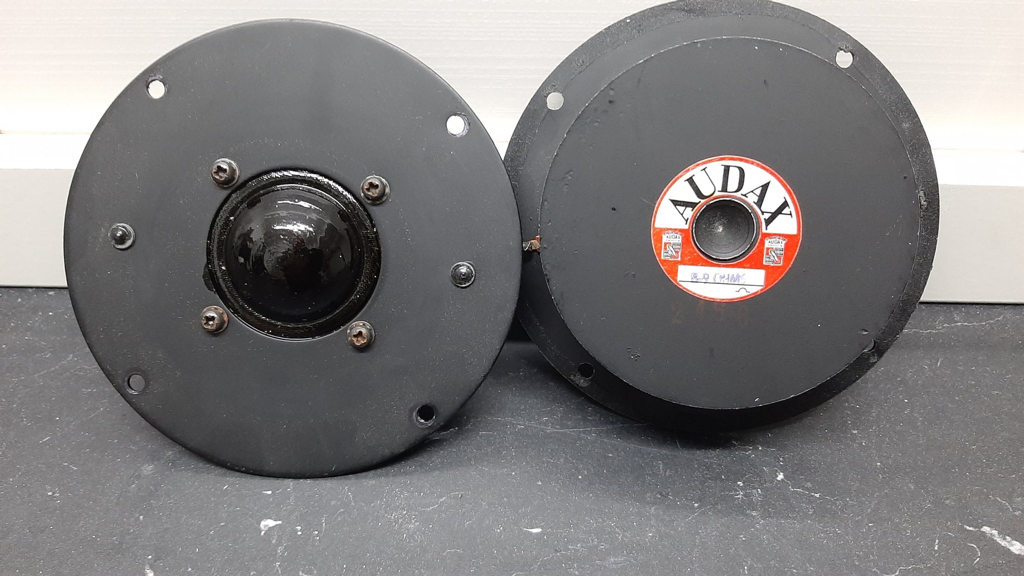

When they are old Audax, the foam underneath the dome will have deteriorated and dirt will be in the magnet where the coil will be hindered to work properly, open it up and clean it, remove the foam and put new damping behind the dome, i've done that, now they work fine again...
