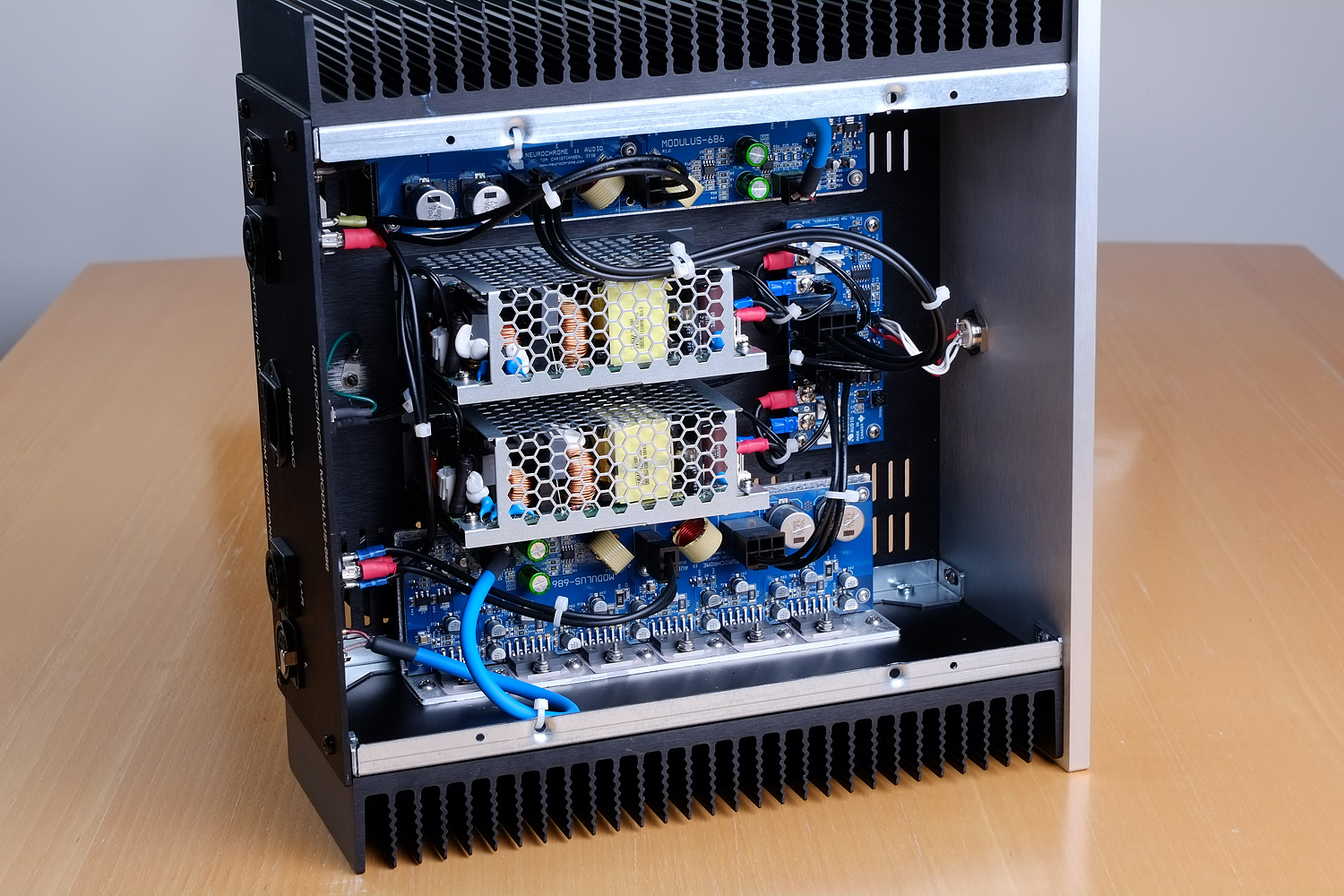

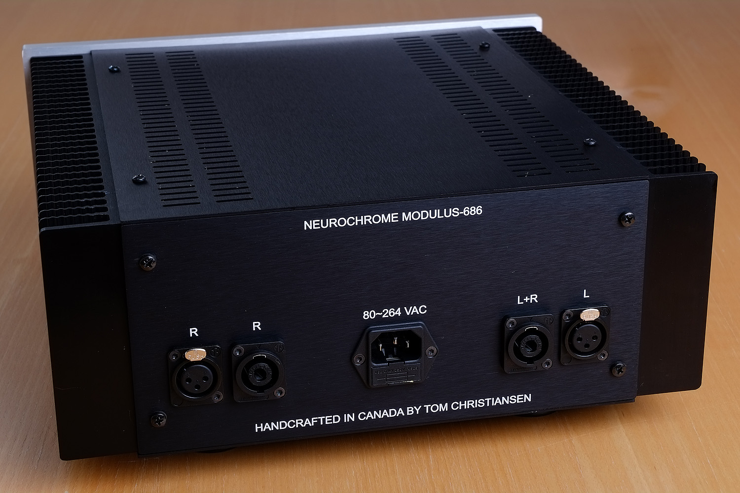

Tom brought a 686 in a 3U Mini 300 case as I remember to BA2018? He had to so it could fit in his suitcase.
Heh. Yeah. That was a fun build. I managed to fit two of them in my suitcase and still squeeze in under the 21 kg weight limit.
I call that build the Safe-n-Sane build. It runs on ±27 V from a pair of Mean Well RPS-400-27-C and provides 130 W into 8 Ω and 200 W into 4 Ω. The lower supply voltage means lower power dissipation, which allows for a smaller heat sink (3U x 300 mm) to be used. I really like the small "power cube" form factor. You can read more about it here: Choosing Your Amp – Neurochrome
The chassis is a ModuShop Mini Dissipante 3U x 300 x 330 mm.
That build used the Mean Well Controller and Rev. 1.0 of the Modulus-686. I will soon discontinue the Mean Well Controller as the Intelligent Soft Start can do the same job better. The Modulus-686 is now in Rev. 1.1 and has a slightly different drill pattern, so the old CAD drawings are obsolete (or I'd put them on my website).
For future builds, I would likely use the cage-free version of the RPS-400 and mount the supplies either stacked or on an L-bracket. It turns out that mounting the supplies by their cages (even with Mean Well's blessing) wasn't such a hot idea as the supplies tend to wiggle in transit. In some cases the wiggle was enough to bend the cage on the power supply. As result I shipped the four I built with an internal foam brace that the buyer then removed when they took delivery of the amp. That's fine for DIY but isn't the unboxing experience I aim for. 🙂
Once I have the CAD drawings for the updated Safe-n-Sane Build available I'll put them in the Resources tab on the Modulus-686 product page.
Tom

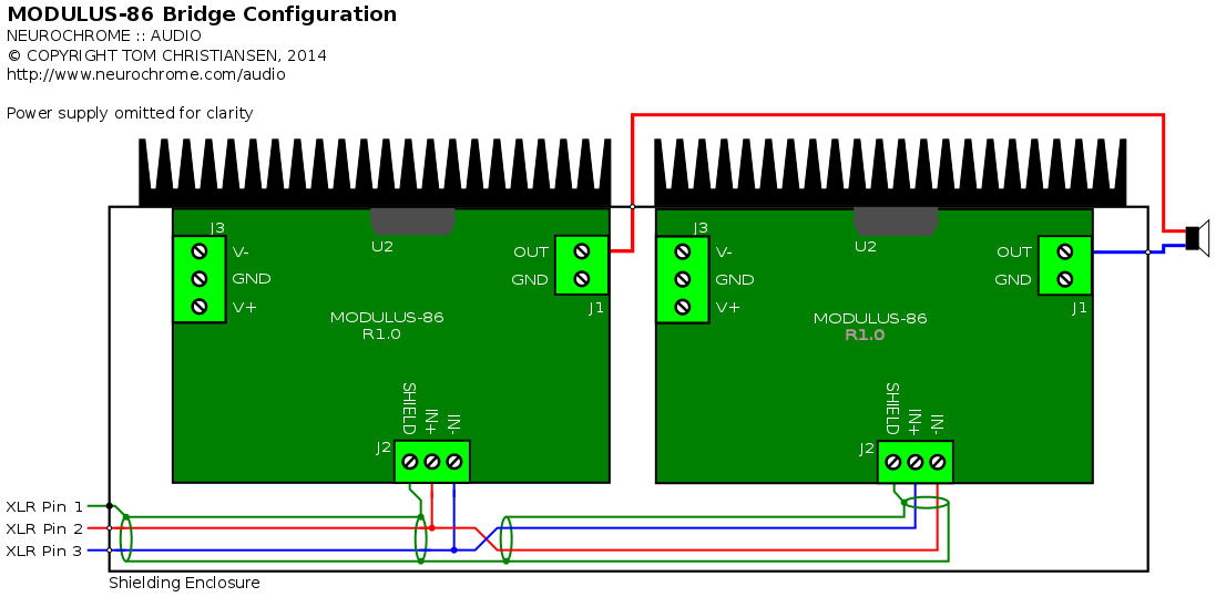

OK, so two things:
- that much math hertz ma brain;
- have you yet published a schema or block diagram for how the following might be accomplished?
If the Modulus-86 does not provide enough power for you, the best option in the current Modulus line-up is the Modulus-286. When operated on ±35 V supply rails it provides 60 W (8 Ω), 100 W (4 Ω). Two Modulus-286 modules may be bridged and operated on a ±28 V supply for 150 W (8 Ω), 270 W (4 Ω) of output power.
I assume that the total PS and heat dissipation requirements for such a project would be less than for a 686, whether implemented as monoblocks or stereo?
I haven't sketched one specifically for the MOD286, but here's one I drew up many moons ago for the Modulus-86.
Now before everybody gets all excited about bridging their Modulus-86 amps, keep in mind that with its 7 A output current it's really not a good candidate for bridging unless you want to drive a 16 Ω load.
The Modulus-286 (on ±28-30 V) would be able to drive a 4 Ω load bridged. 150 W, 270 W sound optimistic, though. I would expect the same or slightly lower output power than the Modulus-686 Safe-n-Sane build. So probably more like 130 W, 200 W for 8, 4 Ω, respectively.
The power dissipation would be the same as for the Modulus-686 Safe-n-Sane build, so you'd still need a 3U x 300 mm deep chassis.
Tom
