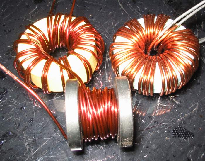

This is the "Drum" core that I bought yesterday. There are 2 more cores, one is light green and one is yellow. Don't know what they are.

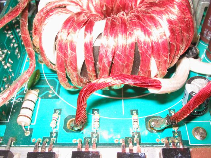

I've used this small+many wires in my SMPS. Like this one, I use 60pcs of 0.3mm wire. (but the insulation is not as good as big wires, you will have to wrap them again with asbestos tube in the ends, otherwise they will scratch each other)
Is this "Skin Effect" attention is a must in output ClassD LC filter too? I usually see factories (Crown BCA and other classD amps) only use 1 big wire, not "litz-wire-kind" bunch.
I do not think it is necessary to use litz wire for Class D filter. Usually you have only one layer winding, so it cools down efficiently and besides that high frequency AC ripple current of the switching stage will have relatively low amplitude compared to the full output current. I suggested some (3 or 4) parallell (not twisted) strands because they would cover toroid more evenly and would be easier to wind.

The "low uH with many turns" cores works. All of them works, none giving the "ringing" like before😀
Funny thing is, the uH value seems not important, from x1 to x5 like gives no difference?
Since all of them works, how to determine the "best"?

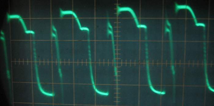

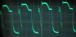

I also have another question. The top gate pulse voltage is like this :

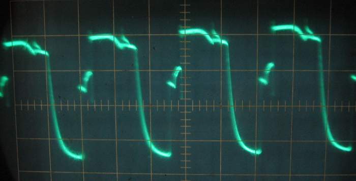

But the lower gate voltage pulse looks like this :
They are different shape, is this OK / normal?

Thanks for the frequency reading. 🙂
I'd say that the gate drive signals are strange mainly because this particular discrete topology is not very well suited for fast MOSFET switching. But if it works for your subwoofer amp, then have fun experimenting with it.😀 One thing to consider is that the lower MOSFET may get too much voltage applied to its gate if I am seeing the schematic correctly. You may consider using NPN level shifting from the lower rail instead of PNP from the upper, using 15 volt MOSFET drivers. Also consider the IR2011 half-bridge driver IC as your easiest method.
