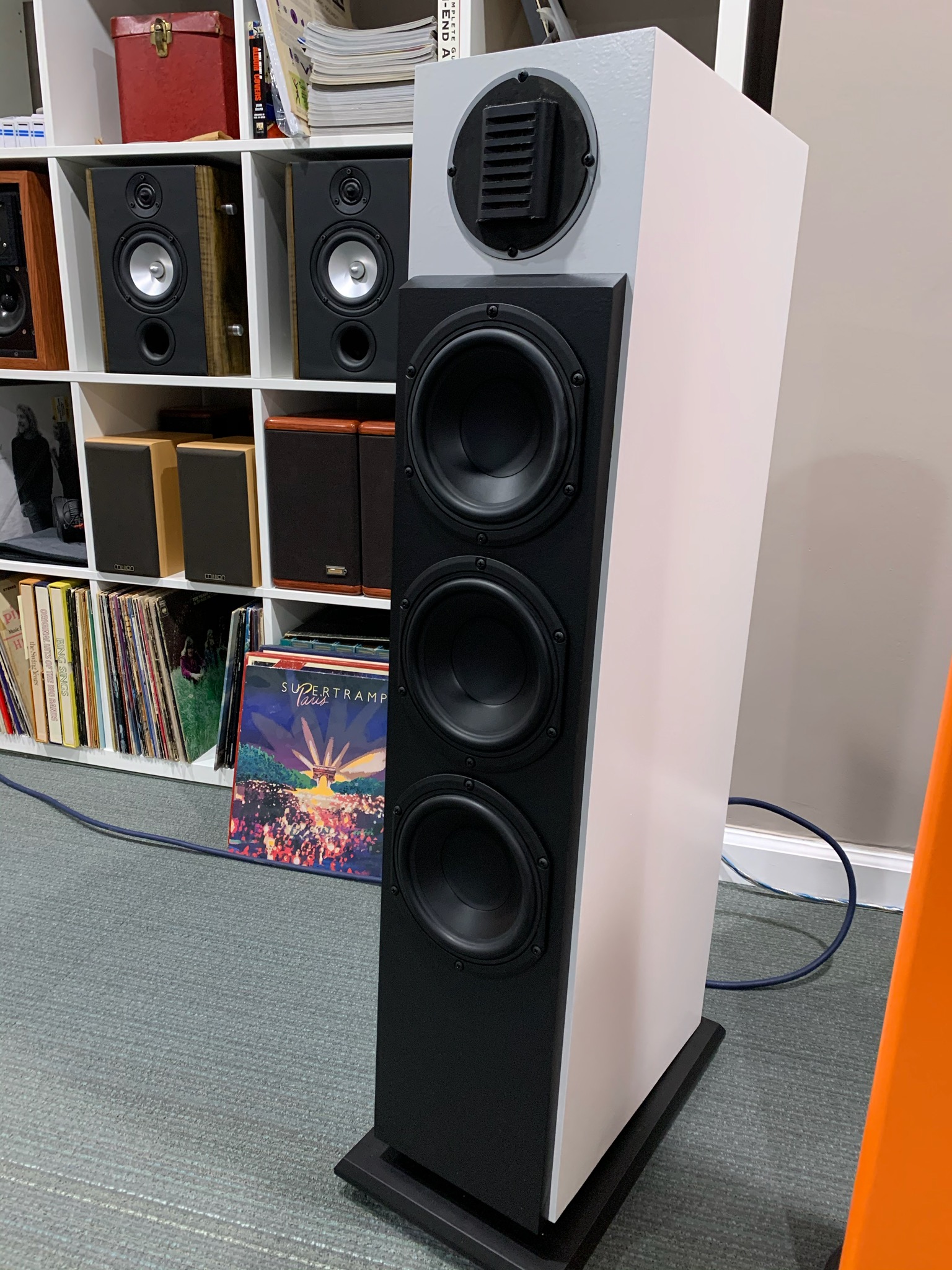

Here is my ESS AMT/Peerless speaker. It is a 3 way, two bottom woofers (ported) in series crossed over around 300Hz woofer/400Hz mid with 2nd order, same driver used as midrange in sealed enclosure crossed over to tweeter at 3KHz with 4th order on both sides of midrange to tweeter. It is tilted back 5 degrees to help time align drivers. That tweeter was very hard to work (possibly due to its housing); it is flat on baffle from about 1.5KHz to 5KHz where it rises steeply between 5 and 6 then it remains flat till it naturally rolls off. I ended up compromising a little with a dip between 3-5Khz because the crossover just didn't work if I ran the Peerless higher to mate with the rise.
