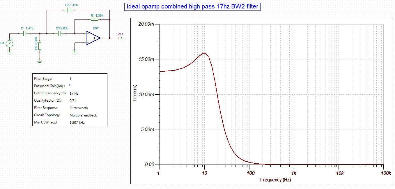

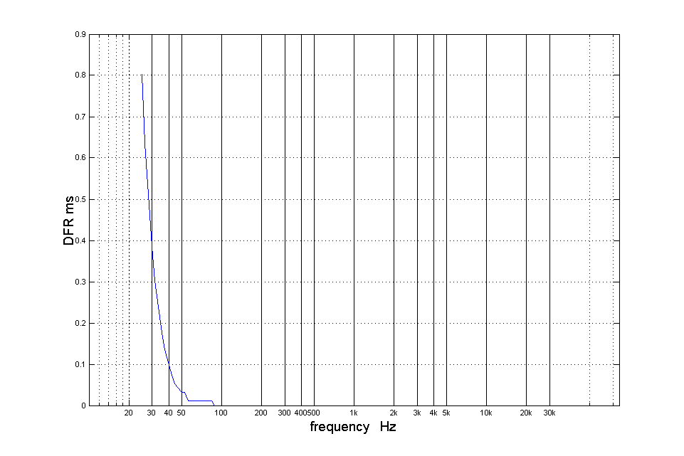

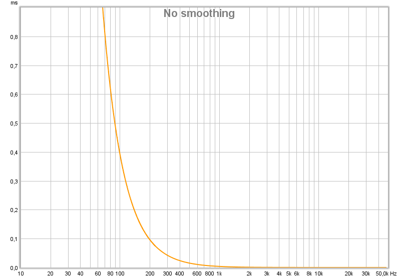

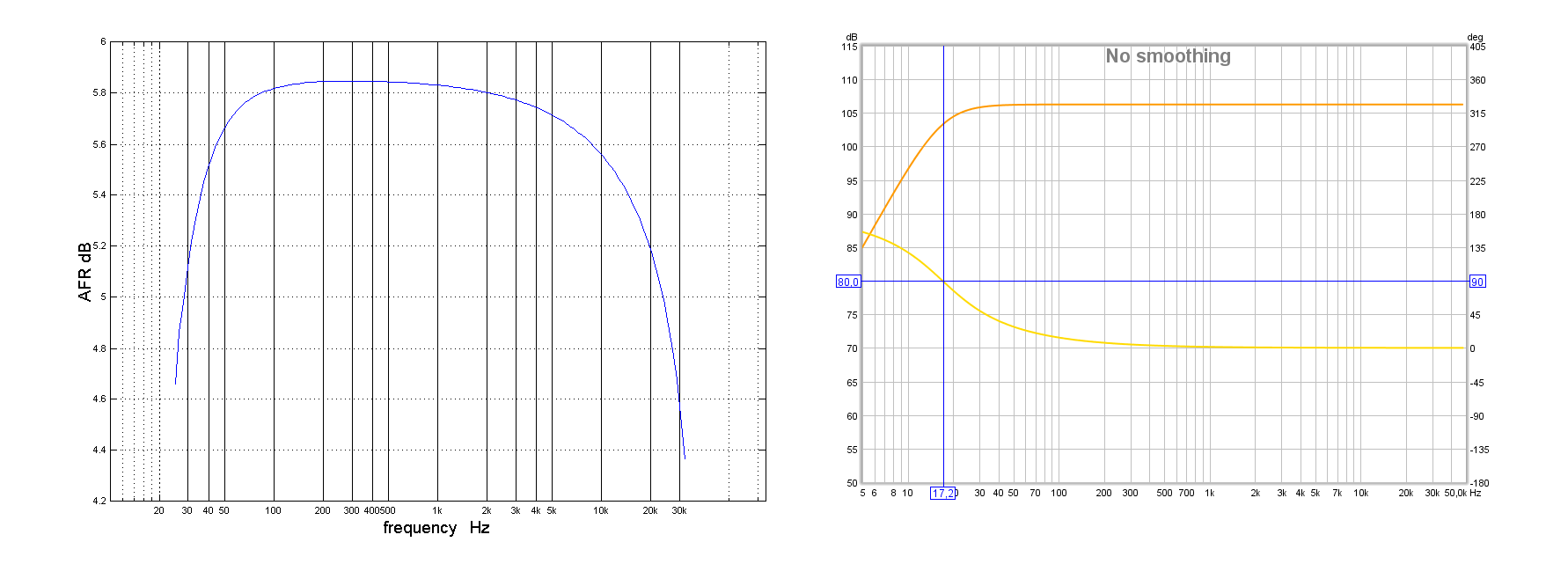

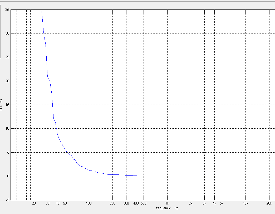

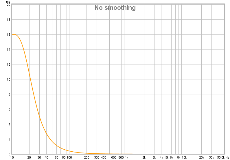

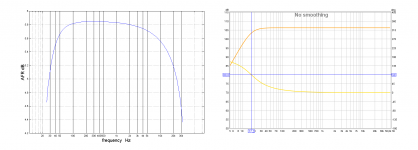

Regarding "threshold of Audibility" studies for group delay think not we can use exact mS numbers reported from APL_TDA for wesayso's system, we can use numbers compare wesayso's system verse jim1961's system because they both APL_TDA measurements. Engine into APL_TDA seems have unique filtering and smoothing scheme so those small numbers of mS reported for wesayso's system is very low and to show what i talk about here some comparison:
Picture 1 is 17Hz high pass BW2 with ideal opamp in free TI TINA suite.
Picture 2 is what APL_TDA report feeded a 96kHz IR-wav file created in Rephase as a 17Hz high pass BW2 filter.
Picture 3 is what REW report feeded same 96kHz IR-wav file created in Rephase as a 17Hz high pass BW2 filter.
Picture 4 is REW again scaled wider to show its not so far to TI TINA model.
In picture 5 its obvious there is unique filtering and smoothing going on into APL_TDA because that is FR window reading the same 96kHz IR-wav file into APL_TDA verse REW. Author of APL_TDA suite Raimmonds Skuruls in paper talk about use of high time resolution and there call it Time Domain Analysis (TDA), band pass filters that give high resolution timing information to see frq dependent delays in high resolution and also mention TDS as also Tom Danley talked about regarding his TEF-machine measurements in past.

I'd say that number 4 picture comes pretty close to what I get out in my room at the listening spot. It seems to be awfully close to the BW2 at 17 Hz.
