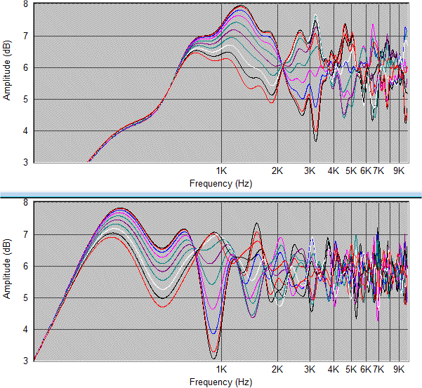

I thought this one could use a good kick in the right direction. I simmed the effect of diffraction on the response from 1kHz and up for the 8" and 2' baffles from point 1 above. Incidentally the baffles are very tall, no edge treatment, perfect point source, and zero out to 45 at 5 degrees per.. Enjoy 😉

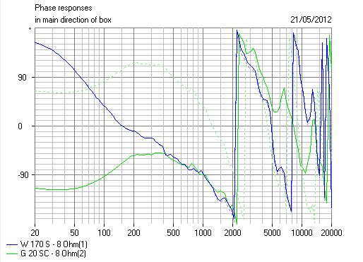

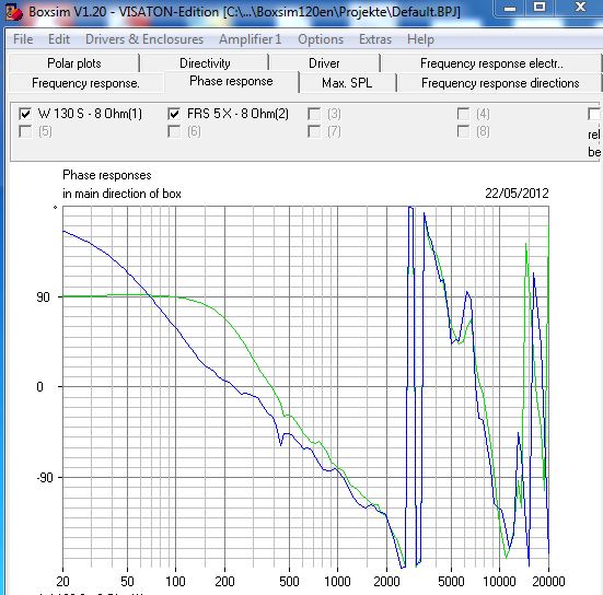

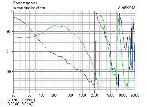

I looked at this simple 2nd. order crossover on a paper bass and dome tweeter:
In fact frequency response changes little in this example. But phase does some dramatic things with time alignment and (inevitably...) reversing the tweeter phase. Time aligned is the second two images. Enough there to get me interested. If you wire your tweeter out of phase, you are really time-aligning here, but on a conventional speaker you'll then end up tilting it to get it to work! Sounds familiar? 🙂
(BTW, this is a very rough and ready example, I think I could do better!)

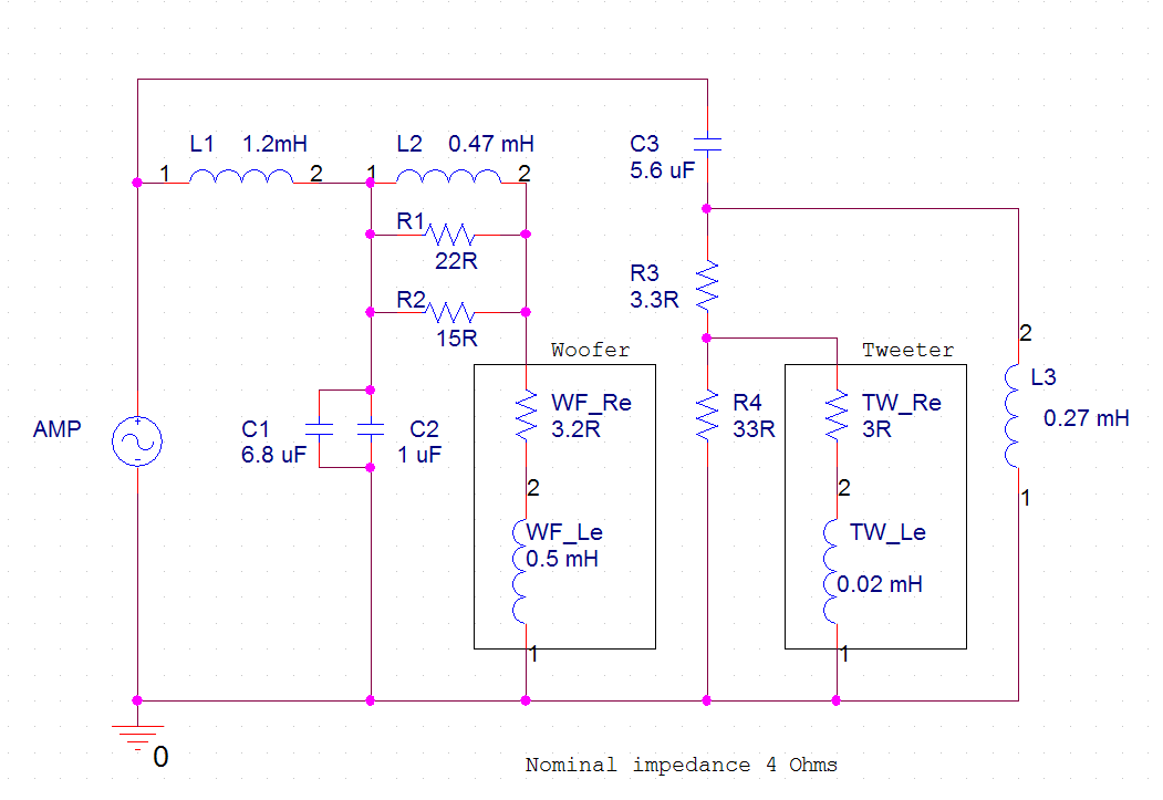

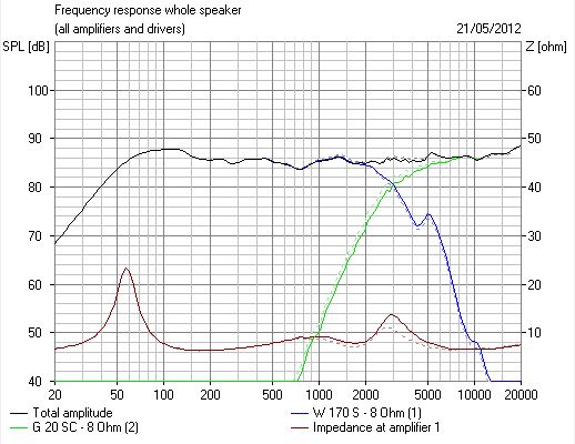

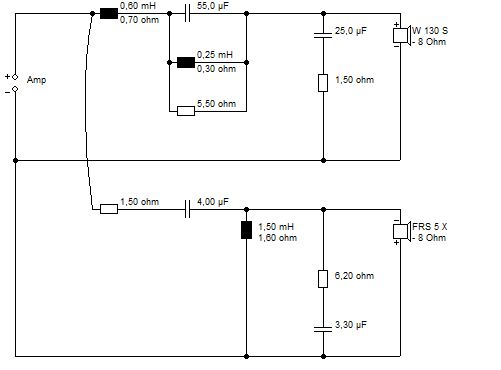

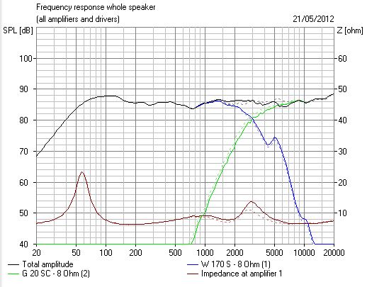

In the attachment is the XO in my new speakers... For simming in spice (of the XO), would the resistor in series with the coil that I drew be a suitable electrical equivalent of the drivers?
