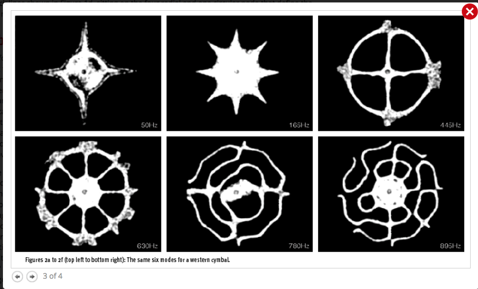

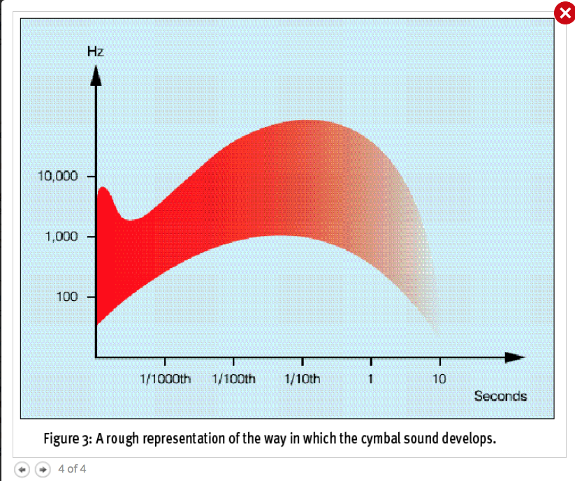

A real cymbal has unusual radiation patterns that shift during the time envelope after each strike, interacting with it's acoustic environment very differently than a loudspeaker's fixed radiation pattern possibly can.Now, I am curious why it was clear that a real instrument was playing and not a loudspeaker.
https://www.soundonsound.com/techniques/analysing-metallic-percussion

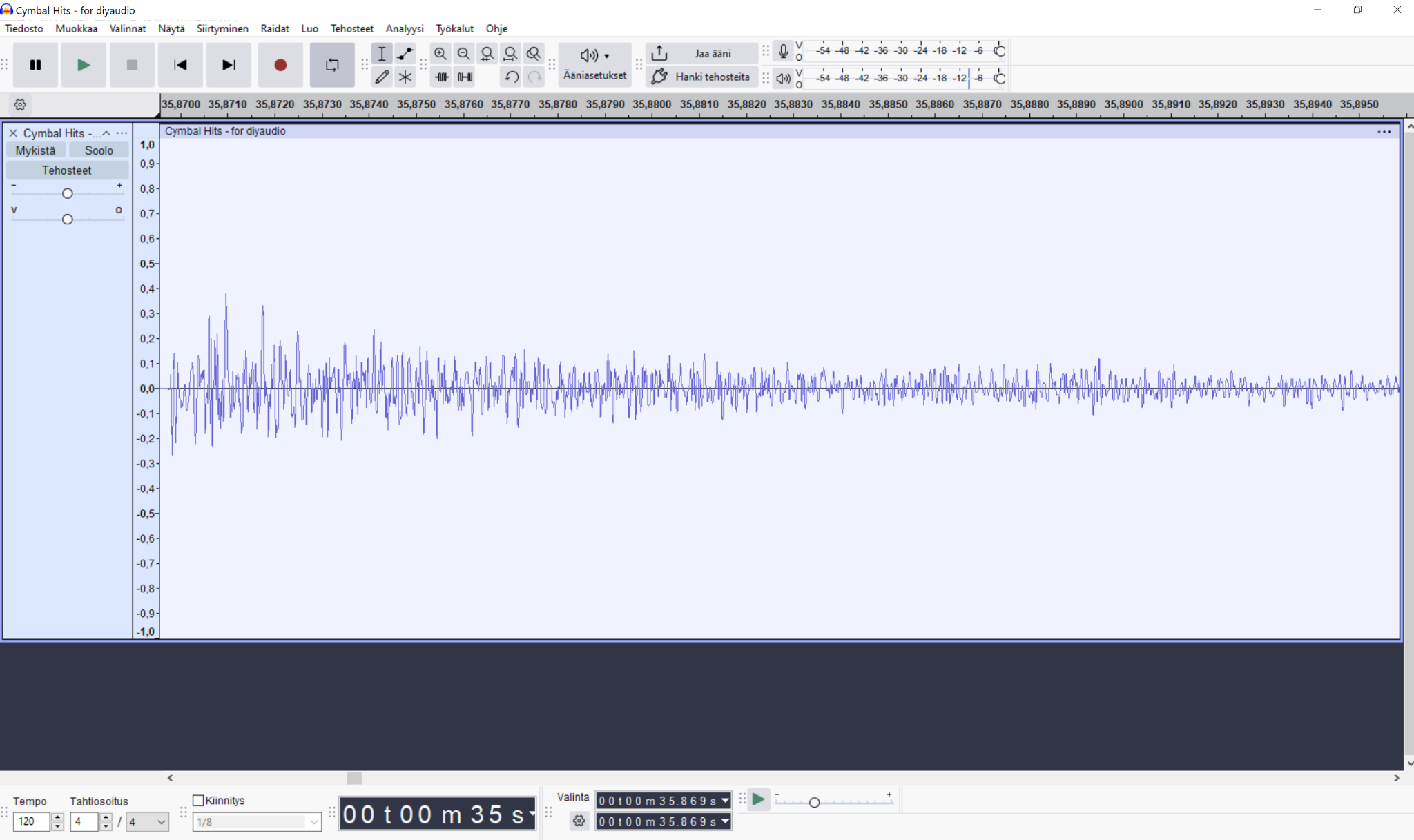

If anyone wants to hear some real unprocessed cymbal hits, I made some a few years ago for a diyaudio thread. Edited out only one hit for that use through. The whole track with multiple hits in mono is available at: https://www.dropbox.com/scl/fi/zdzl...udio.wav?rlkey=ibhwoa2e655ptcyct9y9pyn1k&dl=0 Recording was done with a Schoeps CMC-641 hypercardioid condenser mic, so not a lot of room sound. Mostly its just one cymbal hit in different ways.

@weltersys That write up at SoS is very good. Thanks.

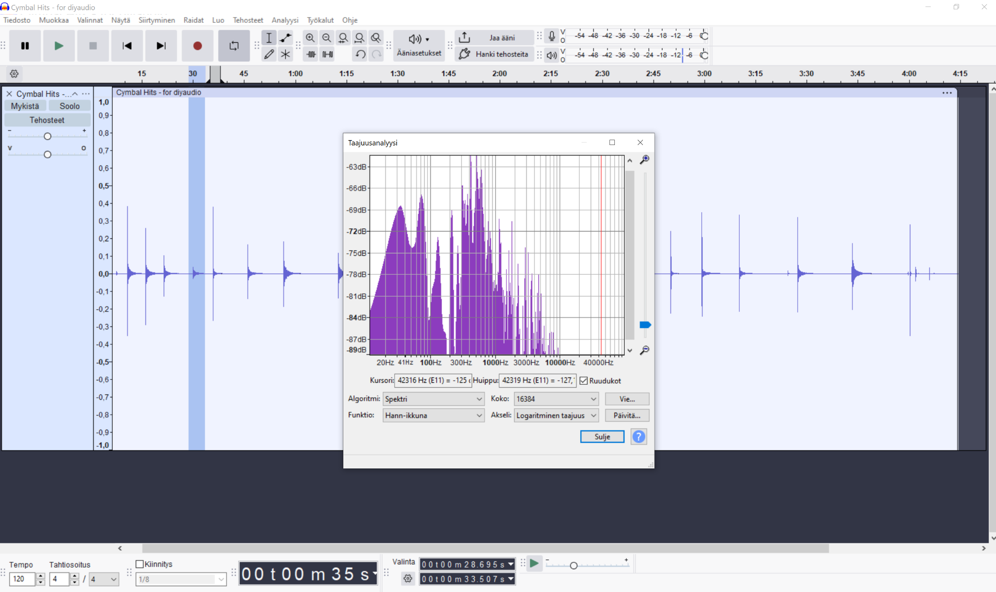

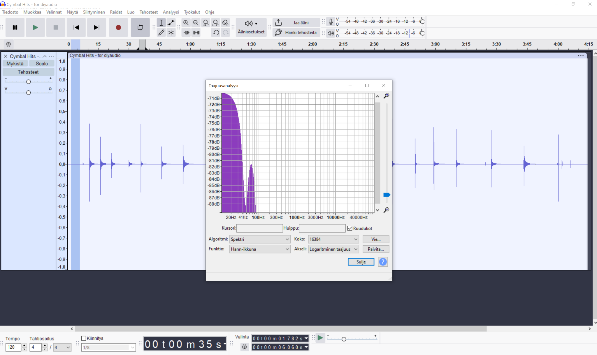

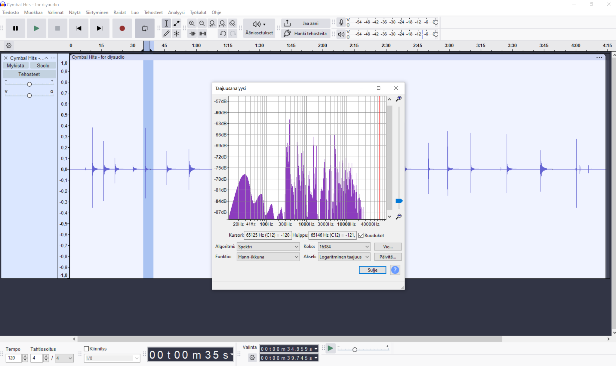

Here Audacity spectrum analysis of strikes 4 and 5, also ambient noise separately. Notice that dB scale varies!
