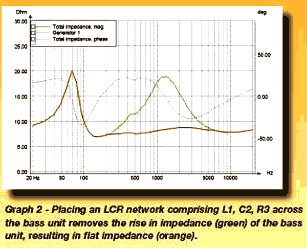

Aperiodic in its simpliest sense is without periods. This in the end applies to the suppression of the impedance peaks (or i should say maybe, we don't know what happens real low because the chart is cutoff).
Any box with a hole in it will have a saddle shaped impedance response at the bottom. An aperiodic enclosure suppresses both of these peaks (as interesting as looking at the impedance curve is to look at the 1st derivative of this curve. A classic TL will suppress the lower peak entirely and most of the upper peak. It is aperiodic. I say that my miniOnkens push a vented box towasrds aperiodic -- this can be seen in a ower impedance peak that is greatly, if not completely, reduced.
So one can look at an enclosure and decide if it is aperiodic by looking at the impedance curve. There are a number of routes to this. Joe's (and many clssic) TLs, Perkins PR2, ETM describes "aperic boxes where a sealed box has been stuffed full of damping. One could also have a sealed aperiodic enclosure simply be using a driver of suitably low mechanical Q (very hard to find, but as the benefits of current amps are explored, we may see some). Anyone measure the impedance curve of Dyna A25.A35, A50?
I found the impedance curve for the World Design A25 clone... it is only aperiodic in that the lower impedance peak does seem to be fully suppressed
dave
