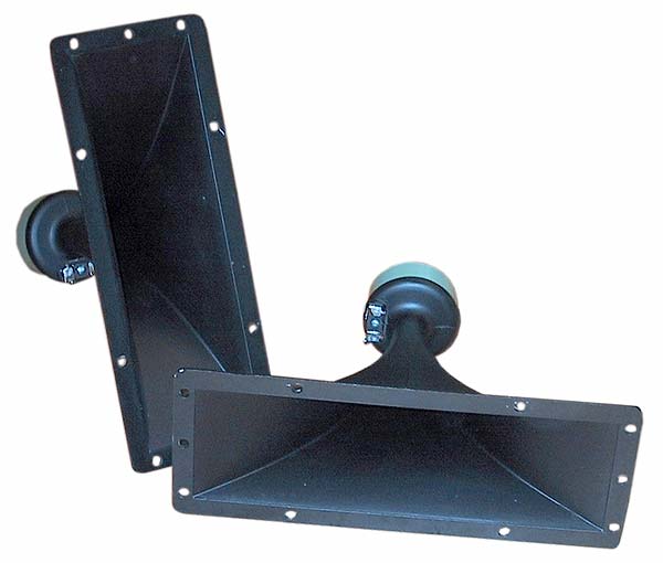

Hi dave, I was told it's an Oxford mid-horn. Maybe you know the equivalent?
Looks like the attached? If it is an Oxford it should have the number 465 on it (grouped with 3 or 4 trailing numerals)
dave
