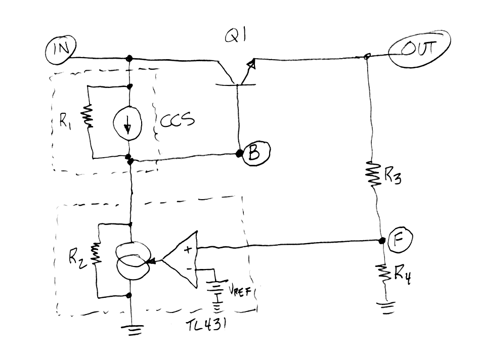

The topology I am working on:The end result of the Early effect is to modulate the Vbe as a function of Vce.
It will influence the PSRR of all topologies to some degree, but the effect is going to be maximal for buffered zeners or cap-multiplier topologies.
if the pass transistor is current-driven, the effect will be negligible.
The base of the pass transistor is driven by a node that has the cathode of a TL431 and a CCS.
The CCS brings current to the base of the pass transistor. The emitter of the pass transistor is at the regulated output.
The CCS is in // with the CB junction of the pass transistor.
This topology does exhibit a high dependence of the Early voltage into the 100Hz ripple reduction.
From VAF 100V to 500V a -14dB PSRR.
That makes sense if the current source is ideal or good enough to be regarded as ideal. When all other paths are negligibly small, the transfer from input ripple to output ripple will be determined by the ro of the transistor (I mean the resistance between collector and emitter in its small signal model) which is approximately inversely proportional to the Early voltage. Compared to the topologies Elvee wrote about, overall feedback via the TL431 will improve the PSRR, but the number of dB improvement when going from 100 V to 500 V will remain the same as long as the ro of the pass transistor is the main path to the output for 100 Hz ripple.
Early effect also changes the base width and should therefore change hFE, so I don't understand why it should be negligible when the transistor is current driven.

In my simulations, I use an ideal CCS with a shunt resistor to represent the dynamic resistance of a real CCS.
A CCS made of two BC857C in a ring configuration exhibits better than 3 MegOhm at voltages down to 1V, then drops sharply, 160K at 0.9V. This voltage is actually the pass transistor Vcb.
So, this real CCS is an ideal one considering the Early effect of the pass transistor.
jan.didden. I was confused about what drive is the pass transistor in my considered topology, current/voltage ? Open loop/closed loop ? Thanks to make it clear by a simple answer.
In most regs, the current source supplies the base of the pass transistor, and the opamp, through the feedback, draws away just enough current to maintain the output voltage.
That means that the base of the pass device 'looks into' the low impedance opamp output, and thus is voltage driven.
What that means is that in terms of parasitic capacitances, the pass device runs in grounded base.

You are right, of course.Early effect also changes the base width and should therefore change hFE, so I don't understand why it should be negligible when the transistor is current driven.
To put some numbers to it: the TL431 has a typical transadmittance of about 5 S and a voltage gain of about 1000 up to 3 kHz when the voltage at node B exceeds 10 V, about 700 at lower voltages. So Rz ~= 200 ohm, open-loop Zout ~= 4 ohm guessing that beta ~= 49, loop gain ~= 1000 R4/(R3 + R4). With for example R3 = 5 R4, the closed-loop Zout is about 24 mohm, roughly 48 times the square resistance of 35 um thick copper.

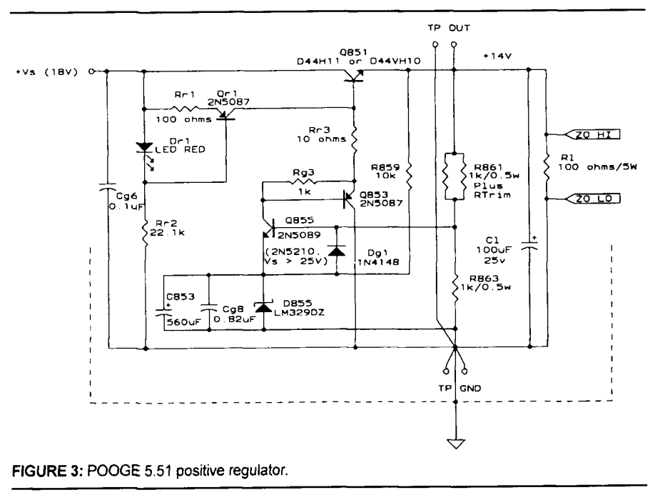

24 milliohms finishes 3rd worst in the Linear Audio shootout:
LINK TO PDF
Better than Burson and SuperTeddy, worse than twelve others.
Embarrassingly, it's significantly worse than the POOGE all-discrete regulator: 3 milliohms on the graph. POOGE also has a single gain stage, driving a single NPN emitter follower pass transistor. It was published by Walt Jung in The Audio Amateur, Issue #1 of 1995. Schematic below.
Notice the protection diode across the base-emitter junction of low noise transitor Q855. That's not a rookie play. Notice the base stopper resistor Rr3. That's not a rookie play. And notice the little stunt which reduces the openloop output impedance by more than a factor of ten. Pretty good performance for a 25 year old circuit design using 4 discrete transistors.
