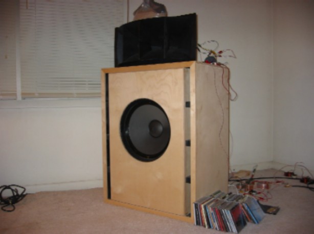

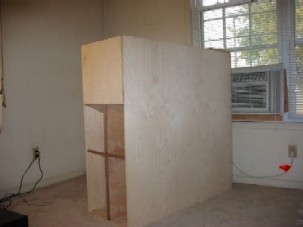

Thanks for the look. Here's one of the horn sub.
Tim
