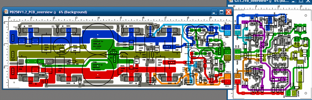

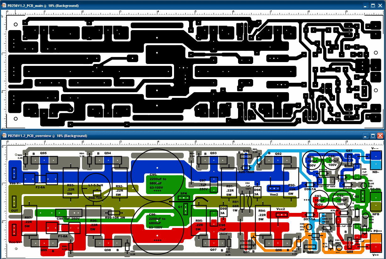

If you choose an amp to clone , pick one that uses high Ft/gain input stage and voltage stage devices. Then you can then be assured that you will find a modern equivalent and the compensation will work out fairly close. It does not hurt to simulate the original (with the original parts) ,to get a "feel" for the circuit. Read as many reviews as you can, the number of reviews and how positive they are are a good indication of the valor of the equipment.
I am amazed what the OEM's get away with.. BIG loops on the grounds , a million jumpers and small Pf caps to reign in the parasitics after the layout and production has started. WE , as the DIY'ers ,can add many extras , flyback diodes at the outputs , over rated capacitors and resistors , pretty led safety indicators , capacitance multipliers , AND make a better layout with separated grounds and split supplies for the different stages.
What is a fallacy is the cost. My 2 -250 watt power amps only came to about 70 dollars FOR THE PAIR , another $30 for the voltage amps and I will eat luxmans for breakfast at twice the power. This is far cheaper than reconditioned classic amps in this class, even on ebay. I did use the best panasonic and wima caps , Vishay 1% resistors, hardy ON semi output devices ... NO chinese fakes. Still, at $100 a pair , it can't be beat.
Where you REALLY spend the bucks is the power supply , my trafo(s) and the capacitors would of cost $200 if I did not salvage them. It is a long harrowing experience to design a good to exceptional amp , most of the expense is your time and learning curve. In the end , you can easily exceed the OEM's in both reduced cost and performance.(below-just priced it..)

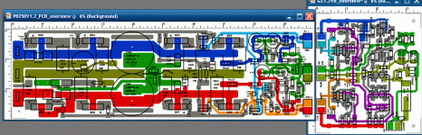

1. start simple and with a lower power. A suggested amp is something like a DX original or my BX , or a blameless(I hold no bias). These amps have under 10 active devices and are VERY hard to screw up. Some truly qualify as audiophile and are used in VERY high class equipment. To build at the 40-50V rail level also keeps you safe in your first "steps".
2. I should of done this 2 years ago when I started this "adventure" , but modular is the way to go. You might find out down the road that you want to try something different ... it is a shame to waste good PCB's. Also with a modular system you can just unmount your input/voltage stage to alter compensations, upgrade components.. much easier.
3. Simple is best ,both in cost /reliability and the unlikely event of failure. being DIY , feel free to over-rate any and all parts (especially caps) and run your active devices as cool and well heatsinked as possible.
4. Have at least a oscilloscope (I didn't have one for a while- it was hard) , DMM and become proficient with a spice simulator (LT is nice).
These are the only general tips that can be given ,for each type of amp has it's own idiosyncrasies. Seeing an example is worth a thousand words (below).. that one took a month to get right , will build it next week , it is far more rewarding to design , prototype , and finally listen to YOUR creation than to just buy a kit.
I looked at all the diy amps here , all my hundreds of service manuals and read thousands of pages .. both subjective and technical, to come to my final design decisions. there is a lot of good advice to be had on this forum as well.
