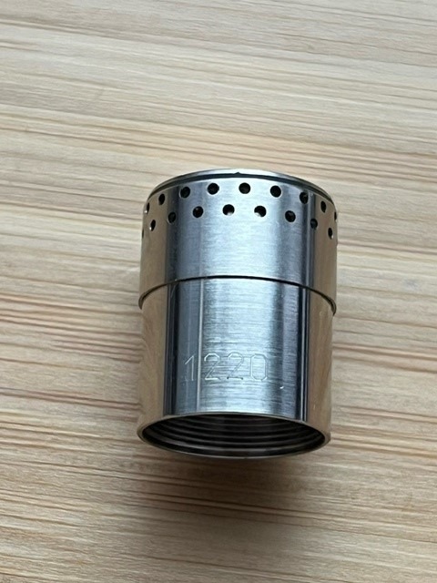

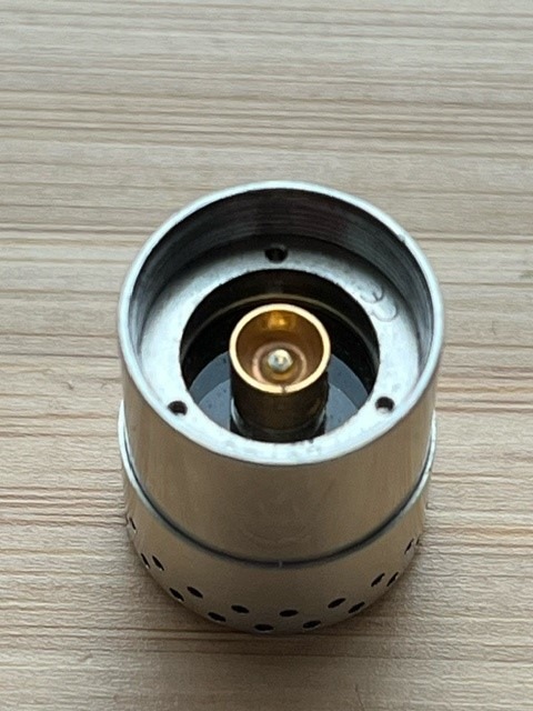

I purchased this on ebay on a whim. It was sold as B&K but it was clear immediately that it is not. There is a Logo on the side that looks like a W and M woven into one. And a number "1220" on the opposite side. On the back side, there is a CE sign and what is probably a serial number, five digit unlike B&K.
Probably Norsonic 1220.
https://norsonic.asia/wp-content/uploads/2015/04/Norsonic-Microphones-Datasheet.pdf

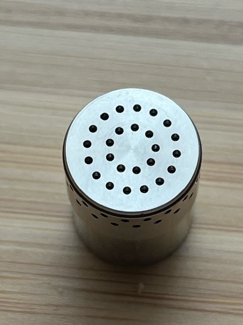

The grid on yours liooks like the front plate is insulated from the housing. If so it may enable electostatic calibration/performance verification of the mike. The grid resembles the grid on the Gefell mikes https://www.microtechgefell.de/messtechnik-alle
