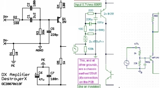

What makes a power amp to have a better soundstage ?
Don't forget the old saying :G.I.G.O.
(Garbage In = Garbage Out)
Many members of this forum are more than aware of the various manipulations that go on in a recording studio and other venues.However, even if the recording engineer has placed instruments and voices along the space between the channels ,
and even though it is completely unnatural, many amplifiers are NOT capable of separating these things into their own separate locations when reproducing the recording.
The majority of owners of equipment capable of reproducing a good soundstage, do not use their equipment for the primary purpose of playing back such material. However,stereo amplifiers are also used frequently for listening to other material , such as audiophile discs, including SACD etc, as well as when watching movies and TV shows. Surprisingly, even the daytime TV soapies such as "Days of Our Lives" often have an excellent soundstage. I must admit, however, that the majority of Australian TV productions do not come even close to the quality of some of those big American productions. McLeod's Daughters is a notable exception. A couple of days ago, I played the LPCM Music Video "Beyonce-B'Day" . Many of the tracks had no depth to them, and did not even completely fill the front space between the speakers. Again, G.I.G.O. Several tracks however had excellent soundstages.

Hello
Wen we talk about soundstage we mostly refer about very good recorded cd and vinyl. Good recording engeener understand the psycoacoustic of human ear and brain perception, so they know how to tailored soundstage, understanding how to use the combinaison of level and phase ear perception. But the best recording are wen we give feeling of natural "presence" of the musicians with no artificials fuss and cheebang.
But back to the amps, most of soundstage come from mid-high frequencies transient signals and very low level signals from music recording.
Since most amps do have much more distortions at very low level, like crossover distortion, TID, etc... Wen a music are arround 0 db and the low level soundstage signals are at -40 db, those low level signals are lost in crossover distortion and high harmonic distortions, TID, etc....
So I presume that a good amp should have, the lowest crossover and very low high harmonic distortion and almost no transient distortion, etc....

That is the way that I see it. My Class A Amplifier for example
probably has even much lower distortion than the original design's published figure of .0006 %. This is due to very close matching and thermal coupling of the input pair (2N3811A), as well as careful selection of other devices, including reasonably well matched O/P devices. Low noise from the power amplifier as well as preamplifier and source, is also necessary to make full use of this low level information. That is only the ambience component though. You also need maximum channel separation. This is way above what the "experts" claim is necessary for good stereo.
In the preamp I use a DACT2 24 position attenuator because of it's precise channel level matching, low noise, and much wider bandwidth than a normal dual potentiometer. Channel separation
is superior too.
I also use a very low impedance, and low noise PSU for all of the preamp, and the same type for the amplifier's front end.
All these measures add up.There is no single "magic bullet"

Not sure if I should enter here; could cause flameout......
The AKSA was not a copy, or even inspired by, Rod Elliot's very good Project 03. It was originally inspired by Arthur Bailey's Harry Lin derived circuit of the mid-sixties.
The recording process has been touched on here, particularly by Alex. It is pivotal, and usually strips away a good deal of the harmonics of the original performance. Why? Because mikes are directional, just like speakers, and this does influence sound quality enormously. Close miking is one way to minimise this, but it has other problems - it is all a compromise.
Sandy, I see you are an adherent of Self/Simpson. Ideologies are inclined to start fights, but you indict the AKSA by saying it colours the sound and generally adds distortion. Believe it or not, by saying this, you completely sideline the amp in a sweeping gesture without even having measured it!!
At 1KHz sine 50W into 8R resistive, total distortion measures at 0.042%. At 20KHz, same power, the distortion rises to just 0.045%. There is nothing above H4 in the artefacts. This distortion figure is very good, since what little there is is all H2, H3 and H4. The Lifeforce delivers ten times superior figures, but does not sound ten times as good, merely better. I do feel that the spectrum is the significant thing, not the total distortion.
I recall something NP once said about distortion. If we have 2% distortion at the 5 degrees around crossover, and very little elsewhere, the amp still weighs in at 0.03% taken across the whole cycle. This shows how crass the THD system really is, because it takes no account of the profound influence of the sound arising out of the crossover event, which necessarily takes place at very low amplitude where all the spatial cues are found.
I do match hfe on the input devices to better than 2%, and on the 100W AKSA I also match like output devices pretty tightly. Power supply caps are Nichicon Gold Tunes, and power rectifiers are ultrafast soft recovery types. I use fast drivers and outputs, and a 100MHz VAS. Parts selection is important, but only a part of it. Everything matters, as one would expect.
Doug Self writes a damn good primer on amp design, no question. But he fails to address some of the very important issues of amp topologies, for example he demurs on compensation and phase lead, and he promotes the high output impedance of the VAS as a good thing, without elaborating on how it reacts as it drives the highly variable loading of the output stage. No one has been better read in this field - commendable - but nothing can replace the Edison approach of pinning the tail on the donkey until you get something interesting.

Hi Gaetan,
In my experience you are absolutely correct! And the real problem is that the crossover event and its associated switching artefacts is very fast; just at a time when output devices are rather sluggish since they are almost turned off.
This makes correction very difficult; not even fast gnfb can easily accomplish this. Sometimes I think that the THD measurement system was designed by marketers, a bit like power figures on automobiles. How much power does a 200HP gasoline engine produce at 2000rpm where we do most of our driving? Typically about 70HP, yet this is played down for obvious reasons....
Hugh

I don't necessarily agree with everything that Doug Self says.For example, I don't like the 10R/1,000uF in the -VE supply rail.
As far as Leo Simpson goes, his designs are very conservative, with far too low a HF input filter.
I believe that Altronics and Jaycar probably have far too much say in what results. The man himself, in a telephone conversation used the words "belt and braces" in respect to EMI ingress. However, they provide good building blocks,as well as making components and kits readily available.
