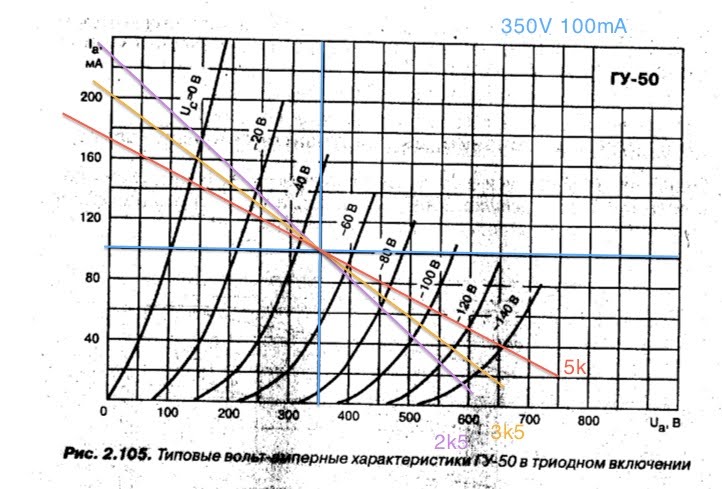

Have you looked at RS1003 (SRS551) tubes as an option? May match well with 3k impedance txr. Ale moglia had put up the characteristics on his website.
Similar to F2a, as being long lasting ( 10,000 hrs) . More available if you do search on people who have used this tube
I found spreadspectrum's post that contains superimposed curves for 300B, KT88 in triode and KT88 with plate to grid feedback. The plate to grid feedback curves best the linearity of the 300B.

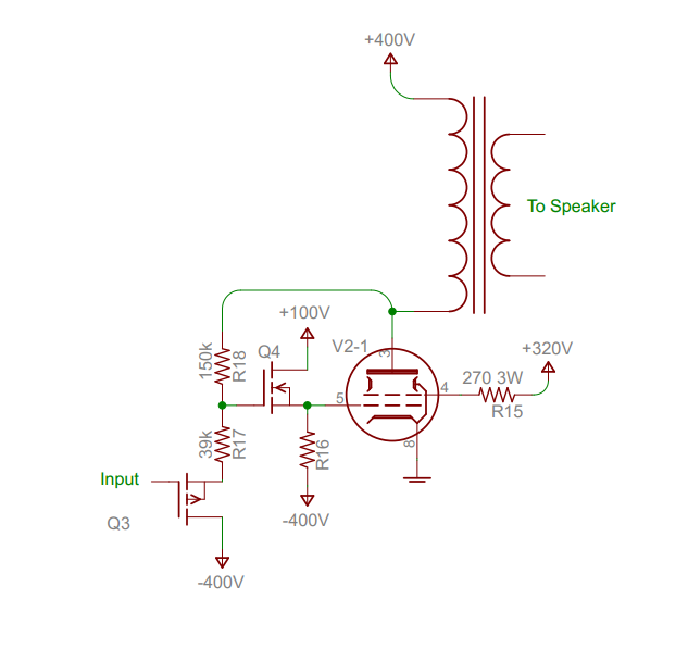

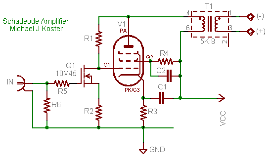

Ah yes. The poorly named and often maligned "anode follower" (or "plate follower").
I was thinking of making a line stage using a 6SN7 with plate-grid feedback to reduce its gain to about 2X and its Zout to less than 1k ohms. Why not do that with an output stage, right?
Does anyone remember Michael Koster's 'Schadeode', with a depletion mode MOSFET as the input stage, DC coupled to a 6L6GC output, with a 100k feedback resistor acting as the drain load resistor for the MOSFET, completing the plate-grid feedback around the 6L6? I threw it into LTspice and it performs pretty spectacularly. This is the first drawing, I think. It was refined later, but I can't find the later posts...
