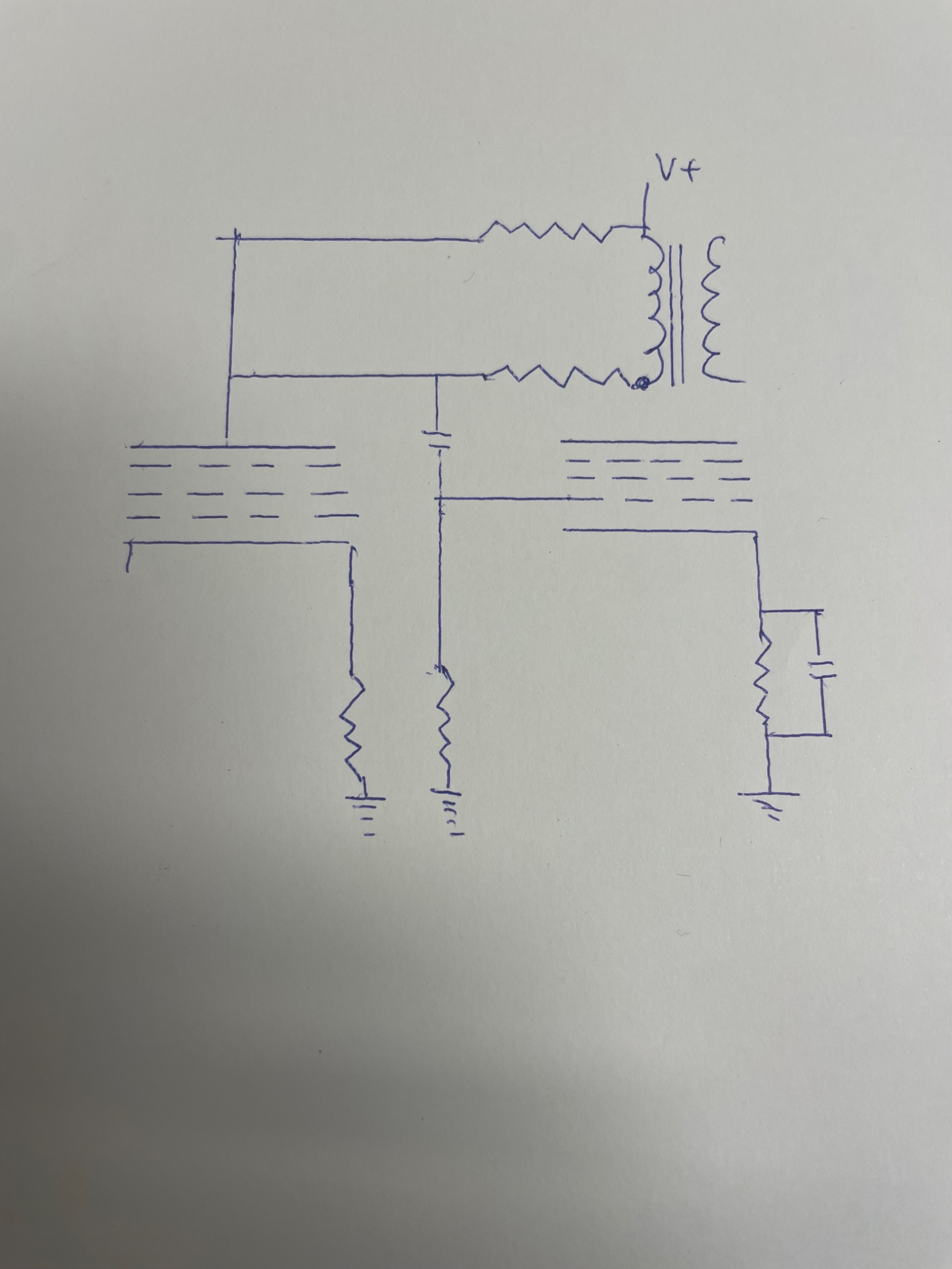

Apply 10-20% plate to grid feedback to lower the internal resistance. a pentode with unbypassed cathode resistor as driver (e282F,12gn7a...many high gm pentodes to choose from)
http://www.r-type.org/pdfs/s11e12.pdf
What were the drive requirements?
When You see written E282F or 12GN7 as drivers - that are high gain & high current requirments me thinks.
