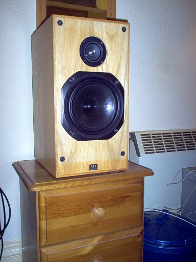

I'm just having a bit of fun here. 🙂

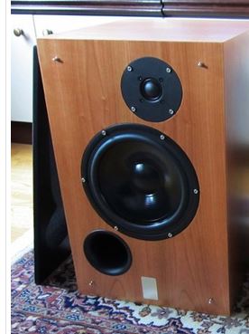

Mr. Joachim Gerhard is one of the finest thinkers in the World on speakers IMO.
Below is his Sonics Arkadia speaker. SEAS CA22RNX and some £30 SEAS 27mm tweeter. Simple second-order crossover. Reflex around 35L and 2.5kHz crossover.
I do stuff like this too, with £6 Monacor HT-22 tweeters. Why pay more?

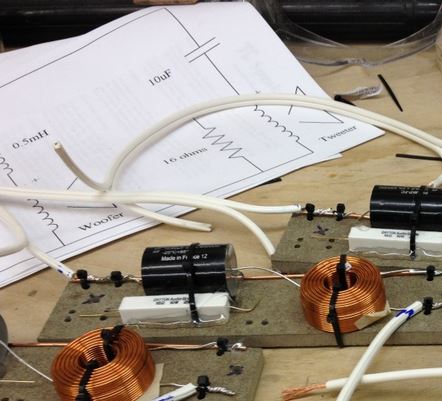

Usually with an 8" PA speaker you cross it at 2.5kHz with a bass filter of 2mH series and 10uF shunt.
Then just blend it in with a a 2.5kHz crossover second-order tweeter filter. 3.3uF and 0.3mH usually does it. Plus attenuation. Not rocket science.
