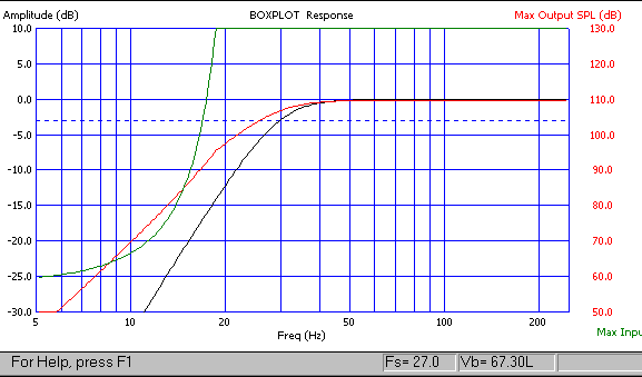

The following plot shows a Peerless 260 in a box the same volume as yours. However, the box is tuned to 27 Hz. See how flat the response is. The black line is the speaker's response.
Now, here is the exact same speaker, in the exact same volume box as yours tuned to about 110 Hz-the same frequency that the hole in the back of your speaker tunes your speaker to. Remember, the black line is the speaker's response. At it's height, the speaker's response at 1 watt per meter goes well over 10 dB above normal!!
As tuned, your speaker is super-efficient in the midbass-80 Hz to 220 Hz region. It has no deep bass.

Here is the chart of the same speaker above tuned to 110 Hz:
