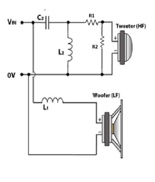

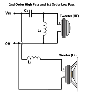

While the experts are evolving the original circuit, I'm conscious of the fact that the tweeter specs recommend a 2nd order crossover at 3,500 Hz.
Since Ron has already purchased 0.45 mH inductors, I offer him the following crossover circuit that will get him up and going until such times as he acquires the necessary crossover design facilities - should he wish to go down that route.
C2 = 4.7 uF, L2 = 0.45 mH and L1 = 0.45 mH.
Between L2 and the tweeter I would add the attenuating resistors that I described in post #25 (R series = 1.8 ohm & R parallel = 15 ohm).
I am aware that the response is likely to be far from optimal, but at least the tweeter will be safe from low frequency overload.
This is what I think you are describing (with some help from MS Paint) 🙂
C2 = 4.7 uF, L2 = 0.45 mH, L1 = 0.45 mH, R1 = 3 ohm, R2 = 15 ohm.

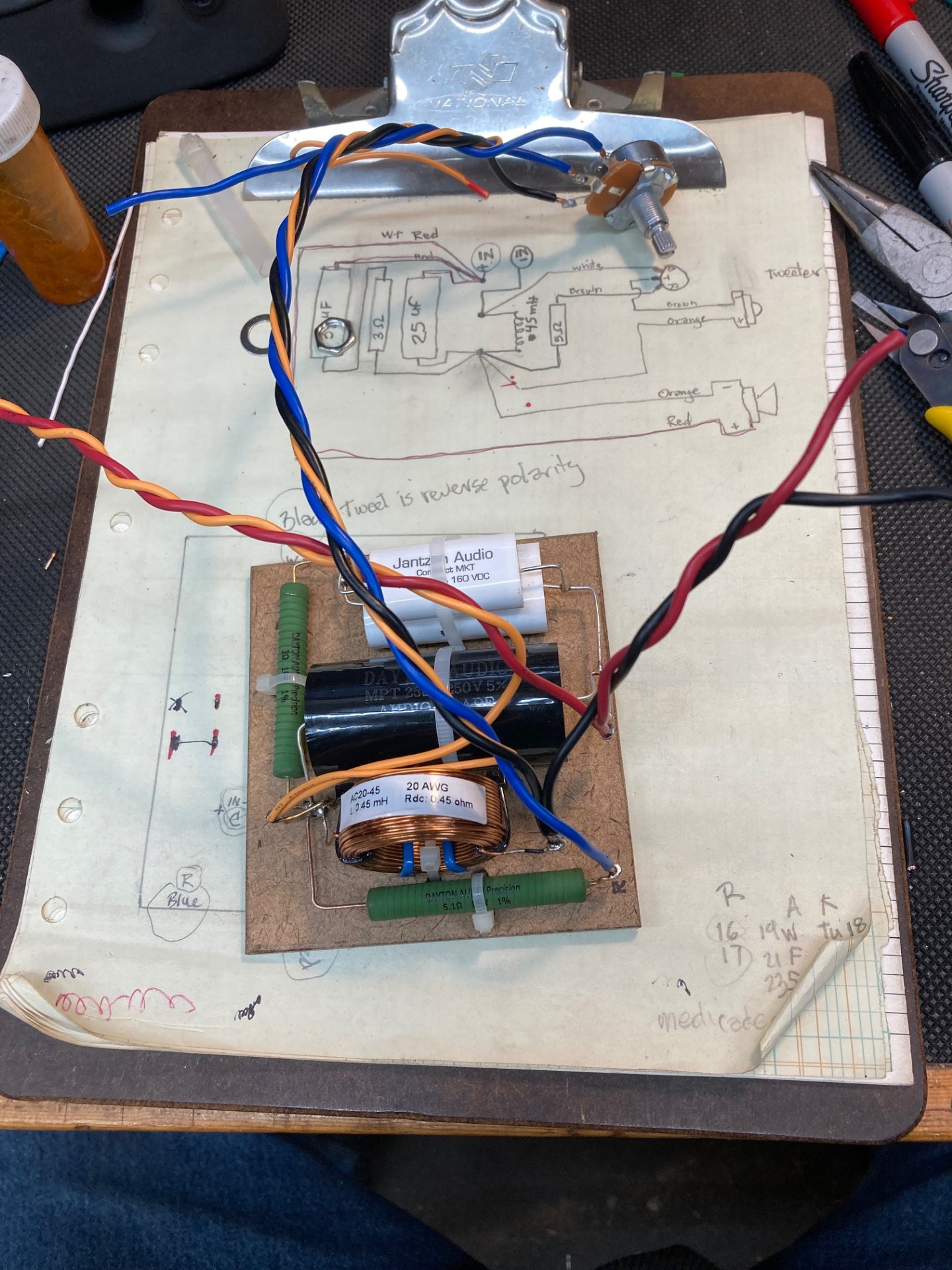

It is true that I don't have tools nor the expertise to design/redesign a crossover network. I also have limited time available to delve into this very interesting topic. I recently had a friend share an observation that I have too many projects and need to concentrate on a few less. Good advice I think.
As it stands now I have the original box and tweeter. The PE woofers has replaced the destroyed and NLA ADC woofers. The PE drivers were chosen based solely on their 8 ohm rating and ability to work in a .2cf sealed box. I know now that there is much more to selecting drivers.
So I was thinking... The original speaker designer must have done an ok job because the speakers did sound good. Since I don't possess the tools to do a redesign, maybe Its best just to replicate the original, knowing the original crossover did work with the original tweeter (and noting most of the components are in the tweeter circuit).

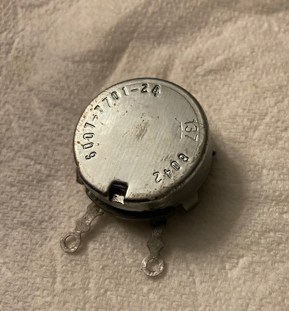

Everyone here has been very helpful in identifying the components. The only part left for me to identify is the variable resistor. I compared the two that I have the only number they have in common is 137 which is underlined. Can someone please direct me to a suitable replacement? The ones I've searched for are all over the place in their resistance values.
This is what I think you are describing...
That's it Ron, well drawn.
Just one amendment: R1 = 1.8 ohm.
Remember the above circuit is merely a seat of the pants suggestion and may require some tweaking. You could even try it without the bass inductor.

Fair enough, but remember that the original series crossover is not set up to match your replacement woofer. Hence, tweaking would be involved here too.
The original crossover is a series crossover (as so ably described by AllenB) and not a parallel crossover like the one I have previously illustrated.
Attached is the basic configuration of a 1st order series crossover (the tweeter is at the top):
Each crossover component is in series with one driver and in parallel with the other, requiring the characteristics of both drivers to be taken into consideration.

I sorry to report that I was unable to get any useful info from the variable resistor.
I tested (200 scale) between the center lug and one of the outer lugs while turning the knob. I would expect gradually increasing resistance as I moved the sweep away from the lug I was clipped to. This did not happen . Readings jumped around from a low of 15 to a high of 125 independent of the knobs position. i.e. as being turned it would read 25, 97, 15, 115, 36, 84... etc.
I then tested (200 scale) between the two outer lugs. This gave a steady reading of 40.

Thanks but I already ordered the 5w pot. I ordered both 25 ohm and 50 ohm components. I reason I also selected the 25 ohm item is it has a Knurled Slotted Shaft like the original. I need this for the knob to fit into a recessed hole. I did look at the higher wattage pots but they are too wide and will not fit in the original cabinet location.
As a FYI... I measured the end-to-end resistance of the pot that was in the second speaker and it measured 2.4 ohms. The first speaker measured at 40 ohms.
The only thing I'm waiting to order is the 3.0 ohm resistors. The 'audio grade' ones I want are on back order.
I'm not sure what's going on with the measurements there. Did the two pots have identical markings?
On considering the circuit, I suspect that a 25 ohm pot may actually be the better choice.
I await news of the outcome.
The pots had different markings. Additionally, each speaker's crossover resistors were different (brown round vs white sand cast), and one speaker had soldered connections with the other's connections being crimped. Note that the resistors were burnt and any identification marks were not readable on the brown ones. They resembled Mills, but I don't know for sure.
