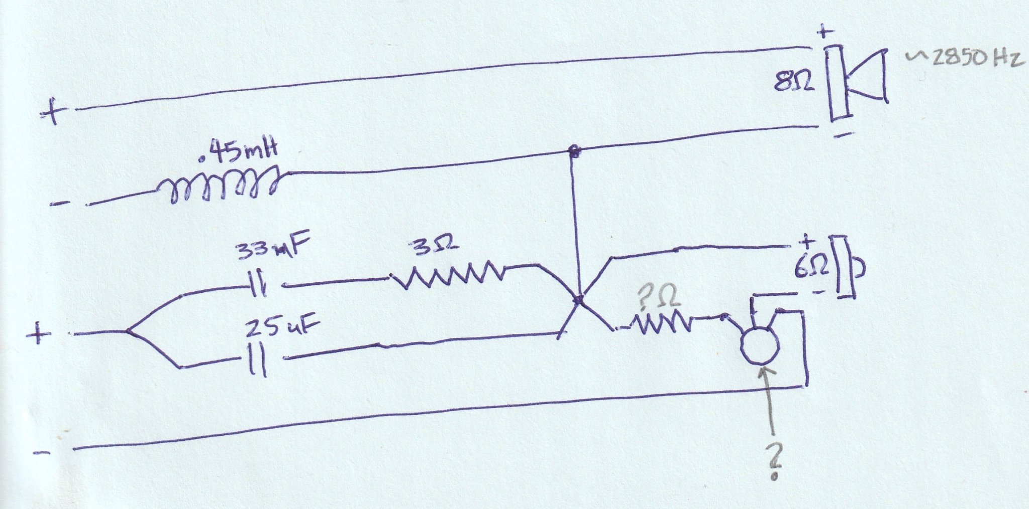

Please excuse my low tech crossover drawing. I drew the woofer circuit and tweeter circuit separately to make it easier for me.
(Notes: The small resistor (5 Watt?) just before the Lpad measures 5.3 ohms on one speaker and 5.6 on the other. I cand find any info on the Lpad)

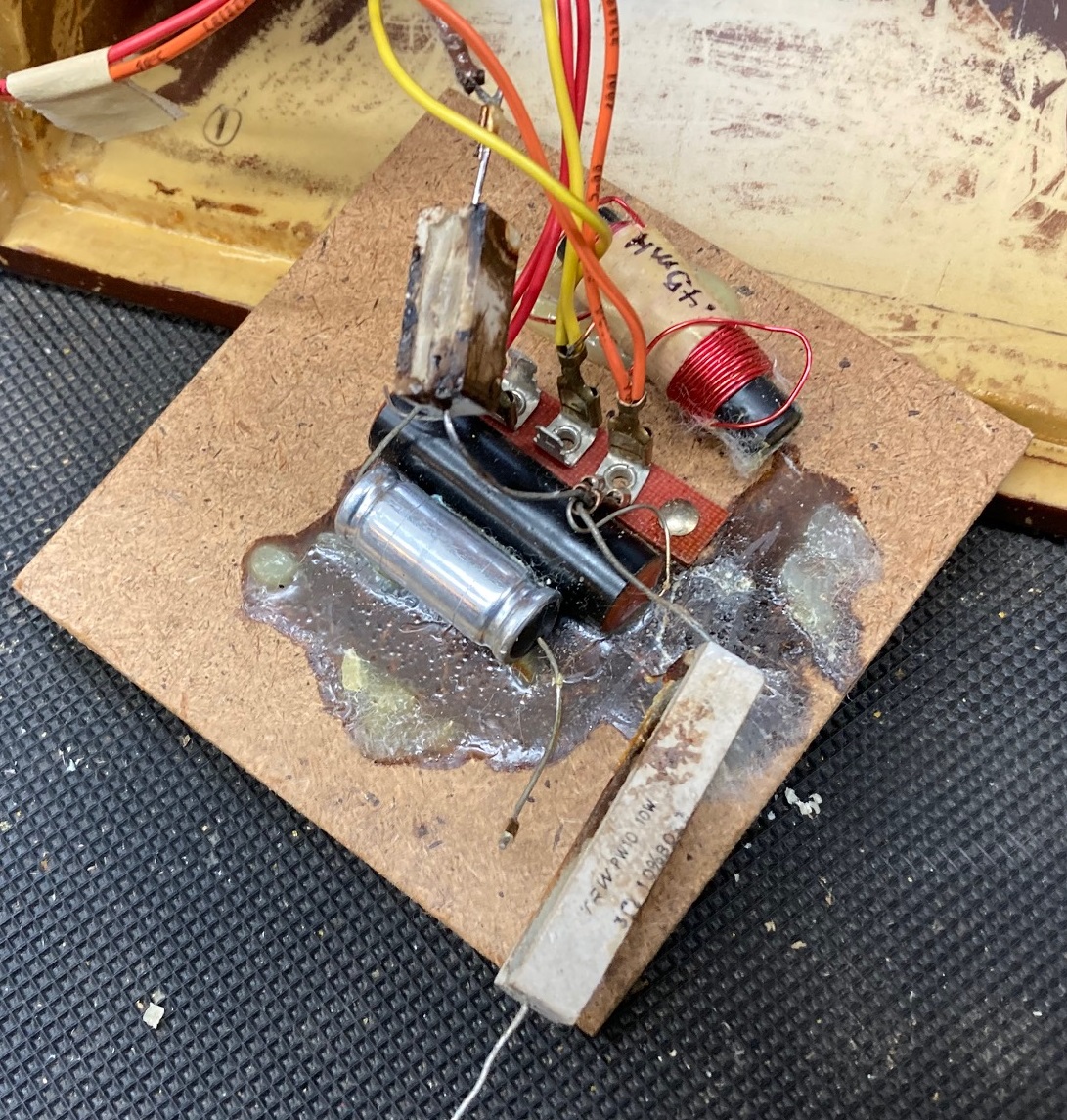

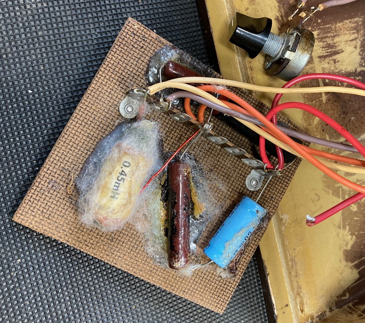

Speaker 1 crossover:
Speaker 2 crossover:

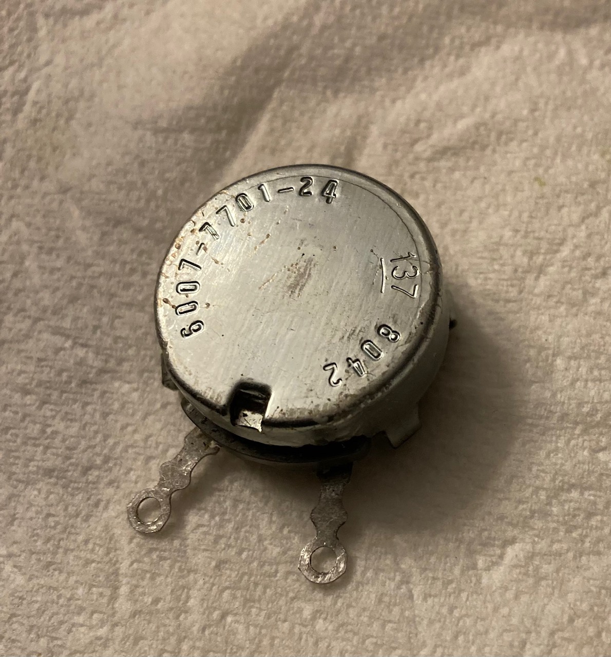

Melted Lpad:

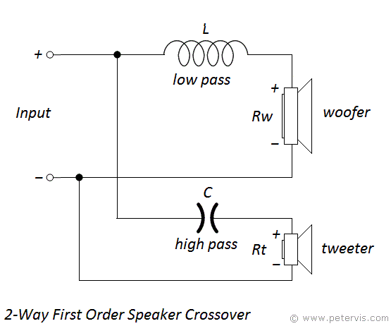

Hi Ron! I doubt if your crossover schematic is correct. The physical parts layout is hard to follow, so I think it may be best to simplify it.
For a simple 1st order crossover at 2,750 Hz, retain the 0.45 mH in series with the 8 ohm woofer and put a 10 uF film capacitor in series with the tweeter (assuming it to have a nominal impedance of 6 ohm).
If the tweeter is too loud, try putting the 3 ohm resistor in front of the capacitor (amplifier side) - add more resistance if you need more attenuation.
P.S. Your photos of the level control appear to show only two connecting tags, which would mean it was used as a variable resistor rather than an L pad.

Here's the simplified crossover circuit. The attenuating resistor(s) would be placed to the left of, and in series with, the capacitor.
If nothing else, it's a good starting point for experimentation.

It looks likely that the high wattage 3 ohm and low wattage 5.6 ohm resistors were wired as a fixed L pad attenuator as shown in the attachment.
R1 = 3 ohm; R2 = 5.6 ohm
This fixed L pad arrangement would be placed after the capacitor and in front of the tweeter and would give about 6 dB of attenuation with the 6 ohm tweeter.
The variable resistor control was probably wired in such a way as to fine tune the attenuation, but we can simply take it out of the equation.

That was my first impression as well. In cases like this it helps to consider whether it is a series crossover.I doubt if your crossover schematic is correct.

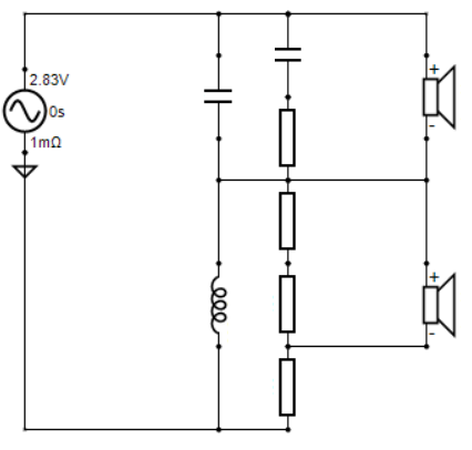

What do you think of this?

A simple series crossover does do first order and higher. This depends on the Q of those two components. While it's typically not more than 9dB/oct, it can be much higher.
It certainly does explain why there are two capacitors coming off the positive terminal in Ron's sketch!😎
Whereas I was simply suggesting a workable parallel version - unfortunately with only 6 dB electrical slope on both drivers.
If you were to identify the value of each of the components in your diagram, I'm sure that would be most helpful to Ron in reconstructing the crossover using new components where necessary.
I suppose a potential fly in the crossover ointment is that the woofer currently being used will have different characteristics to the original?

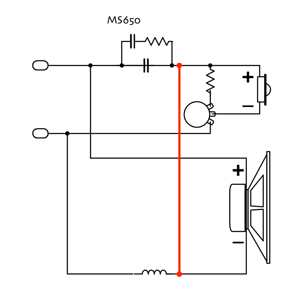

I have redraw the XO in a more convential diagram.
1st order with some shaping and attentuation on the tweeter. The red connection is likely in error.

The way forward depends on Ron's equipment, experience and willingness to be accurate. Yes, we could obtain values and impedance data and reverse engineer the old crossover.If you were to identify the value of each of the components in your diagram,
On the other hand we could just make comparisons to the old and new woofer. The easiest way would be to simply fit the woofer and try to adjust the tweeter with knowledge of the potentiometer.
The third option is to begin from scratch. There would be no harm in moving to a regular (not series) crossover if that's considered simpler.
Your version certainly looks faithful to Ron's sketch, Dave, and highlights his mistaken connection.
@Ron1200 I think you will be able to follow Dave's schematic with ease. If you wish to simplify the design as you stated in post #1, then the level control and the 5.6 ohm resistor in line with it can be removed. The tweeter negative terminal would then be wired directly to the negative input terminal.
The tweeter will then run unattenuated. If it proves to be too loud it can be attenuated in the fashion illustrated in post #6.
P.S. I suspect that this information is sufficient and that you won't want to go down the path of designing a new crossover from scratch.
Ron's, Dave's and mine are identical if I'm not mistaken. Do you see an error?Your version certainly looks faithful to Ron's sketch, Dave, and highlights his mistaken connection.
