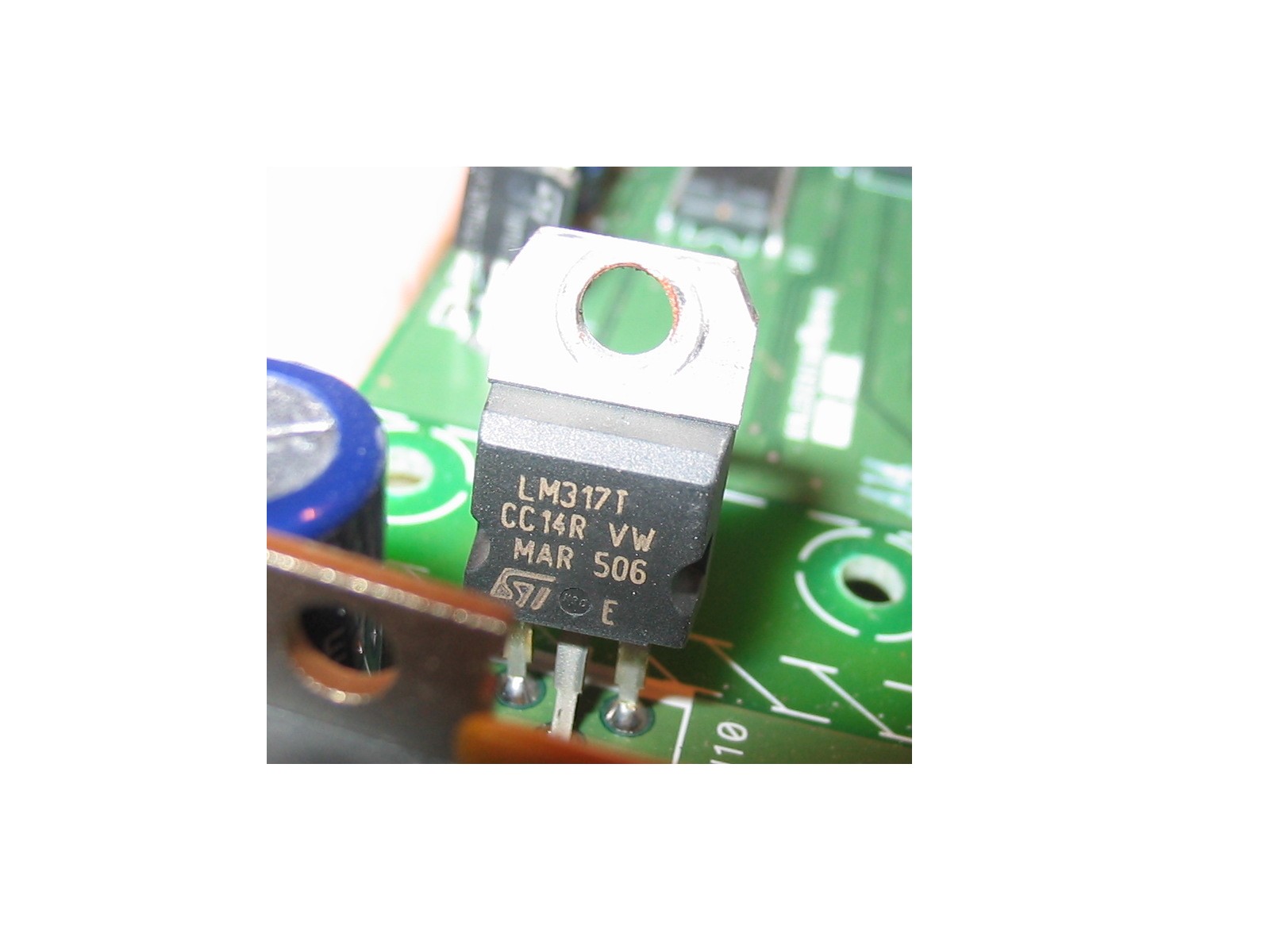

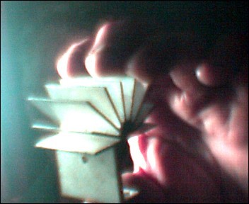

Yes indeed wall-warts are an engineering disaster waiting to happen.
I will reiterate heat and overloads are the killer of WWs'.
When you design a device to the lowest common denominator you have a device that performs at the lowest level.
The designers wrap up these things in a glued up plastic case & depend on internal "overload protection" to save the device.
The caveat "Unplug when not in use" is roundly ignored and these devices gather dust being plugged into the wall 24/7.....365.
When you peer into ANY device & see THIS three pin device, without THIS or similar heatsink........figure the designer is a flake.
