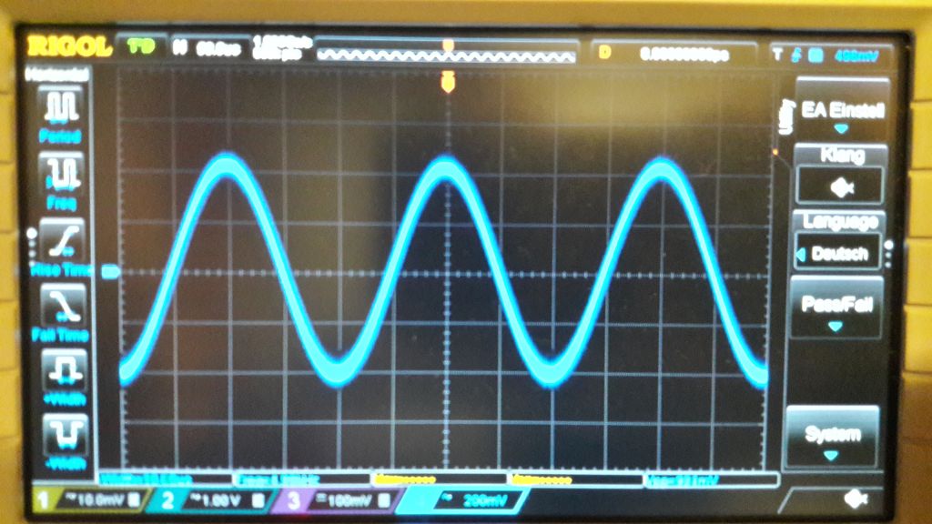

strange signal after opamp with more input voltage?...
Hi
normally i do m frequency response with 400mVrms but its not possible because the signal gets deformated.
input is 300mVrms :
pic 1
measurement at the output of the first opamp pin 1 after the 10µF input cap
deformation in the negative sine wave.

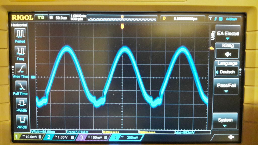

pic 2
measurement at the output of the first opamp pin 7 - its after the opamp 1 so its inverted and the deformation is not in the negative sine - its in the positive sine

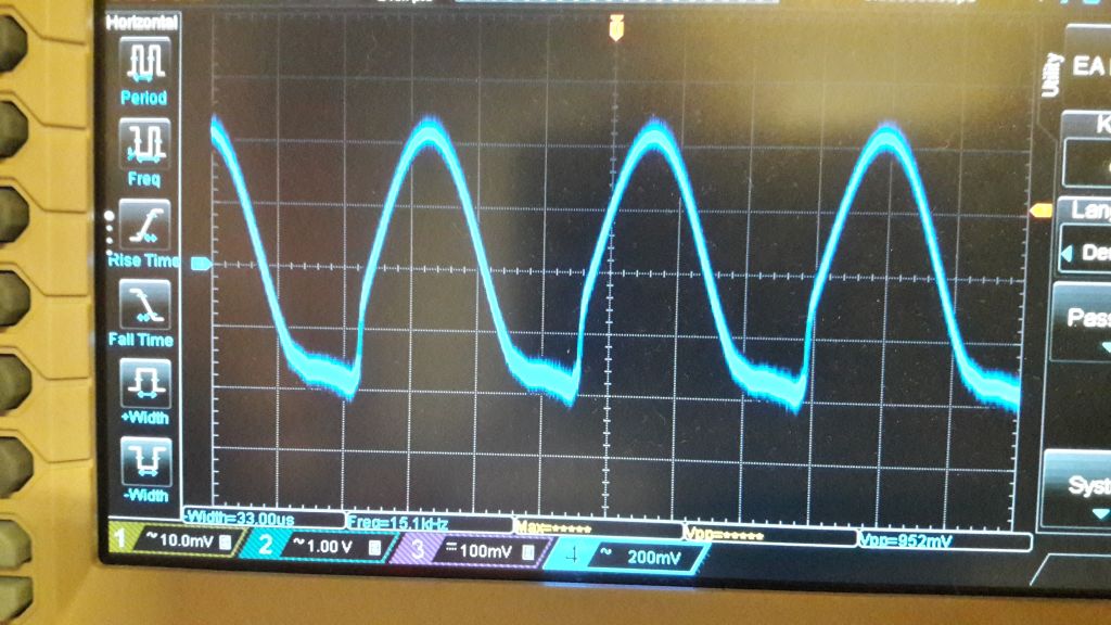

pic 3
measurement after the input caps- so signal is ok. i try up to 500mVrms and the signal form is ok.

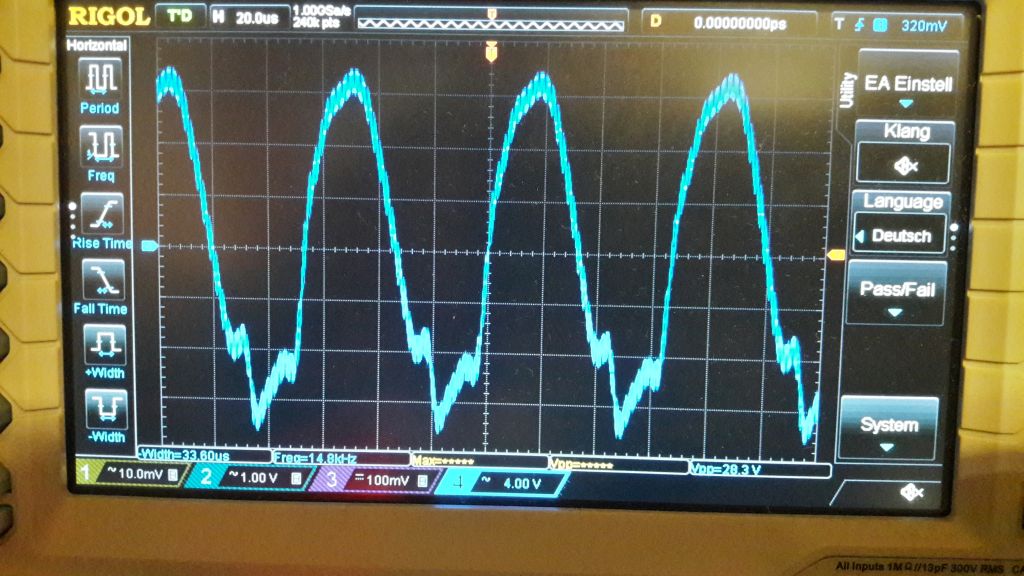

pic 4
signal at 15kHz is harder deformation
any ideas?
chris

output terminal
measurement at the output terminal.. both L+R have the same signal form.
at the other board i had´t this signal.
any constructive ideas??

obviously you measured with ac-coupling. Whenever s.t. distorts asymmetrically it is a good idea to measure with dc coupling to see whether the bias voltage is correct or not.
Another hint: When you have found the first occurence of a failure, here at the first OPA-output, there is no point in investigating the following stages, these will not "autocorrect" any preceeding error.

I was getting the same type of glitching on both + and - peaks of the waveform when I fitted the pffb components to my pcb.. it turned out the output filter inductors were electromagnetically inducing pulses into the pffb feedback tracks on the underside of the board so I ditched my pffb circuit until I do revision 3 (if that ever happens lol).

If you measure DC coupled you see the DC bias as well, that is the DC voltage of the OPA output where the AC signal is centered. If it distorts on the neg excursion possibly this bias is to close to neg supply voltage.
The best option seems to me if you measure the DC voltage of each OPA pin (1..8) with a multimeter, w/o any AC input and show the results here.
In that case OPA pins 1-3 and 4-7 should be centered around +14V

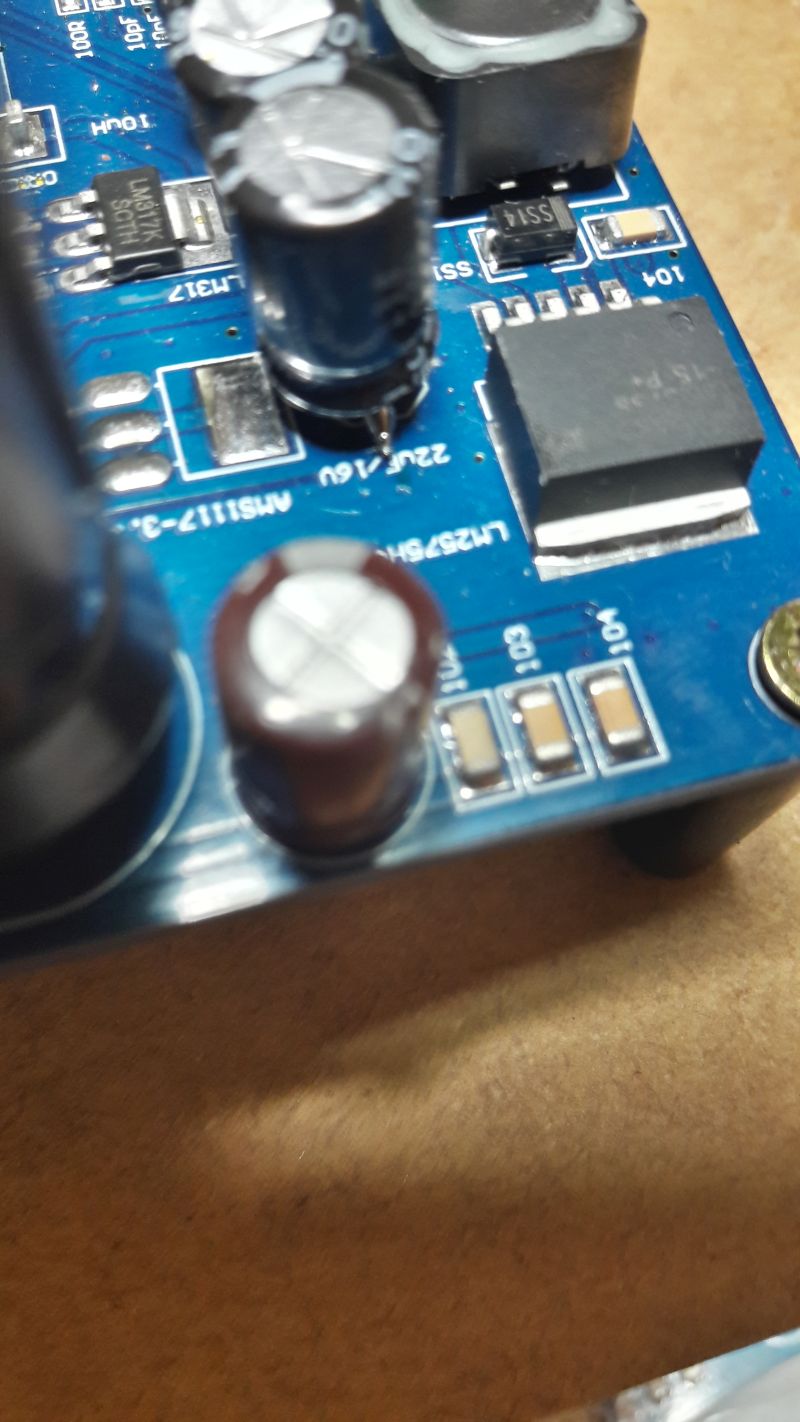

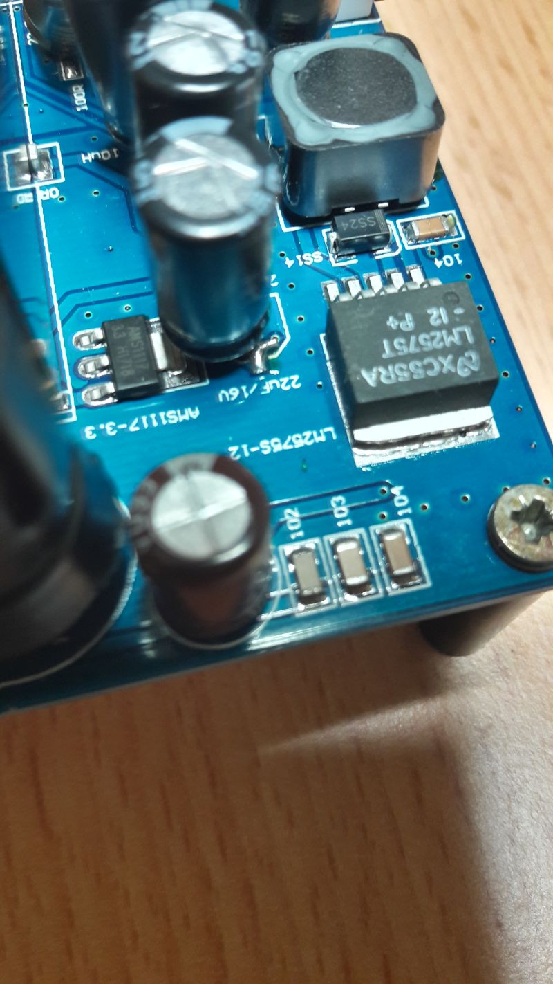

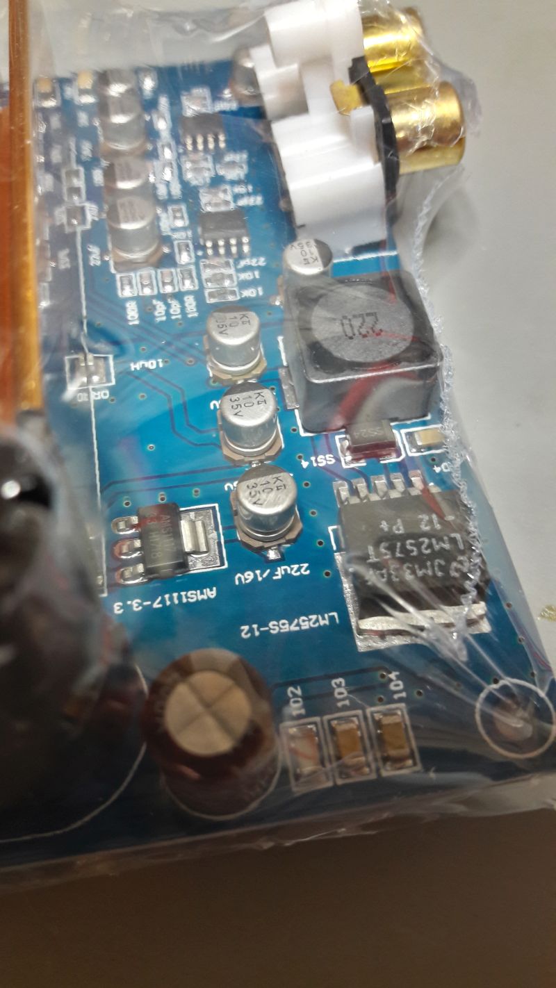

additionally i discover a other version of blue board (blue V2)
V1
at the old board its the LM2575S with the LM317 an the place for AMS117-3,3 was empty
V2
now its other way round
LM2575T -12 - Set to 12,06 Volt - no LM317 but the AMS117-3,3 is on board
pic 1 old board -version 1
pic 2 new board - original packed blue V2
pic 3 new board -blue V2- my AMP5 with the muse input caps
so there is a small improvement - no setup of LM317 is needed😉

at the blue boards with LM2575S and LM317 with out changes i measure 12,75 V+ at the LM317 --> opamps V+
measured with scope/DC setting
DC with Scope shows OPA Voltage at pin 1,2,3 is PIN 5,7 = 6,37V
here is the same
PIN 6 is not measurable --> Amp switch off if I put the probe there !!!????
fault LED
