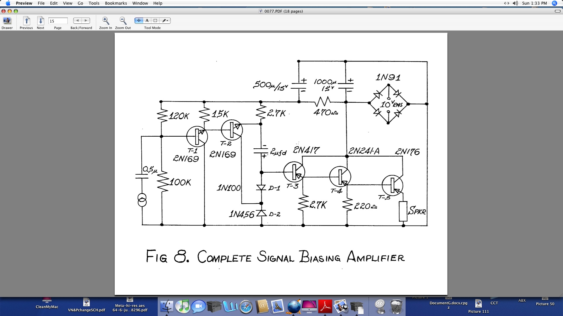

Here is the schematic that Heyser published in an AES preprint in 1959. (091)
Are we now supposed to stand in awe in front of this crap?
Yes, it sounds interesting when the voice coil pops out of the
pole plate and stays there as the quiescent state.
A quintuple Darlington, overall. Did he hope he could force it
to get voltage gain from a few stages more?
With a construction like that I understand that feedback
can never work. Since the total beta is the product of
the n betas, gain falls at n* 6 dB/ octave, with the resulting
disaster for the gain margin. Around the 180° somewhere
in the middle of the passband.
I fully accept if someone pulled the emergency brake.
I need a drink now.
Cheers, Gerhard
