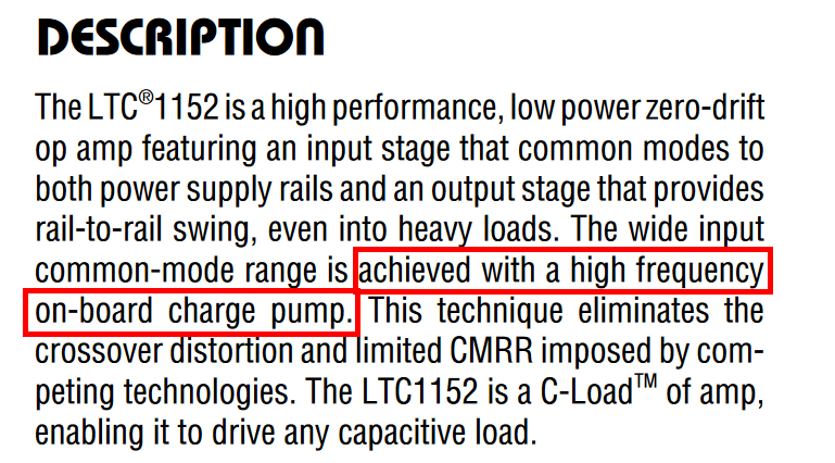

The IC opamps LTC1152, OPA365, MAX4162, ADA4858 all have an on-chip charge pump to generate additional power supplies besides the ones connected to I/O pins. Interestingly, the ADA4858's charge pump output is brought out to an I/O pin, so the board designer can utilize that voltage.

Yep, add the OPA2320 (and OPA2322), the OPA2325, and the OPA2369 to that list. Scott W might be able to add any additional ones from ADI.

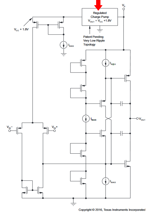

Let's look at Mark's schematic and see the problems with it in regard to quality audio:
1. Cmos is very 1/f noisy.
2. The input topology equally mixes 4 device's noise, or doubles the intrinsic noise, compared to a single device.
3. Who needs a charge pump for audio? Yes, I have used them in other applications, but we usually make a good power supply from the get-go.
4. Single ended output stage drive means lots of extra 2'nd harmonic than what can be gotten from a balanced drive.
5. etc, etc.

Most of these have a specific application or performance need. I can't think of any part that added additional supplies/pins specifically telling the customer to provide extra supplies for higher performance. With most amplifiers now needing rail to rail inputs and outputs there is no benefit to the common technique of having highly regulated different rails for the input stage. Look around here to the discrete DIY designs, many don't get anywhere near the rails due to various popular circuit tricks. Take especially popular output stages some of which need volts of headroom.

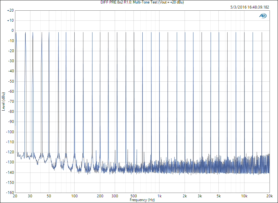

For the 8-legs are bad crowd I would like them to consider the following test plot. This is from a line level pre-amp where you buy the board and solder up yourself. It not only uses nasty little 8-legs, it uses Pro audio nasty little 8-legs from THAT and to add insult to injury it has a SMPS on the same PCB. Must be horrid?
Now I rather like the 32 tone test that AP offers on some models. It's not perfect but as a single test to throw up any oddities I have not seen a better one yet. For this evil horrid unit you can see that any spuria are low enough that they would be below the noise floor of the room. Nothing that could be noticed to deviate from transparent. Additional benefits include 85dB input CMRR even with an unbalanced source and full pro level drive capability. All for £7 worth of silicon. No nice story but superlative performance.
You could build something also transparent for less but not to quite this level of over the top performance.
Note I don't have one of these and its not on my shopping list as my needs are different, but I do like the THAT 1200/1646 combo for input and output duties at line level.
