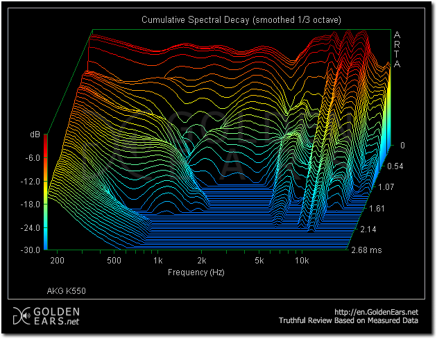

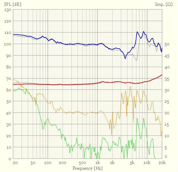

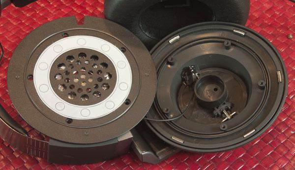

Attached are the actual measurements that I went and looked at.
I think they speak for themselves and speak volumes as to what is going on with them. Now I am not saying that one could not find them good to listen to.
I am saying that IF I showed you a speaker system with this response, you or others would likely got completely bonkers nutz about it.
And, fyi, if you ask are there speakers with dead flat frequency response over essentially the same range? Yes.
Is flat frequency response the main criterion for speakers?
It's perhaps important, but not sufficient alone.
And, fwiw, that ~10dB dip falls approximately where it is easiest to hear sibilence and other nasties, some of which seemingly are produced by opamps and other types of circuits. So, that's a good place for the dip, a built in "de-esser" in effect.
Btw during the search, I notice this seems to be a design goal to some extent, or design artifact of many brands and models, since a whole lot seem to have a dip in this range too.
Bottom line, based on the "measurements" - which you like to cite so often, eh? - I rather doubt that this set up is good enough to be able for anyone to discern all manner of things of the sort that are being discussed and asserted here.
But I do appreciate you saying what ur running - many here are afraid to do so, since the "measurements" might reveal that their experience/system simply isn't "up to it".

As for the measurements, I'm not one of the numerologists. I don't look at them numbers other than to confirm that there isn't any glaring issue with the equipment I'm looking at.
You won't get anywhere with scrutinizing headphones frequency response charts. It has been decided long time ago that flat <> pleasant. Plus there isn't any standardized, largely agreed upon measurement method. Just go an try them, there ain't any better alternative.
P.S. btw that dip doesn't have any de-essing effect. the k550 is actually slightly sibilant and sparkling when compared with the approved by golden ears sennheisers. And that just adds to my enjoyment, since I don't have to make efforts to understand the lyrics or to aurally "squint" in order to distinguish the instruments.

The issue with those phones isn't "flatness" it's (among other things) the 10dB dip, and the peak thereafter, and the ringing shown on the waterfall...

I don't see much wrong with these headphones, nor do they look too nasty a load. Not sure what sort of buffers the listed equipment have, but it's probably fine.

Coming back to headphones measurements. It has been noticed long time ago that the very exact position of the cans in respect to the head/ears/measuring microphone has a large effect on the resulting measurements. It's a completely different proposition to measure them as compared to speakers.
