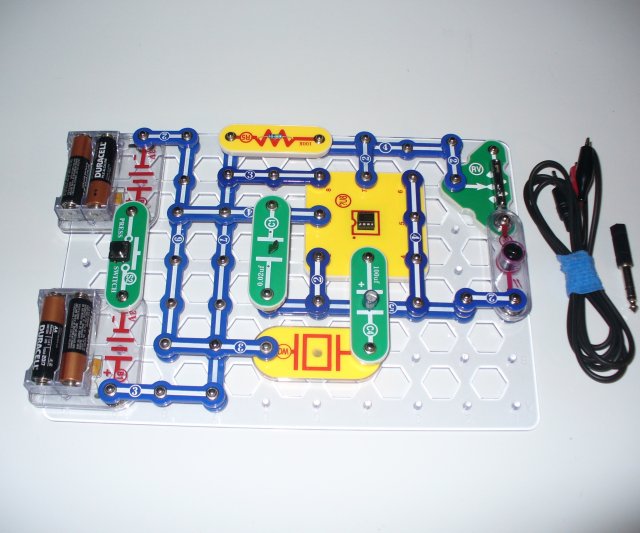

They compensate with brilliant copy:
However, the PhonoBlocks distinguish themselves by including white noise generators --- one for each channel. White noise becomes the input signal and passes thru all stages of the PhonoBlock. You can even use the output of the PhonoBlock as a burn-in signal source for interconnect cables and the rest of your system.
Edit: went back to see if I missed something important. I did. Ground planes are bad, I found out:
The PhonoBlocks addresses the issue of circuit board dielectric in a novel – yet elegantly simple way. All signal carrying conductors are on the top plane of the circuit board. There are no copper conductors on the bottom plane, opposite signal carrying regions. Thus there are no electric fields generated between top and bottom layers. The circuit board dielectric is not exposed to electric fields and there is no undesired storage in circuit board material. The circuit board dielectric is not improved ---------- it is removed. It is as if a window were behind you, instead of in front of you. It is still there, but not in the way of clarity.
