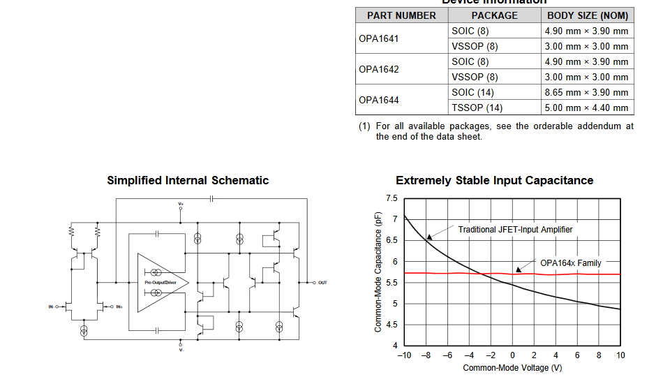

There is no reason any more why one whould use the OPA134. OK, it comes in DIL so we can solder it better by hand. I use it for servo when i make hand samples.
The OPA1641 is better i think. Much lower distortion in the treble and very stable input capaciatance. That is important for transfer linearity when inverted circuitry is used.
It should also have less common mode distortion and it has a very linear output stage.
With one of these you can make an awesome MM phono that is hard to beat.
I use a 2 stage topology though out of other reasons.

PSRR can also make a difference.
But then, the real culprit would be the power supply? which one of the amps manages to mask somehow better due to a higher immunity to its PS shenanigans?
Power supply design is not easy and i am no expert on that. It is not only the rejection of humm and hiss but also a PSU can have distortion.

My current best hypothesis is its down to power supply noise in the main. Power supply noise not originating from the regulators but created by the operation of the output stage being classAB. It follows that the noise is strongly correlated with the signal and has a spectrum more weighted towards HF than the signal itself and dependent on three aspects of the total circuit :
a) the impedance of the power supply
b) the impedance of the load
c) the PSRR of the opamp

I gave it some more thought and I still can't figure how it could "veil" the sound without this also showing in the frequency response. Some intricate form of IM?
OTOH "bright" is pretty straightforward to produce through harmonics.

This can be tricky. If it's high gain (like 20db or more) then all passives around the opamp play a larger roll than you think. Also you don't say what two opamps or if they have the same type of power supply. Is one op amp much higher slew rate than the other? If it is a non inverting circuit and a stopper resister is used then was the same kind and value of stopper resistor used on each?Serious question:

I'm unclear why the IM would need to be 'intricate' ? Simply the addition of HF-weighted correlated noise gives the impression of HF roll-off even with a flat frequency response in my experience.

I'm afraid a large quantity of such noise needs to be generated. Back to our opamps, if they would be doing it to such extents, it would be trivial to measure?
