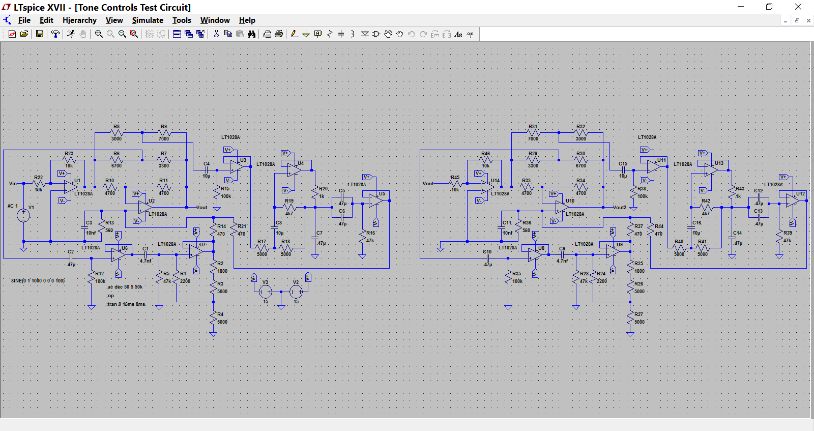

I'm trying to devise a way of allowing (if they exist) some of these differences in opamp sound to be made more audible... something like this......
Anyone remember Doug Selfs precision preamp and its fabulous tone controls ? It uses 6 opamps per channel for the tone section, my version uses 7 because I correct the inverted phase of the tone section. The opamps for bass and treble correction (and the variable turnover frequencies) are only really in circuit when the controls are moved away from centre.
With me so far 🙂
A feature of Dougs design is that the boost and cut response curves are mirror images of each other, something that matters little in practice because you can't use both at the same time...... however 😉
If I make recording with controls set to give a specific response, I should then be able to pass that recorded signal through the chain again with an inverse characteristic and so obtain an original flat response characteristic.
Small variations will not matter. How so ?
They will not matter because you don't get to hear the original recording. All you will hear is the final result of having passed through 7 opamps twice over. You can then hopefully just compare the different opamps.
Sound interesting. I thought so too 😀
No promises at this stage but I'm going to have a little play around. I have got enough new 5532's and 4558's PLUS five new LM4562's.
I thought of doing three runs,
1/ 4558
2/ 5532
3/ I'm not sure so you tell me. Personally I'm thinking using the five 4562's for the input, mixer and treble stages (that's U1, U2 U6 and U7 in the left hand diagram) and also for U3 in the bass. I would retain 5532's for U4 and U5.
I also have 6 new OP275's which might make an interesting comparison.
Interested ?

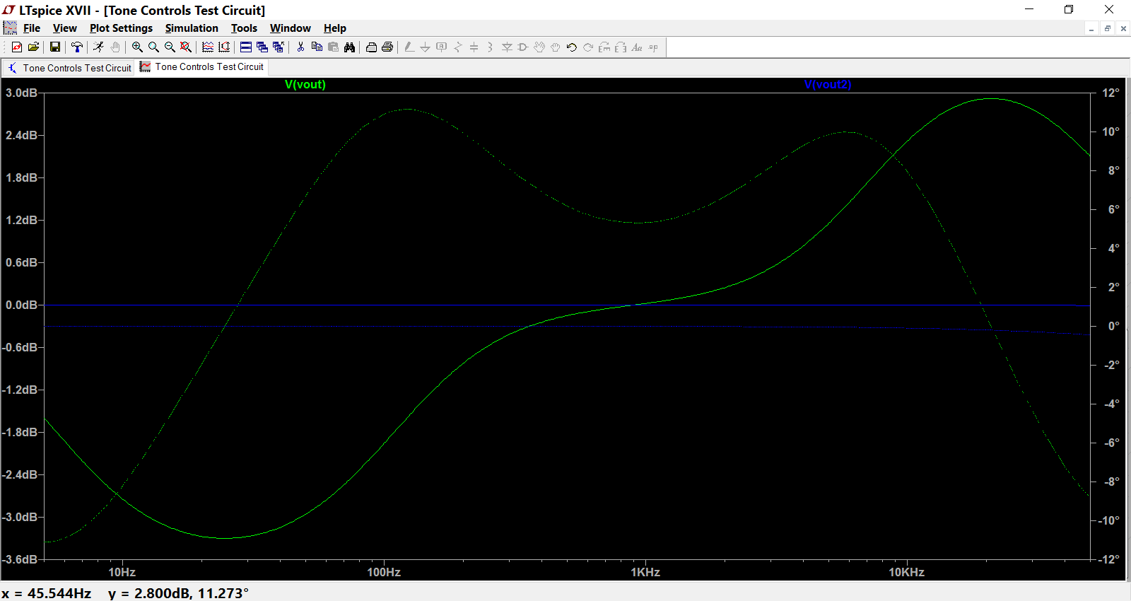

Here is the test set up proposed. The overall response in blue can be seen. The green trace shows the initial treble boost and bass cut applied. The second stage will mirror that giving a flat response overall.
