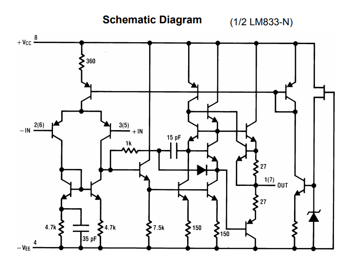

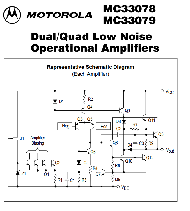

What is the relationship between MC33078 with LM833? The datasheet is I 'think' 99% similar. LM833 is cheaper and easy to find.
The datasheet schematics don't look quite identical to me.
  • Most importantly, the LM833's push-pull output stage includes a PNP transistor to pull down to the negative rail. But the '078's output stage is all-NPN. Q11 pushes and Q12 pulls.
  • The '078 has three capacitors but the '833 only has two.
  • The '078 includes clipping-recovery transistor Q7, which is not present in the '833.

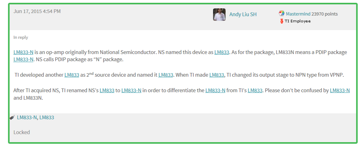

Thank you, Mooly! I did not know that "LM833-N" (N for National) is a different chip with a different datasheet and different internal guts, than "LM833". This latter chip does indeed appear to have the identical dumbed-down-for-customers schematic as the MC33078. IMO it was more than a little bit misleading for TI to give the new die, the same part number as the old.
So the newer 833 is quasi like MC33078 and according to Mooly has much better output drive, which is one of the strength of MC33078 according to nigel.
But how can we identify the newer 833??
