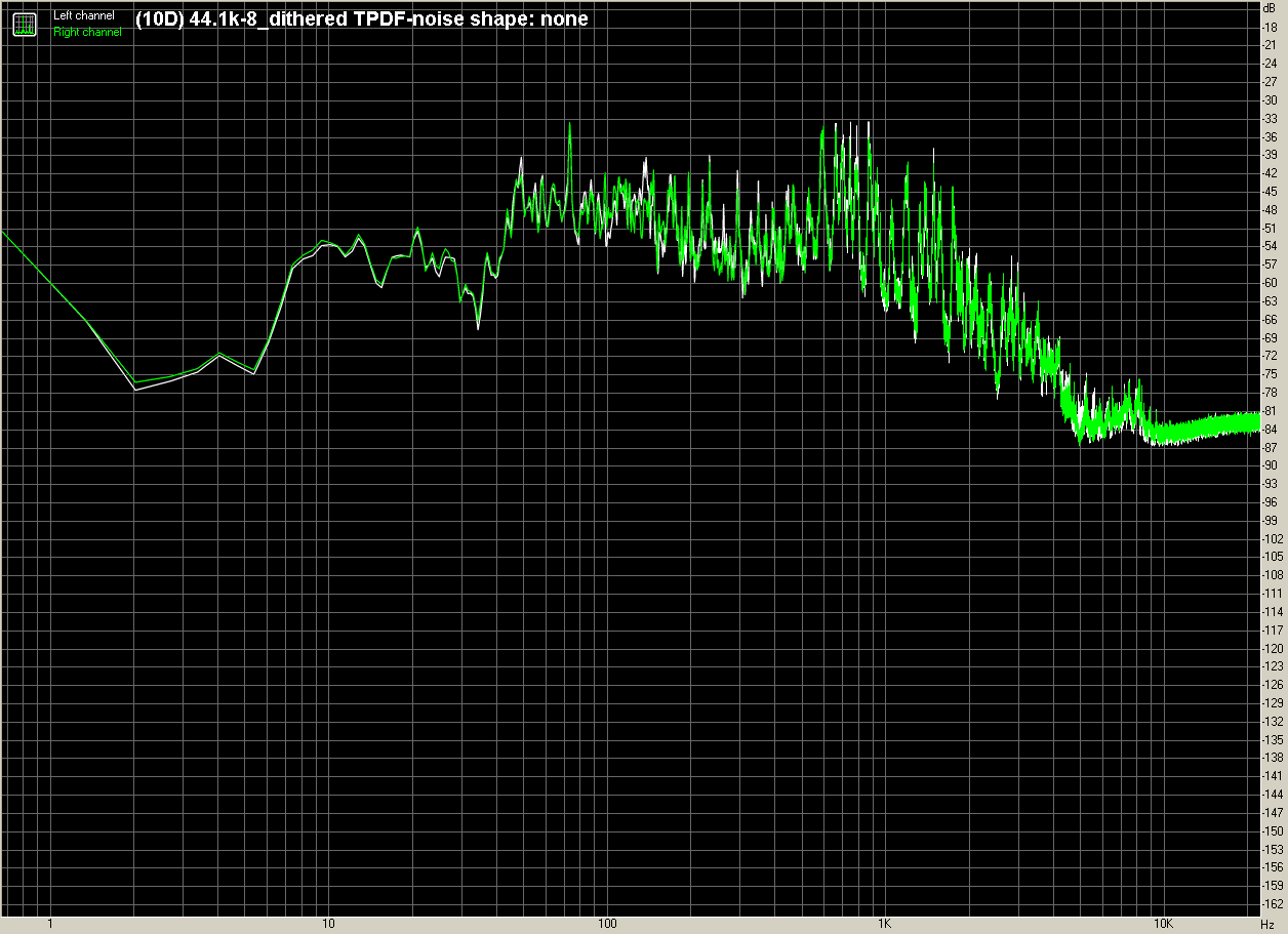

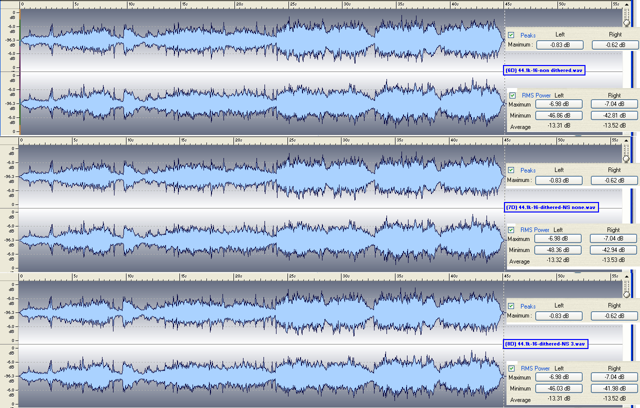

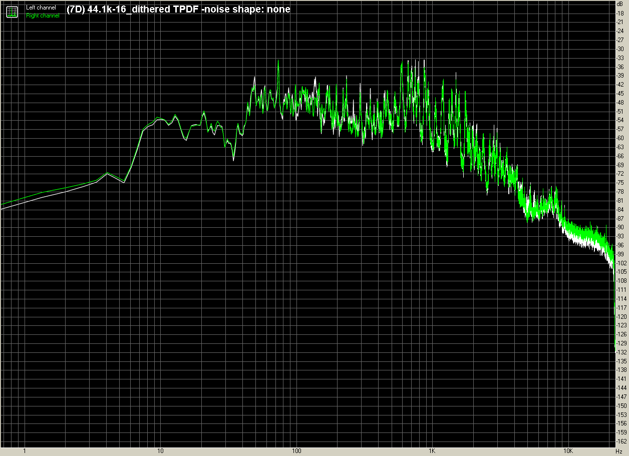

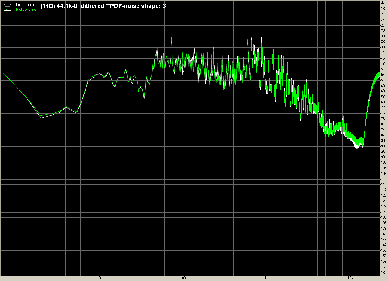

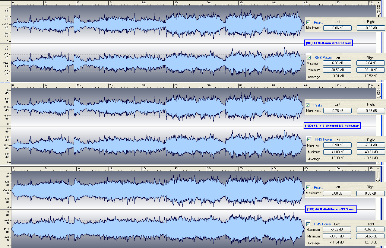

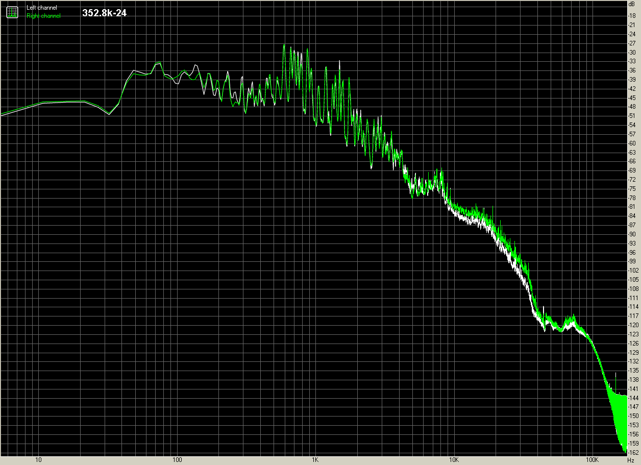

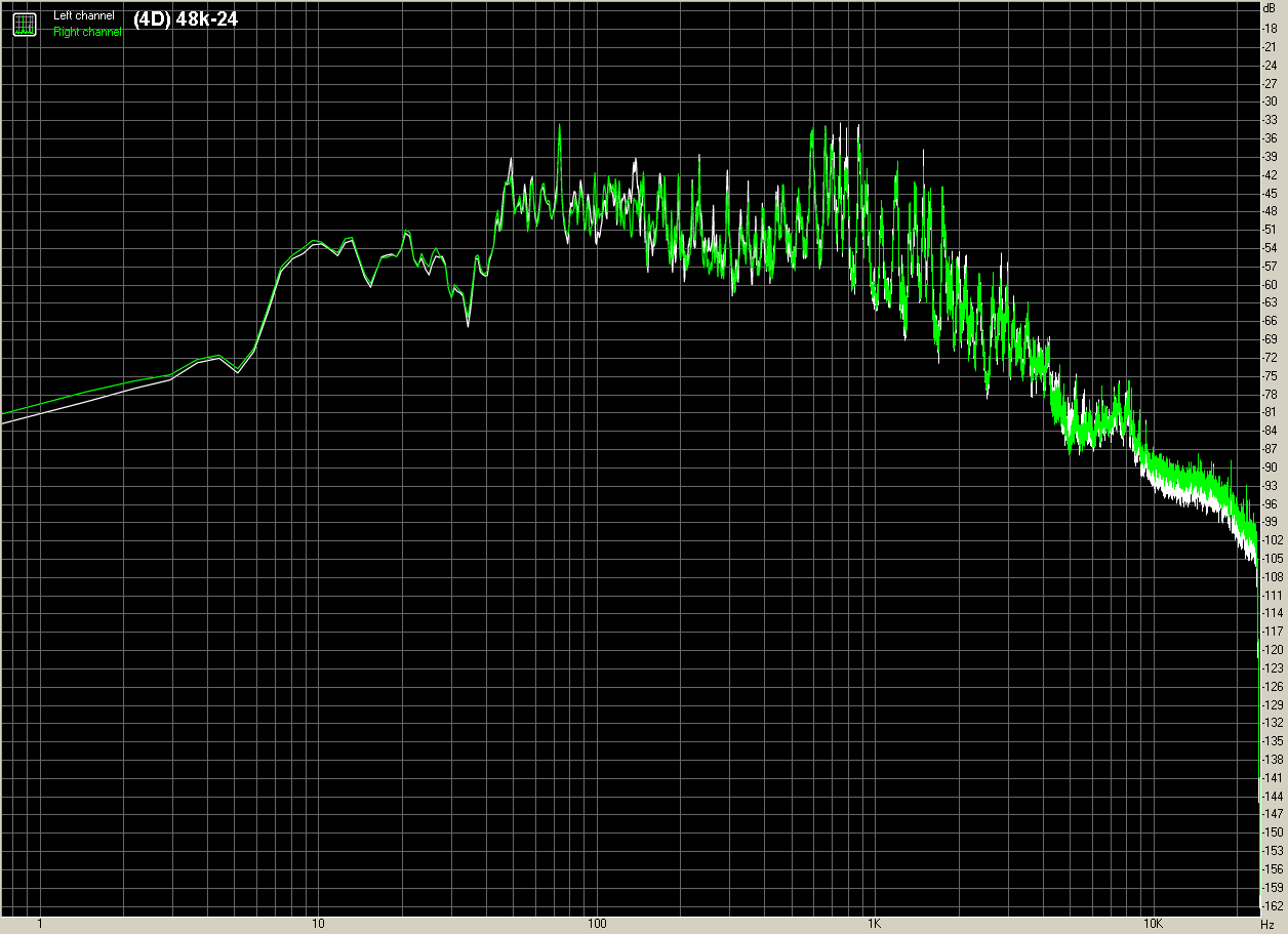

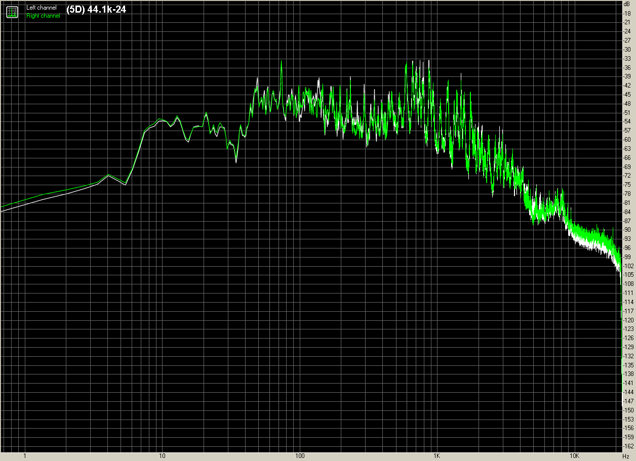

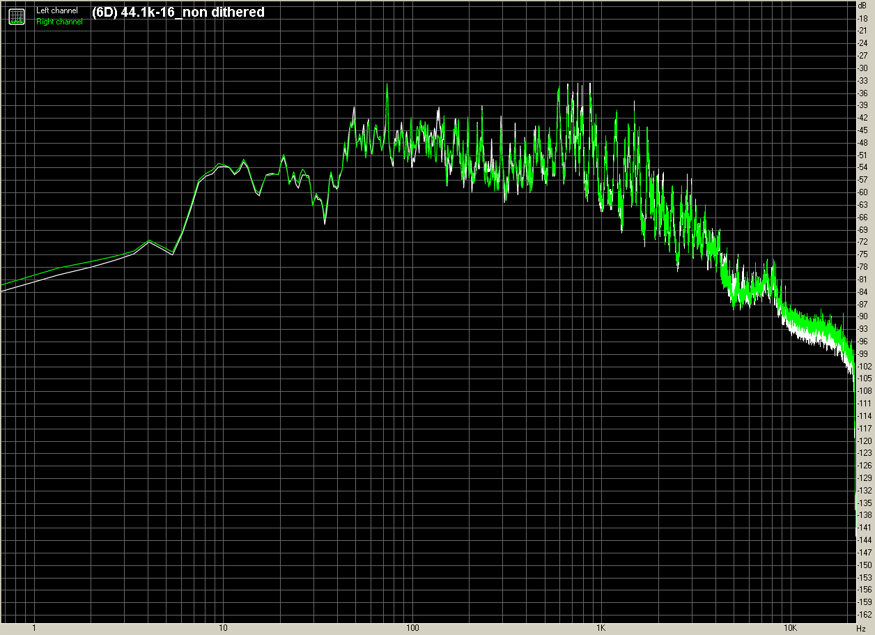

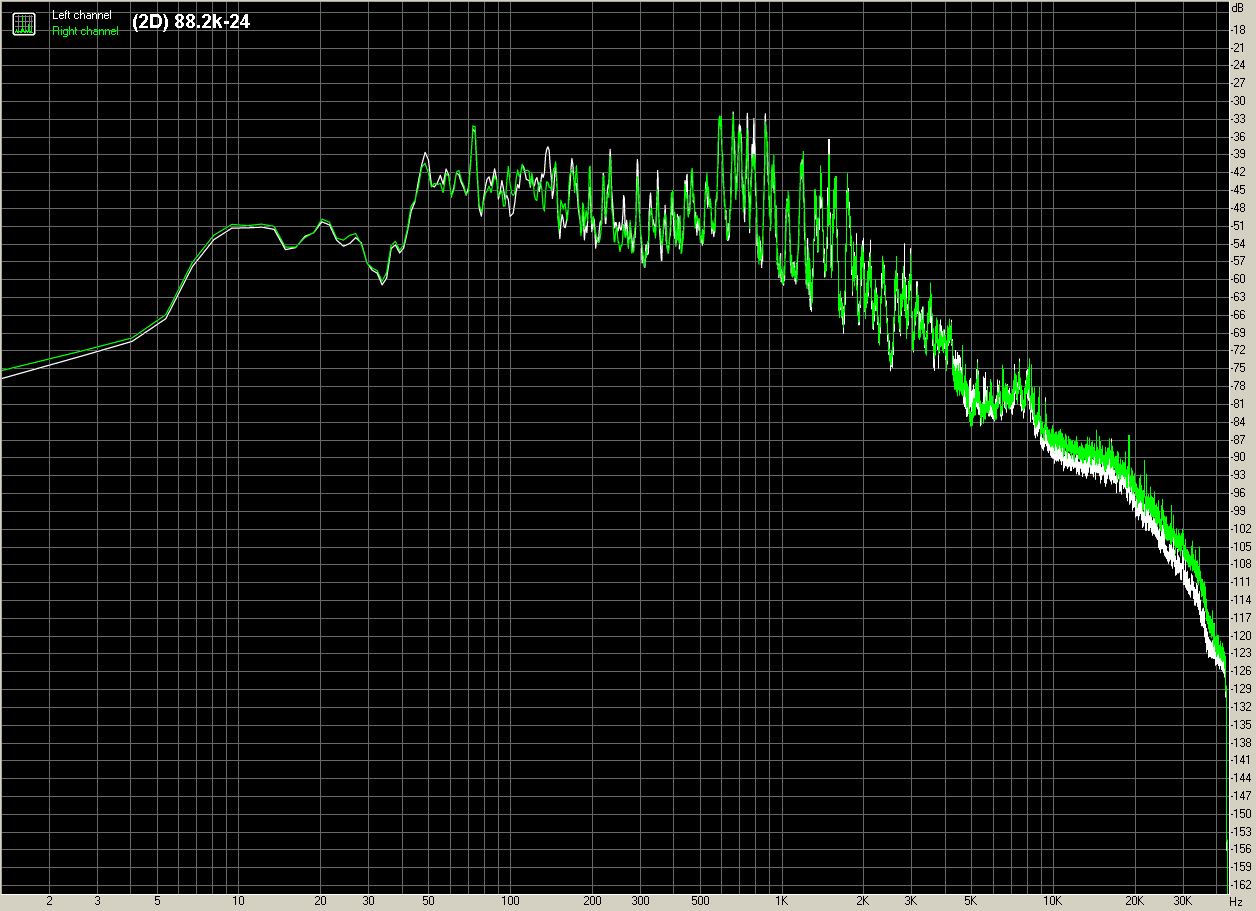

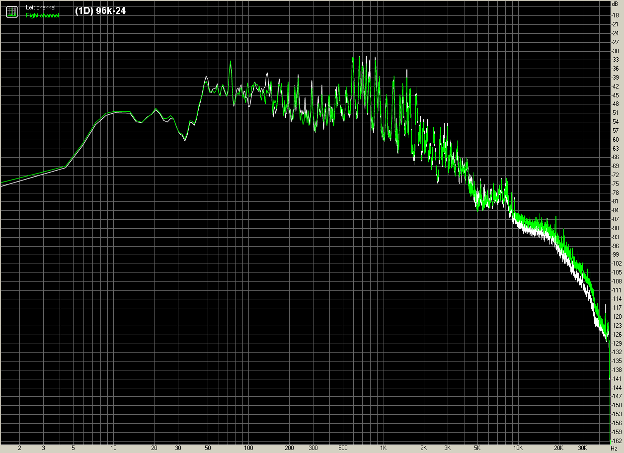

I repeated the exercise, this time the master recording is a high resolution (352.8k/24b) digital recording.
Legal free download “Frode Fjellheim Kyrie Cantus & Frode Fjellheim”, the 6th entry on this very good Download test bench:
http://www.2l.no/hires/
(1) 96k-24
https://www.dropbox.com/s/0l7hk257on2mq48/%281D%29%20Frode%20Fjellheim%20Kyrie%20%20352k%20to%2096k-24.wav?dl=0
(2) 88.2k-24
https://www.dropbox.com/s/k0ymvjxn4vlq2rr/%282D%29%20Frode%20Fjellheim%20Kyrie%20%20352k%20to%2088.2k-24.wav?dl=0
(3) 64k-24
https://www.dropbox.com/s/xc2a9ylu644t0yk/%283D%29%20Frode%20Fjellheim%20Kyrie%20%20352k%20to%2064k-24.wav?dl=0
(4) 48-24
https://www.dropbox.com/s/vvmnzfl1up5ppjs/%284D%29%20Frode%20Fjellheim%20Kyrie%20%20352k%20to%2048-24.wav?dl=0
(5) 44.1k-24
https://www.dropbox.com/s/2oomd2urwxvu7z6/%285%29%20Frode%20Fjellheim%20Kyrie%20%20352k%20to%2044.1k-24.wav?dl=0
(6) 44.1k-16_non dithered
https://www.dropbox.com/s/xcwquftt8sku8e1/%286%29%20Frode%20Fjellheim%20Kyrie%20%20352k%20to%2044.1k-16%20non%20dithered.wav?dl=0
(7) 44.1k-16_dithered TPDF-noise shaping: none
https://www.dropbox.com/s/ar487aolk3o76qt/%287%29%20Frode%20Fjellheim%20Kyrie%20%20352k%20to%2044.1k-16%20dithered%20Noise%20type%202-Noise%20shaping%20None.wav?dl=0
(8) 44.1k-16_dithered TPDF-noise shaping: 3
https://www.dropbox.com/s/ufg81p0y4fbpzcy/%288%29%20Frode%20Fjellheim%20Kyrie%20%20352k%20to%2044.1k-16%20dithered%20Noise%20type%202-Noise%20shaping%203.wav?dl=0
(9) 44.1k-8_non dithered
https://www.dropbox.com/s/n4wt8e55vor2o7v/%289%29%20Frode%20Fjellheim%20Kyrie%20%202L-110_352k%20to%2044.1k-8%20non%20dithered.wav?dl=0
(10) 44.1k-8_dithered TPDF-noise shaping: none
https://www.dropbox.com/s/ymqqvvgo5eplvbg/%2810%29%20Frode%20Fjellheim%20Kyrie%20%202L-110_352k%20to%2044.1k-8%20dithered%20Noise%20type%202-Noise%20shaping%20None.wav?dl=0
(11) 44.1k-8_dithered TPDF-noise shaping: 3
https://www.dropbox.com/s/pio4kxghzynkgd1/%2811%29%20Frode%20Fjellheim%20Kyrie%20%202L-110_352k%20to%2044.1k-8%20dithered%20Noise%20type%202_Noise%20shaping%203.wav?dl=0
These files (as well as the vinyl rip files) will remain at dropbox for a few days. If you are interested, please download them now.
