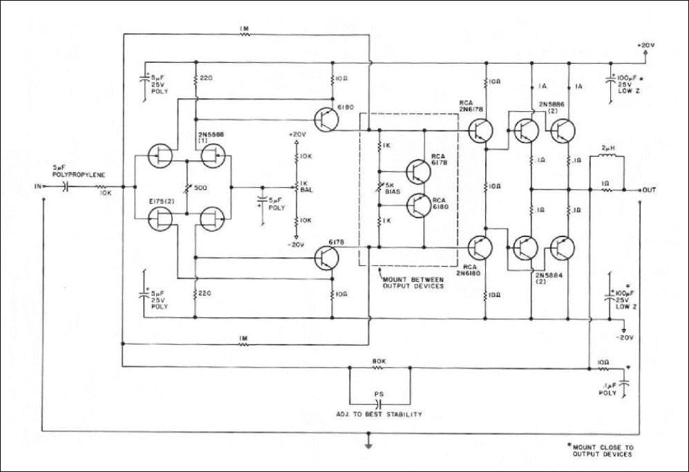

I would hope that the reason that my amplifiers 'sound good' according to the reviewers is because of both what I contribute and also avoid in my designs. The original design is over 40 years old, but it would still hold up well today. That was the JC-3 (1974) It was designed before I went to servos, but it was very fast for the lowish f(t) 4MHz that I was forced to use at the time.

My view of slew rates is they show that most modern amplifers are mostly current amplifiers except when a TIS ( trans-impedance stage or VAS ). When this is made optimum the byproduct is a high slew rate. This can even be coupled with simplicity. Rarely is as most off the shelf op amps need to suit many needs. For example where current flow to external circuits is critical.
As far as I can see op amp design would be greatly simplified if a MOS FET output stage is added. Whilst they add significant problems of their own they do not ask much of the driver that can be just a simple TIS/VAS. This is where descrete op amps are interesting as they offer big sized parts solutions.
One falacy of MOS FET problems is the Cgs at perhaps as much as 1n5 will require very high driving current. It won't as it is mostly bootstrapped to the load. The Cgd will be important as it is anchored to the voltage rail ( usually far lower capacitance ). Sadly I don't think an ideal MOS FET exists for this if wanting class AB use. IRF530/9530 might be OK if 20 mA class A. At +/- 45 V rails. I suspect a simple double LTP would be OK as the op amp and >3 mA VAS could work. If wanting to be very fancy a JFET input LTP. BF720/721 ( BD139/140 BC639/640 ) for LTP 2. BC337/327-40 as input? Some think a JFET square law is an advantage. I suspect it is merely that the transconductance is less and forces the correct design choices. I have tried Darlington and Cfbp TIS. On paper it's a great choice. Perhaps it is. It sounded like something was lost by doing it. The Cfbp ( Sziklai ) worked very well when using the usual Cdom, not a hint of instablility. The idea being to have more LTP 1 tail current choices.

John, 20us slew rates or ~50ns small signal rise times are absolutely fine for phono. The cartridge cantilever can't track those transients but, that's besides the point.
I can understand some customers wanting discrete circuits. To use an auto analogy 'Some like Porches, others prefer a Morgan'. The customer is always right and a good marketer will fill those needs honestly and for the right price. But, to claim opamps are 2nd rate . . . I don't think so.
Quick Experiment: Feed a 10 kHz square wave via an inverse RIAA network into an opamp RIAA (or a discrete one). The signal out of the IRN is a series of very fast rise time spikes that then quick decay exponentially to 0V. A 20V/us opamp reproduces the square wave perfectly.
