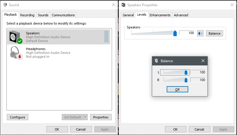

For playback equipment that has a balance control, it would be fine experiment with adjustment of it to see what sounds best in terms of stereo balance or just to focus on a single channel.
I will post a jpg to show how that can be done in Windows if using Windows Media Player or similar, and if not using a recording program such as Audacity that may already have channel balance capability, or which may even be able to split the stereo file into to separate mono files that can then be listened to in both speakers at once.
For Windows, go to control panel, sound, highlight the playback device and select properties, go to the second tab that says level, then click on balance.

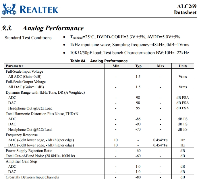

It was the inbuilt sound card of a Dell Vostro 3750 .
It looks like Dell says it uses a Realtek ALC272/ALC269 HD/ALC269Q-GR driver: Support for Vostro 3750 | Dell US
Some Realtek specs for ALC269 are here:
Realtek
Realtek says 98 db S/N A-weighted, among other things. However, it appears that data sheets are only available under some non-disclosure agreement.
For any readers not familiar with it, A-weighting is described here: https://en.wikipedia.org/wiki/A-weighting
I'm just wondering if you might have heard things a little differently using a different DAC and headphone amp. You described trying some different earbuds and headphones, with some difference there.
For one factor of possible interest, the 24-bit file was recorded with very low noise mic and electronics and could exceed the dynamic range of the Realtek part, if the noise floor is considered a limit.
