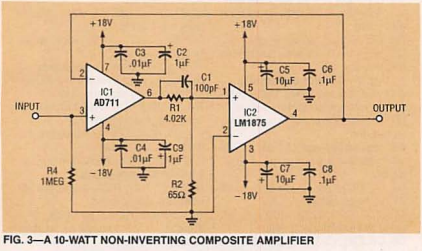

Opamp performance can vary according to nonlinearities and loading modes of the input signal and further the current capability of the DUT opamp output stage to drive the combinations of output and feedback network loadings.
Scott's circuit illustrated above elegantly sidesteps these issues/dependencies.
This configuration gives the ability to position swap similar opamps and presumably highlight any subjective differences.....or roll DUT's into either circuit position or both.
So building stereo stages into suitable sized diecast enclosures (peek and tamper proofable) with mirrored circuit positions ought to be a tighter test of actual opamp differences and substantially reduce loading effects.
My two bob.

That's a composite amplifier circuit and isn't going to be stable just rolling random op-amps in. I mean... come on. Probably does sound different if you build an oscillator.
