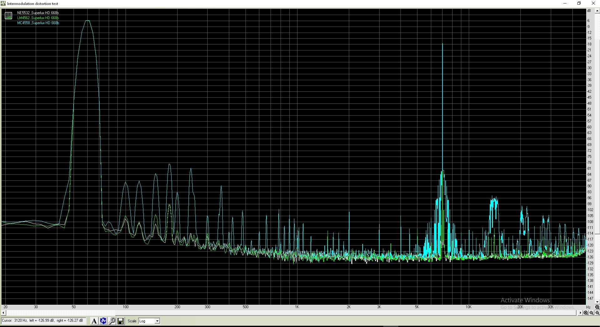

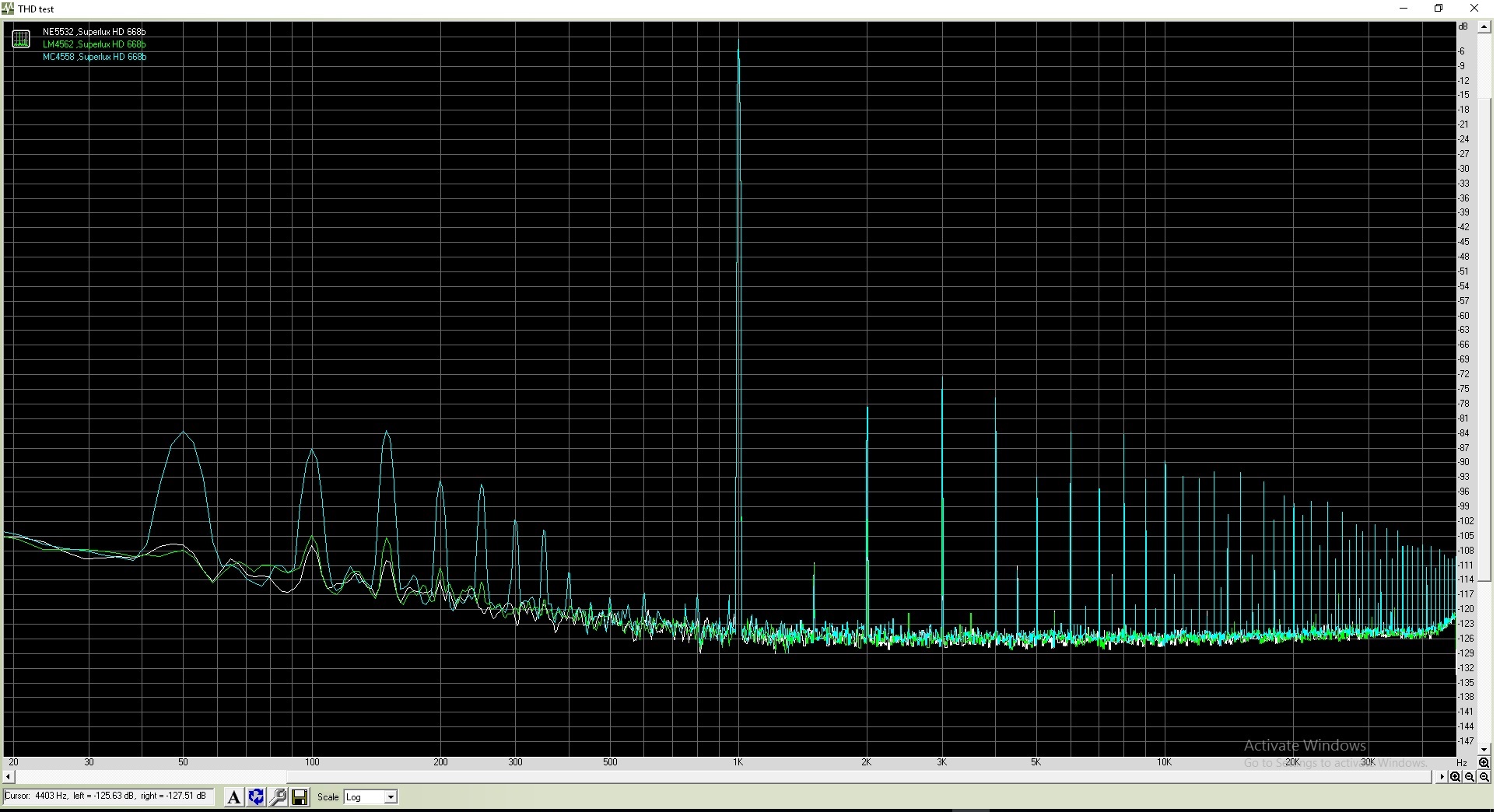

long time using opamp for driving headphone amplifier ,and as i have few different kind of opamps on hand it cost me nothing to test them.
tested(into 56R headphones,separated by cushin) 3 different and one that was distorting most(and lowest slew rate) sounded best to me.
my point, we should ditch any kind of listening tests as our hearing is not instrument, and "sound" is no more than our brain playing games.
edit: was using creative sound blaster xfi at 24/96 and rightmark aa for testing
