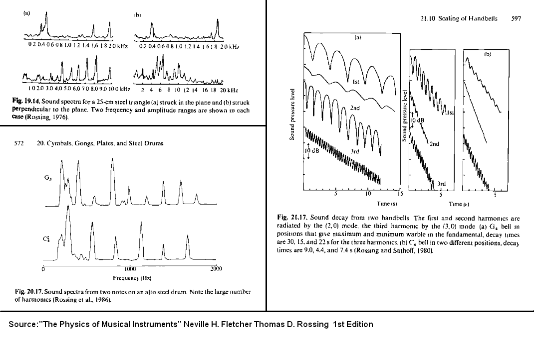

They don't entertain the implications of extremely large n, it has no use to them. Someone versed in all physics modeling might be able to add some insight but constrained metal rods of substantial physical size oscillating at 100's of MHz is a stretch, but you knew that.
The benchmark was 100kHz. And the amplitudes are probably decreasing asymptotically. Anyway if you find anything better please feel free to share. As I already stated I am as much in the dark with this one as everyone else here who is not a mechanical engineer.
Mark - just found this about the modal frequencies of a tuning fork. There's nothing to suggest that there's an upper limit, at least not until we hit some quantum mechanics principle.
http://www.acs.psu.edu/drussell/Publications/Rossing-Russell-Fork.pdf
Yes, well, that shows what can happen when idealized mathematical models break down in systems more complex than the assumptions of the model. Without any attempt to be complete (or completely accurate!), damping of vibration modes due to friction in the metal would probably attenuate higher order modes pretty fast. Maybe faster than one cycle. Also, the tuning fork would probably have to be excited with a forcing function with high enough frequency components in to let the tuning fork ring at some really high frequency mode. High velocity rifle round might an interesting experiment. Then again, some modes would require a propagation velocity faster than the speed of sound in the metal (consider the time allowed for one cycle and some need for mechanical displacement during that time, with sufficent displacement needed to bump along the next adjacent molecule in the time period), and eventually, faster than the speed of light (maybe), and so on. In other words, the mathematical model is for an idealized tuning fork, not a real one.
For a small tuning fork, 100kHz might be within reason. Here again, probably not ever going to make it to someones power amplifier without a lot of special effort. Obviously, besides tuning forks, quartz crystals can mechanically resonate at many MHz, but we wouldn't feed it into our power amp.

I will disagree. The impulse of even a high speed rifle round is nowhere near the infinite speed of a mathematical simplified model of it. And in reality, there is no perfect square wave, only an imaginary mathematical concept in Gabor's head. A useful concept, but one to be used with an understanding of what it is.
The fork will absolutely stop working at some practical frequency limit. Again, the model you found assumes the tuning fork is made out of a solid piece of lossless elastic material. It is not in fact solid, it is made of atoms, and as a metal may have some crystalline structure, but in no case as tightly packed as quartz. It is also not in fact lossless, it has friction. If you keep bending it, it will heat up. Therefore you have found a model that doesn't work for all the cases you are interested in. Don't feel bad though, lots of scientists and engineers have had similar mishaps. Look at the variables in the equation they offer, Youngs modulus is for elasticity, they also include density. I don't see any variables to account for friction, or speed of sound in the material. By the way, friction in a mechanical vibrator is as resistance is to an LC tuned circuit. It damps the oscillation and reduces Q.
Beyond that, the model assumes the traverse vibration mode can stably exist at very short wavelengths compared to the other dimensions of the tuning fork, such as the width of the tines. They do mention it gets more complicated around the bend in the tuning fork, but they leave it at that. They also, I presume, assume that a mechanical engineer will be familiar with the limitations of the model.

I am not an expert on these matters, but I would expect that the simple model breaks down when the wavelength of oscillation (along the tine) approaches the thickness of the tine (across the tine). Apart from this, I would assume that the metal becomes acoustically lossy at higher frequencies. To get high frequency mechanical oscillation in objects of 'normal' size you need very stiff very low loss materials such as quartz.scott wurcer said:They don't entertain the implications of extremely large n, it has no use to them. Someone versed in all physics modeling might be able to add some insight but constrained metal rods of substantial physical size oscillating at 100's of MHz is a stretch, but you knew that.
As they were writing for physicists they probably thought they didn't need to say this. They might be surprised to hear that the fact they did not specify a limit on n is taken by someone as proof that n is unlimited. When you write something sensible it is virtually impossible to plug all the potential holes through which someone somewhere will attempt to extract nonsense from it; you have to assume sensible readers.
