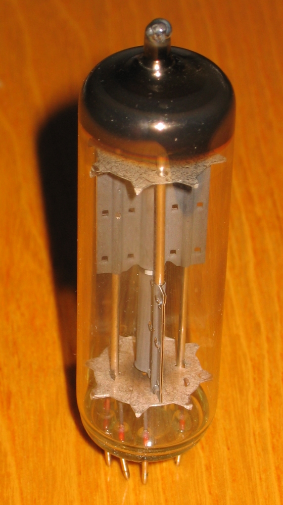

Can anyone identify tube in photo ? It is a noval (9-pin) tube, about the same height as EL84, there appear to be few pins unconnected which would indicate a double (FM detector ?) diode. The print has been completely wiped off and the etching doesn't look like anything familiar either. I believe it came from an old radio, although I can't be 100% sure of that. I've never seen a double diode arrangement with anodes perpendicular to one another, sharing same heating element in the center 😕
(photo is 335 KB in size, not dialup friendly)
Wow guys, it never occured to me that those small anodes could take that much current so my assumption was some oddball detector diode, but based on your replies I went searching for photos and came across this one which looks precisely like what I've got here.
This is the kind of EZ81 I was used to seeing, it looks completely different.
