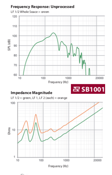

For a 4th order BP, the roll off on each side of the passband is closer to 12dB/octave.A 4th order bandpass sub uses a rear sealed chamber and a front vented chamber, it rolls off at around 24dB per octave both above and below it's bandpass.
A 6th order BP can have a 24dB/octave roll off on the low side and 12dB/octave on the high side, but I've designed a few that have roll offs closer to 18db/octave on either side of the passband.
