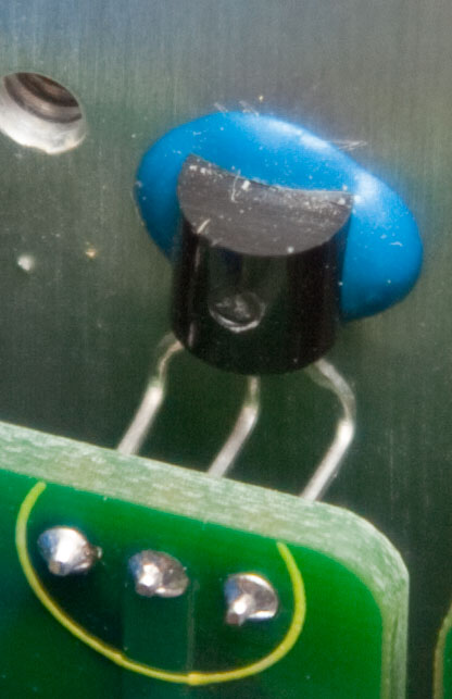

Hey Guys,
As part of my education in electronics, I recently bought a used amp to take apart and see how it ticks (I've tried reading books but without something to dig through with a DMM, the knowledge wasn't sticking).
Anyways, in the attached picture, there is some kind of solid blue thermal compound holding an IC to a heatsink. By solid, I mean really hard; hard enough to resist scoring by my thumbnail and it's properly bonded to the heatsink.
Does anyone know what this stuff is (brand name too?) and how to safely remove it from the IC?
Dave.
Note: Due to the limited gamut of sRGB, the blue has come out a little wierd; the actually blue colour is actually a little lighter than pictured. I also realize that a question like "what is this blue stuff" is probably a shot in the dark but google hasn't given me any real contenders so....

Thanks guys. I was assuming that it was thermal compound because it's mounted to the heatsink and was thinking along the lines of it being a temp sensor as well. Would regular epoxy glue really be a sufficient heat transfer medium for this kind of application?
If so, I'll go through a few brands to see if I can find one whose color matches.
@OS - re: acetone, thanks! 🙂
Note: I noticed some scoring on the heatsink just under the 'epoxy', presumably to help it hold so I think you're right, it's probably just epoxy. I'm just worried about the specific properties of it.
I want to be able to remount this thing when i'm done fiddling with the PCB so I want to make sure that I don't cook it (or change the sound) by putting the wrong stuff on there. 🙂
