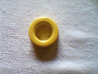

i have a core like the one i am attching the image of.
powdered iron torriod with outer dia 3.3cm and inner dia 2.3 cm.
can it be used as output filter?

As DNA alredy said (At least I think) please use cores with an Air gap. You can take any core you like. The only important thing is that there is this gap! It makes the core linear, so you will get a good sound quality.

The component values that u think need to be alatered or be replaced alltogether by other suitable values....please list them🙂 It will also be of gr8 help if u can post the BOM of the amp + the pics of the amp.One more thing,i will use this amp for subwoofer,so will the quality loss be of significance to a sub if i use the core that i have?
