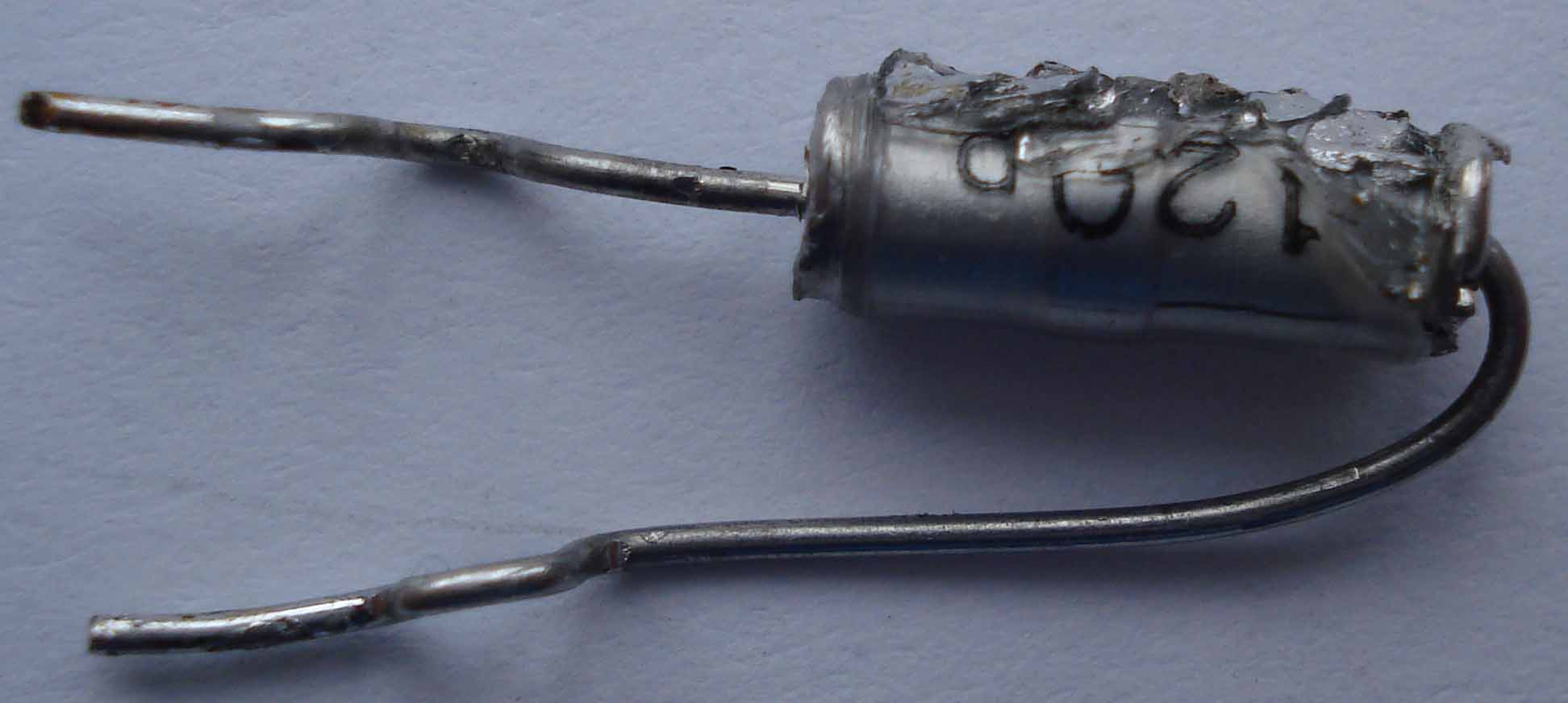

DEAD - VERY DEAD.
L.O.L.
It looks like a 120pF/630V Polypropylene but can you give us an idea of its size.
More to the point - HOW has a 630V cap got into that state ?
Polyprops are usually pretty reliable unless they are overheated.
L.O.L.

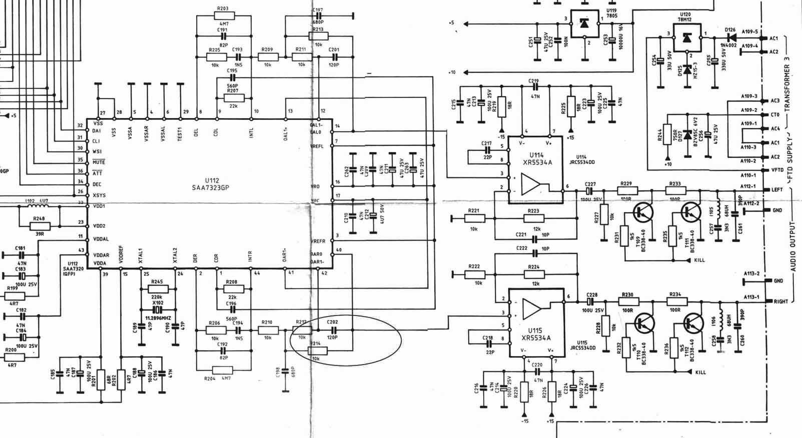

Might be worth waiting to see if anyone has the schematics to confirm the value.
There isn't a C202
http://bwgroup-support.com/rotelservicemanuals.html
Purely from its voltage rating I would guess that its C001 - across the mains switch. I am guessing though.
It is a Philips polystyrene capacitor of 120pF/1% 630V.Please could you help identify this type of capacitor. I Just it out of a Rotel RCD-965BX position C202. Numbers on it are 120P, F630, CN KS.
Tom
I agree with ELVEE - my mistake polystyrene not polypropylene.
If you can ascertain where it is in the circuit we can offer a suggestion for a replacement.

I guess this would do as a replacement
FSCEX 120PF 1% 630V - LCR COMPONENTS - CAPACITOR, 120PF, 630V | Farnell United Kingdom
How the hell did it get into that state.
You can use any 1% Polystyrene cap of 120pF in that position as long as the voltage rating is above the Vcc of the IC. I'd go for 63V just to be safe.
http://uk.farnell.com/lcr-components/fscex-120pf-1-630v/capacitor-120pf-630v/dp/9520678
Here's one as an example.

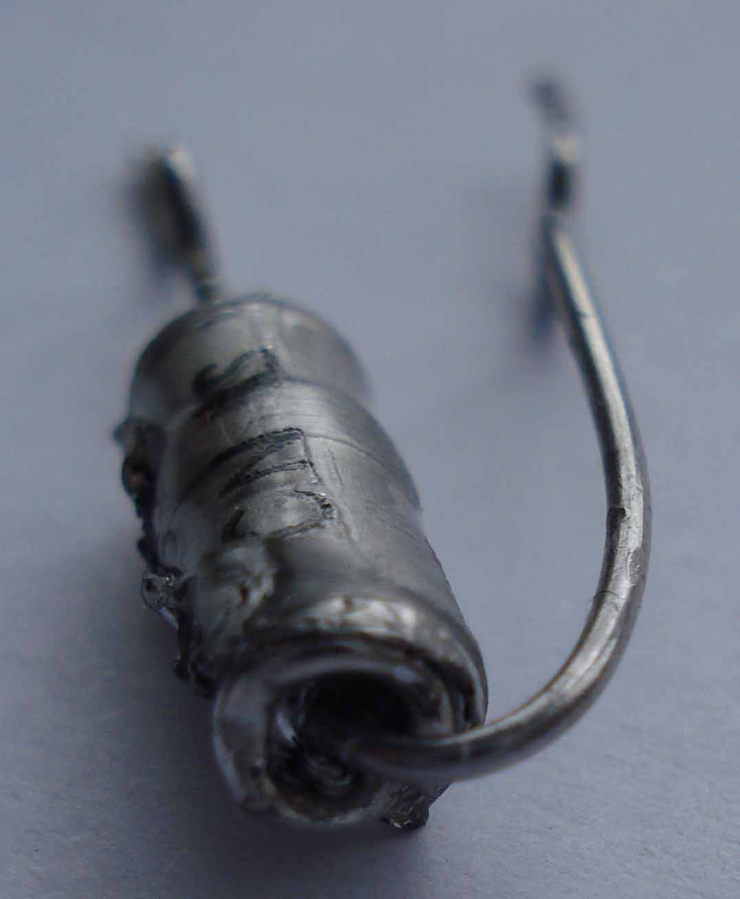

Looks like it's been burned by having a soldering iron to close.
Ebay purchase maybe ?
Easy enough bit to get but nothing on E-Bay this afternoon.
I've never known one to fail though. OK this one is cooked, but they normally fail very early in their life.
I meant the Rotel actually, sorry if it wasn't clear. There's no way a cap could fail in that location and it does just look like external burn marks tbh.
I wonder why he suspected it in the first place ?
I'm out of my league here but if the IC is suspect - I would start with the Xtal.
