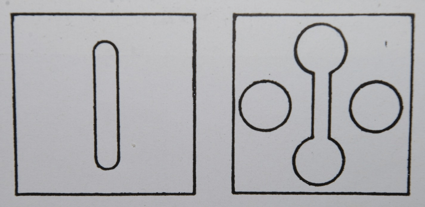

Slot diffusers were once used to 'spread' the upper frequencies of single cone 8", 10" or 12" drivers, hence increasing treble dispersion and avoiding 'beaming'. The introduction of dedicated tweeters rendered the use of slot diffusers unnecessary.
In his book 'Loudspeakers', G.A. Briggs gives details of slot diffusers. The modified diffuser shown on the right of the image below avoids restriction of output at lower frequencies.

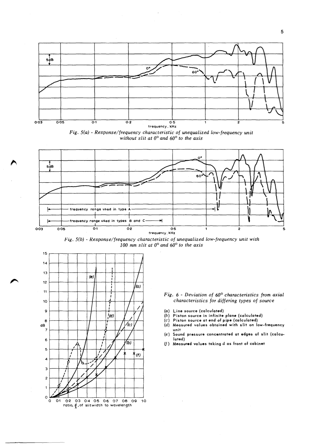

https://web.archive.org/web/20130201144500/http://www.tgpwebzine.com/?page_id=424

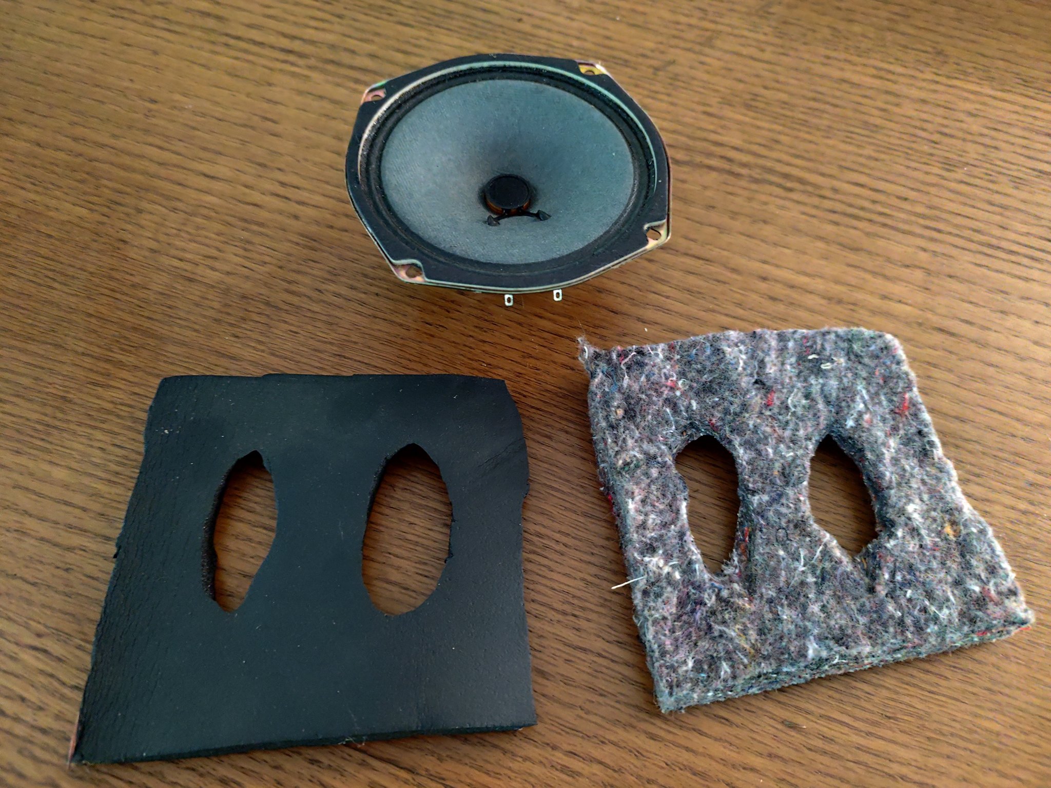

I really like the idea of the open cell foam donuts. In my case I will try it with two oval cutouts per driver....
With a solid plate with slits ala JBL you need fairly high EBP. My drivers are low excursion with small alnico motors. The foam could be a brilliant solution and also less prone to diffraction than a solid plate.

I did a quick and dirty test with some stuff I had at hand. I didn't have acoustic foam so I tried it with automotive felt. That didn't do much but muffle the sound. Then I tried some rubbery closed cell foam and to my surprise that seems to work really well.
My laptop died so I cannot measure at the moment. But I listened to it with white noise while changing listening angles and it does seem way more even. It doesn't reduce the highs off axis but does on axis. It also seems to extend the bass a little.....maybe mild slot loading.....?
I will need to wait until I get a new laptop before I can verify that it also reduces comb filtering in a line array.

Some historical information:

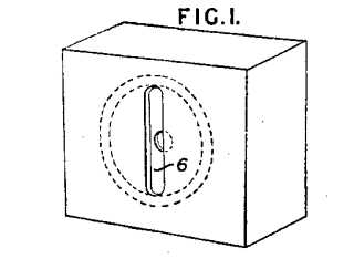

The Kolster Brandes patent for slot loading dates back to 1947.
659,063. Loudspeaker baffles. KOLSTER BRANDES, Ltd. Sept. 10, 1947, No. 24849. To improve high frequency response and diffusion, the aperture (6) in a loud-speaker baffle is reduced to a slot having a width no more than half the length.

Gilbert Briggs' experiments showed the diffuser to be effective between 2 kHz to 6 kHz.
He said that the length of the aperture should be the same as the piston diameter of the cone, the width being less than the smallest wavelength involved. Hence a 4" wide slot would be good for 3 kHz.
By altering the shape of the slot and adding extra holes, obstruction at low frequencies can be overcome.
